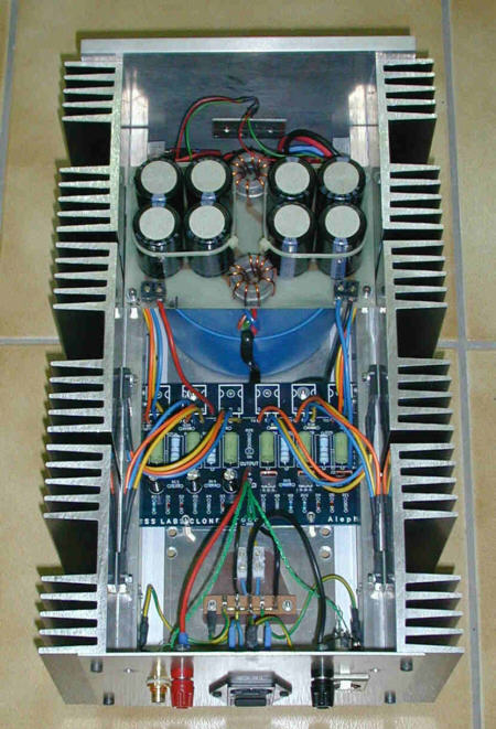

another Aleph5 (Upgrade from ZEN)
thanks rod,
i do vaguely remember that thread. so if i understand correctly, increasing R19 will result in a subjectively better sound into 4 ohm loads? will this increase the heat dissipation as well? i'm a little light on the heatsinks now, by ~5-7 degrees C. i wouldn't mind playing around with the resistor, but not at the cost of increasing the heat. ohhhh the heat!!!! it is the bane of all good amps
cheers,
scott
whoops,
read the thread again, and R19 is actually 385 ohms, so it is lowered, which i guess increases bias, which i guess would indeed increase the heat diss.
i really like the current sound of my amp, but i haven't the equip to really tell what kind of power it is delivering to my 4 ohm speakers. oh, well, i can't complain, i'll just listen some more.
love this forum!!!
scott

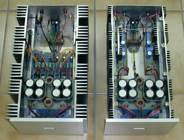

follow-up info : I completed the second unit and changed the mounting of the FETs. They are no longer mounted directly to the heatsinks but to the bar that connects the heatsinks for better temperature coupling. Overall temp is 45C (after two hours) measured at the bar between two FETs. More pictures and some additional info can be found in the PassDIY gallery.
