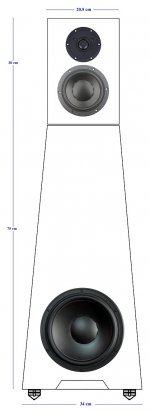

anyway just started with 3way bass reflex with drivers used : Dynaudio 24W100, MW152 and Satori TW29RN
I wanted full Dyn drivers, already got MD100 but compared to Satori it's different class. so back to Satori, my candidate someday maybe MD130 but can't find it yet
mid + tw will be passive xo which i hope can get simple xo without too much parts used.
while woofer + mid will use minidsp 2x4HD
woofer will be in bass reflex around 40L volume, while mid will have 4L.

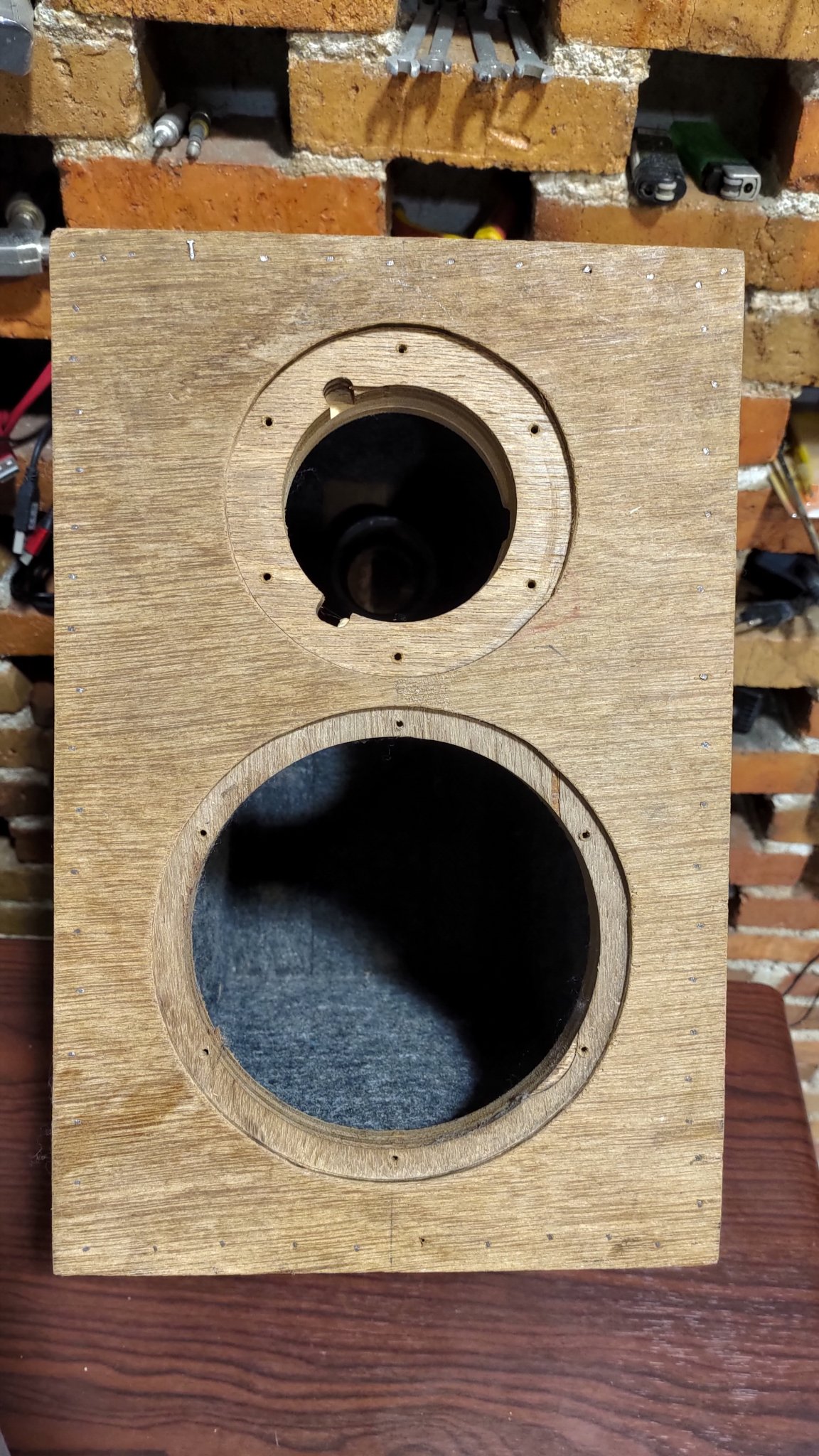

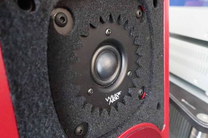

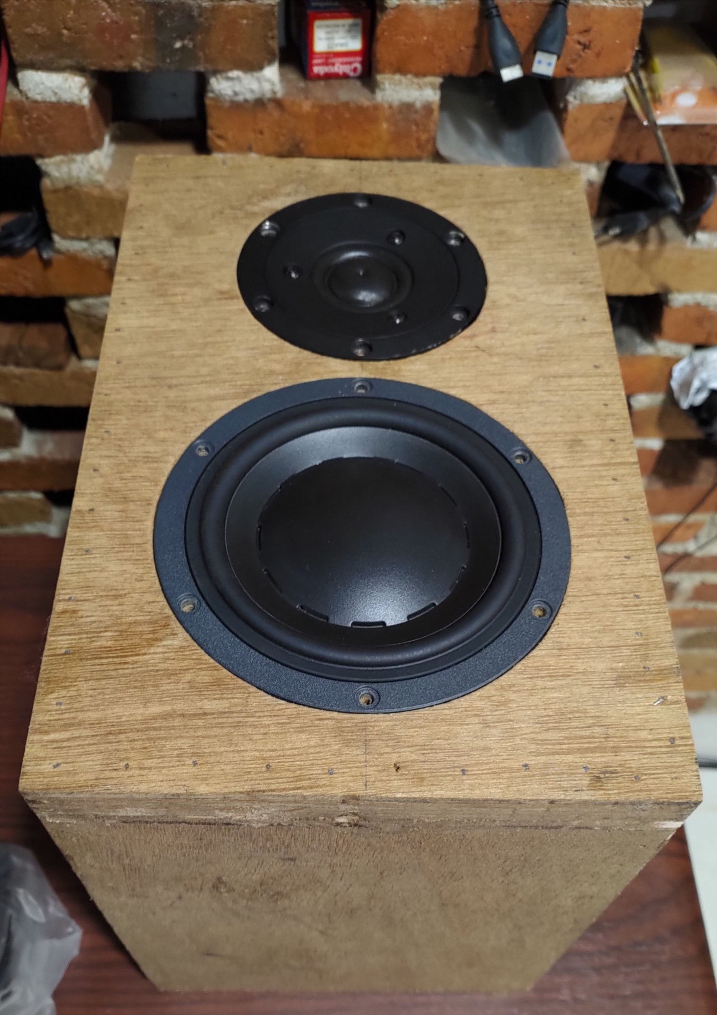

1st try no chamfer edge yet, i will try to use minidsp to get good response between midrange and tweeter then will make passive xo.Did you consider chamfered baffle edges?
45° or round edges is an option that i will try later, another one is using felt with star pattern for tweeter
1 top box is almost finished, just waiting for finishing which I have not decided yet. another box should be worked anytime soon

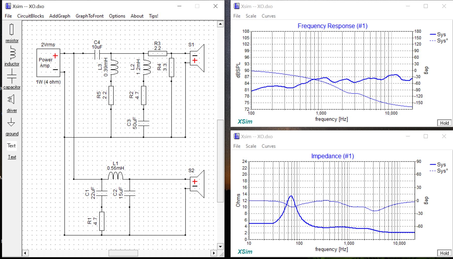

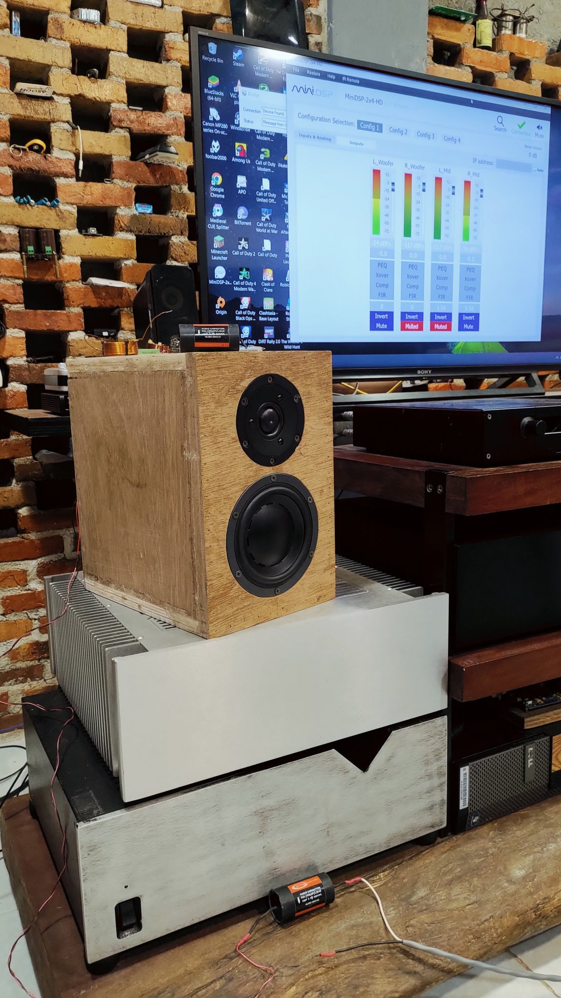

meanwhile i use ftpgraphtracer to get frd and zma for MW152 and TW29RN and play with xsim. this can be as my starting point because most of the parts available in my drawer.
hpf for midrange will be done by minidsp 2x4hd, i will try with and without hpf to see this small driver capability.
thanks for eagle eyes, i will correct it on my testing boardR1/C1 should be after the low pass coil.
i have not included bsc yet, will check it later if needed or not
no matter how hard i try this passive xo, it seems that it's not my destiny. i could not get it sounded right, then get back to my minidsp 2x4HD and no need to think hard about RLC value anymore.
using Harsch XO 2.4kHz and FW J2 clone for MW152 and TW29RN, this is really a good combination. even though J2 maybe only 15W @4ohm but with volume pot around 12.00 it's already loud.

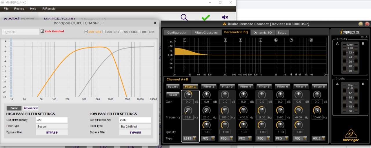

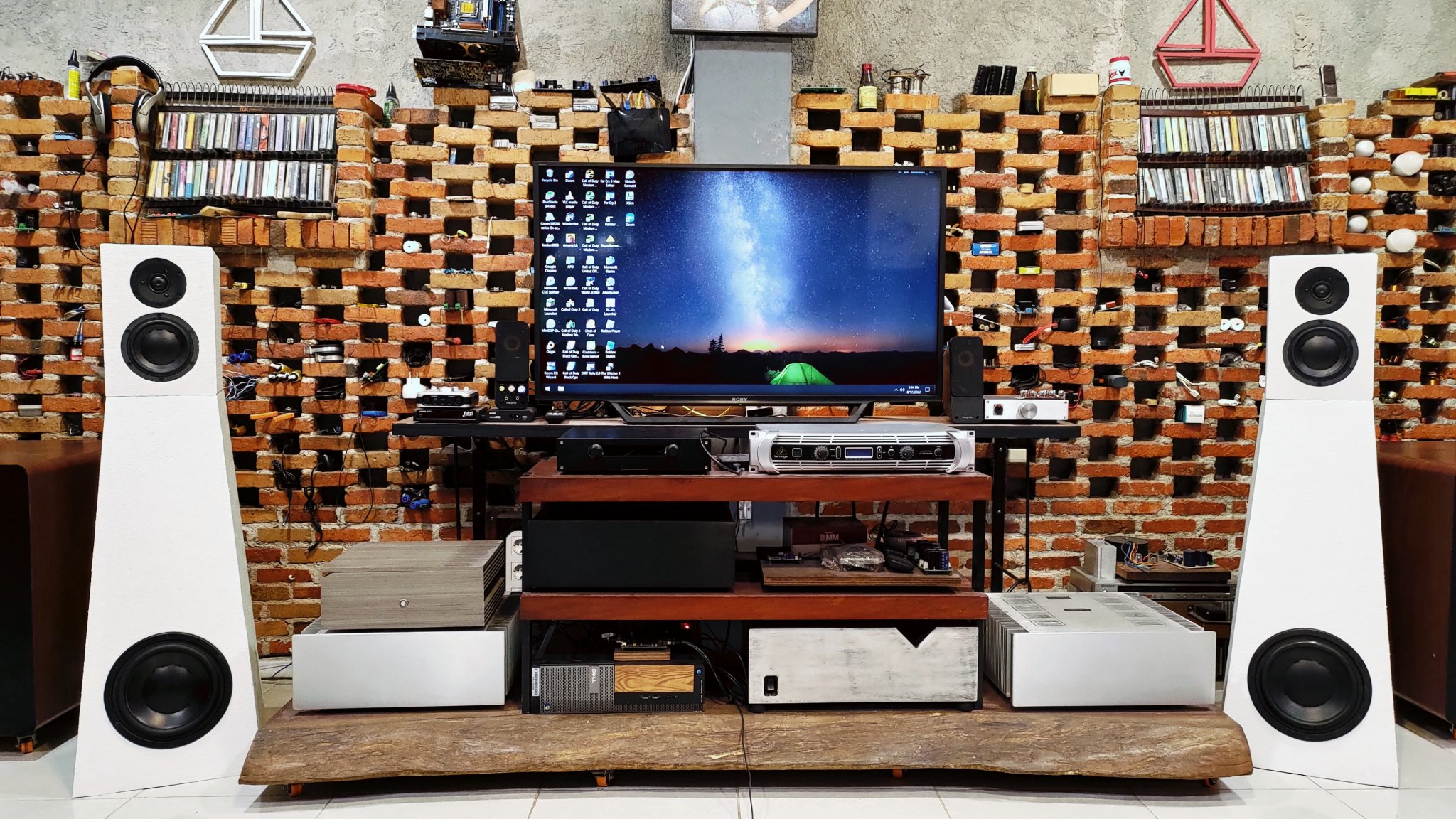

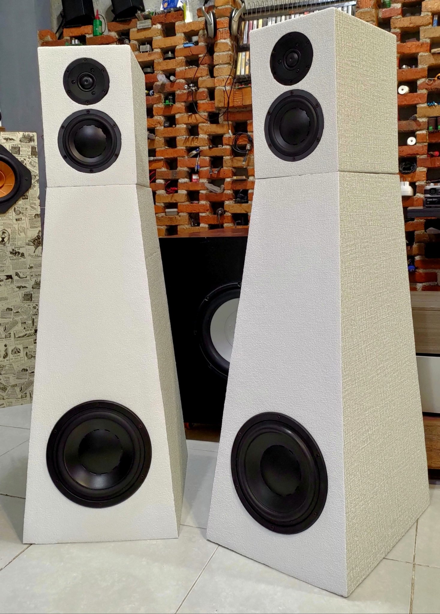

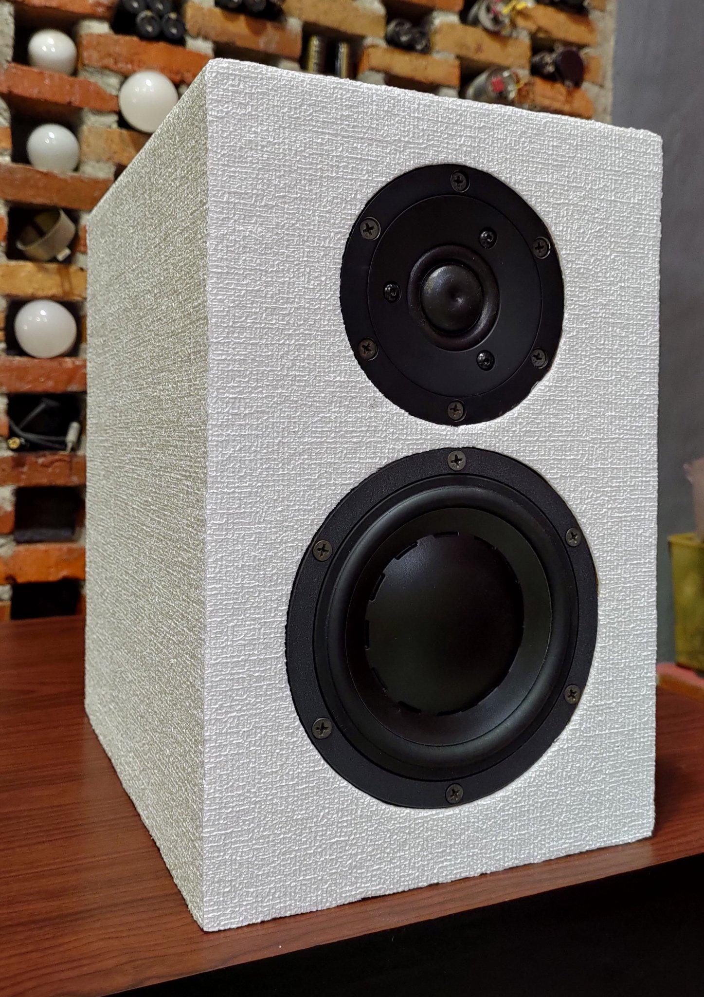

finally completed this project, changed the woofer to MW180 and keep 24W100 for another project
48L ported for MW180 and 10L ported for MW152, using minidsp 2x4HD for mid - tw and LR 24dB xo for woofer.
it's time for tuning

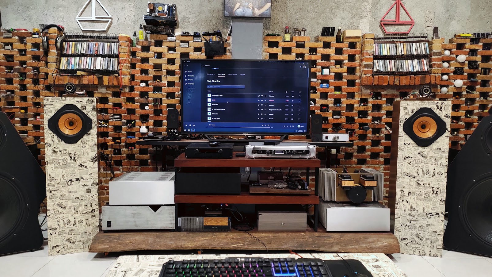

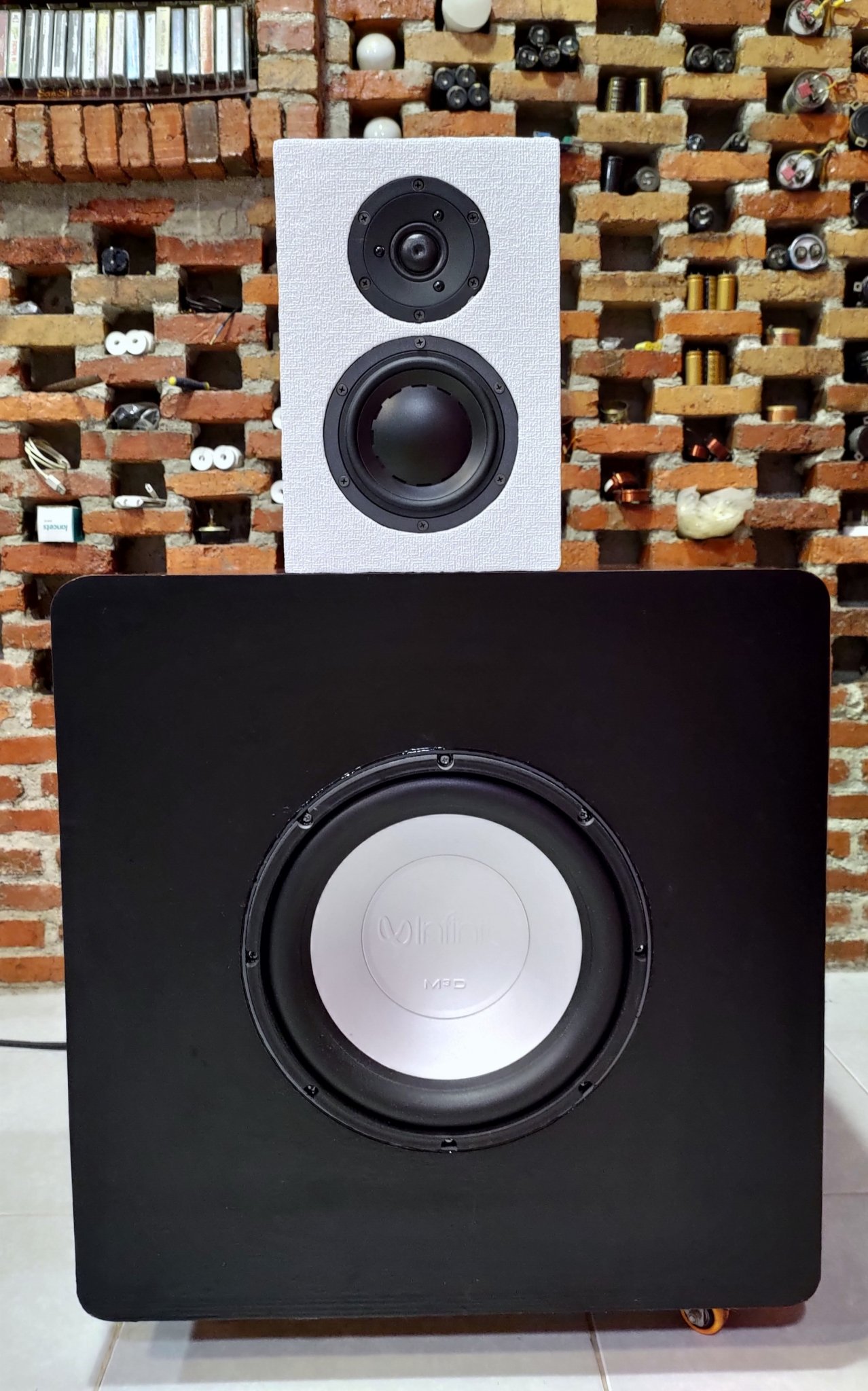

finally connected all cables and started playing with XO setup, combination of minidsp 2x4HD & behringer nu3000dsp.
mauro penasa for satori tweeter, J2 clone for MW152 and behringer for MW180
i'm still relying on Harsch xo and overall sounds very good
