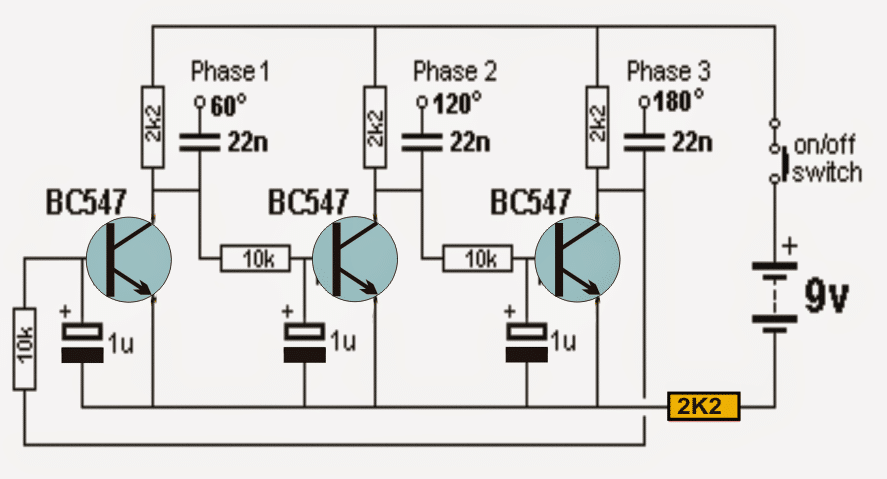

There is well established industry as well as controllers along with the math and related software. All one needs is DSP/RISC chip feeding phase values into DAC-s and linear amps instead of PWM sections of such chip. Most even works with standard tacho-s. Since the phase shift in motor is constant, it could be as simple as a set of counters and sine table ROM with DAC. VCO|/PLL for speed control, analog or otherwise to one's liking. Something like that will usually suffice, with few tweaks
https://www.homemade-circuits.com/wp-content/uploads/2014/12/3phasegeneartorUsingTransistors.png
