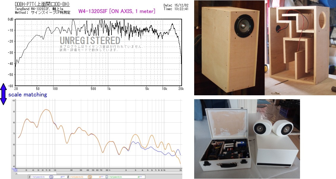

I've recently build 2 closed cabinets for my Tang Band W4-1320 bamboo (neodymium version), effectively about 2 liter per driver.
Cabinets are on the right:
There are large peaks at 3, 6, 9, 12, 15 and 18 kHz in all my measurements in the range of 10 to 15 dB. I've measured inside the house on different locations and heights, with different amounts of stuffing and outside, yet the peaks persist.
Does anyone know what the cause of this anomaly might be?
With and without EQ:
I forgot the peak at 18 kHz, its mostly gone as well.
Hmm, resonant peak cascade [eigenmodes] = odd order harmonics = open or cone pipe resonances, so the fundamental = ~34400/2/3000 = ~5.7333 cm/2.257" based on HR's 344 m/s: Resonances of open air columns
Find the offending parallel surfaces, then you can tell us where it's 'ringing like a ten penny nail struck with a ball peen hammer'. 😉.

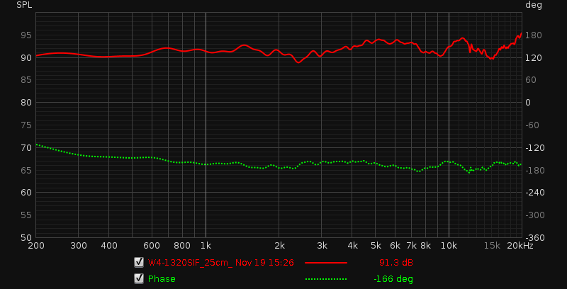

Here's my own W4-1320SIF - ferrite magnet - in DCR enclosures, the baffle is 15.75" x 8.5". Mic 25cm on-axis, speaker roughly 48" high, 5ms gate.
What is your measurement setup, mic (calibration?) placement, speaker placement, interface? Just to make sure, you are measuring only one speaker at a time?
My measurement setup is a desktop PC with an internal mounted M-audio Audiophile 2496 sound card as output (stereo RCA). I'm using an UMIK-1 USB measurement microphone (https://www.minidsp.com/products/acoustic-measurement/umik-1) with a calibration file, measurements are in REW.
