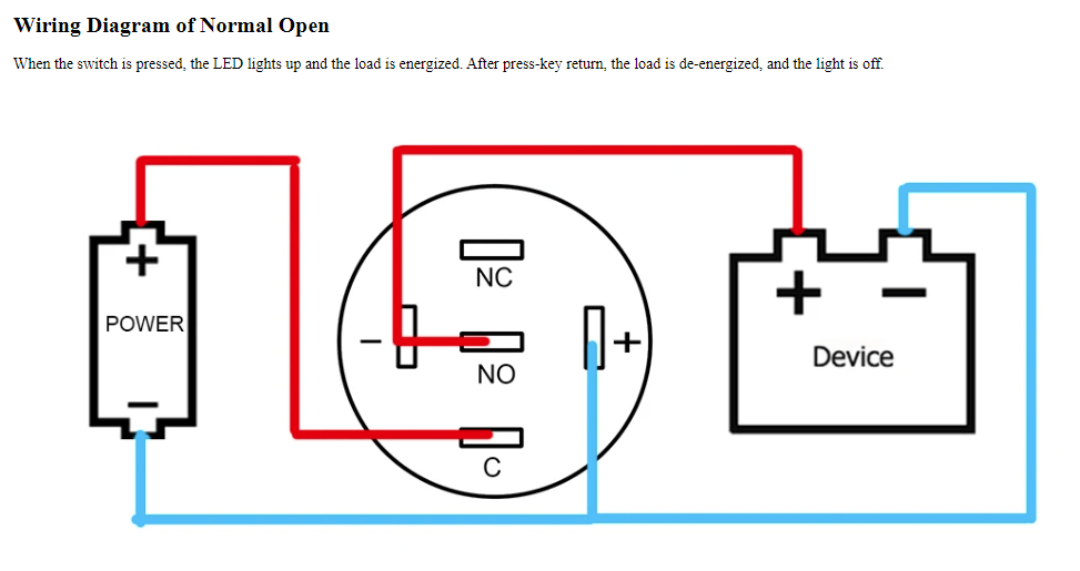

There are 6 pins and I don't know how to connect them in order for the LED to be switched on , when is powered and off when its not. Till now the LED remains on all the time.
I use the push button as a power button and I want to know when my system is on/off based on the LED. I am trying to connect directly the AC cables to the LED and then to the transformer.

@ulogon Thanks a lot for your reply ! I think that the LED is for up to 250V ( aluminium Black & Light Circle Red 1NO1NC 250V 5A Ø19mm ) so I think that is fine. The problem is with the pins . Do you have any schematic for the six pins configuration ? Please have a look at the figure that I uploaded as well if you have time.

Can you please read on the body of your switch what voltage value is there?
From the picture you posted it looks like it's 12V.
However, assuming it is 220V I still believe that the switch is not suitable for the purpose just because the notes you posted say switch and the LED are "relatively" independent.
Anyway, if you have a tester or a battery you can check what happens on the + or - pins when you press and/or release the button.
Then if confirmed it should be easy.

No. The switch is rated 250v.I think that the LED is for up to 250V
It says "12v diode". That is the LED, the only diode.

I don't understand the problem, because the drawing provides the pin configuration and numbering? If you are unsure about how it works, test with a continuity tester or use a 9V battery, an LED and a 1k resistor?
The drawing shows the LED terminals as screws whereas the image shows them as solder lugs. There could be other differences. The description says that the switch is a monostable. I take this to mean that it's a momentary contact type. Don't know if this is correct or if it's what the OP wants.

However, IF your switch is exactly the one in the drawing you attached, the wiring is easy:
break a wire from mains and attach one of the two ends (better the one with the phase, if any) to pin 3 and the other to pin 4.
That will only serve to turn on or off anything that comes after the socket you have in the wall.
The LED on and off most likely is not linked to the button.
But in the switch I linked to you earlier it is. 😉
You have already attached the LED and it will not turn off just because your switch is not designed to do so.
I guess it's designed to turn on an LED that's plugged into some circuit where it will turn on or off, but it's not controlled by your switch button.
Disclaimer: I take no responsibility for what you will do since you haven't provided enough information to consider them valid and I simply used the drawing you provided and we don't know if it's accurate.
