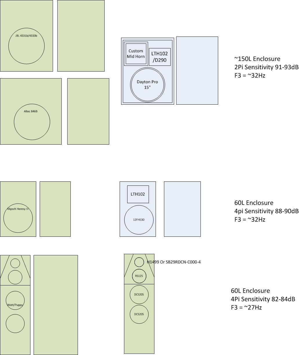

So I’m asking for input, what would you like to see? What area of speakers are there that are underserved for the DIY’er. I’ve got a couple of ideas…
Idea Number 1: An update on the grand monitor speakers of the late 70’s and early 80’s. Usually a JBL but occasionally an Altec. This style is seeing a bit of a resurgence due to the tireless work of Kenrick Sound out of Japan. Size and output wise, think JBL 4331/4333B or Altec 846B. This one would likely have the Dayton Pro PA 15” woofer (stamped frame), custom mid horn (think Edgar Horn) midrange and LTH102/PRV D290. They would be built in mirror image pairs….and construction would be complex. The horn alone will likely require a band saw, table saw and quite a bit of patience. The midrange horn might be loaded with a Dayton PA130…but there are several possible options here.
Idea Number 2: A Klipsch Heresy sized two way…using the same LTH102/PRV D290 tweeter as above, and likely a FaitalPRO 12FH530 woofer. Same sized enclosure, but a two way design, vented, and wider bandwidth. I looked high and low for commonly available (Crites doesn’t count) speakers for a sealed enclosure…but didn’t like my options. Frankly you have to use what’s available to you and I’ve used a neo FaitalPRO woofer quite happily before. The shorting ring magnet design and high output potential are intriguing on this one.
Idea Number 3: An update on the classic monitor/subwoofer two enclosure concept…popularized by Wilson. This time without the crushing 2 ohm -50 degree phase angles and a more setup friendly polar response. The drawback again will be construction 4 enclosures….massive complex bracing. I’m curious to use either the SEAS DXT tweeter or SB Acoustics SB29 series tweeters…..so this one has some appeal there.
Other suggestions?
I’m more than willing to discuss other options. At some point I’ll have to call it though…and select one. Since it’s my labor….I get to pick. ;-)

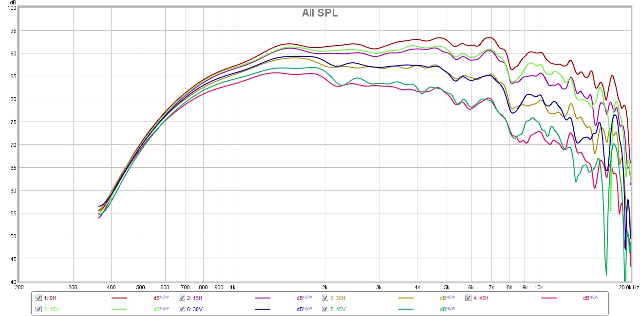

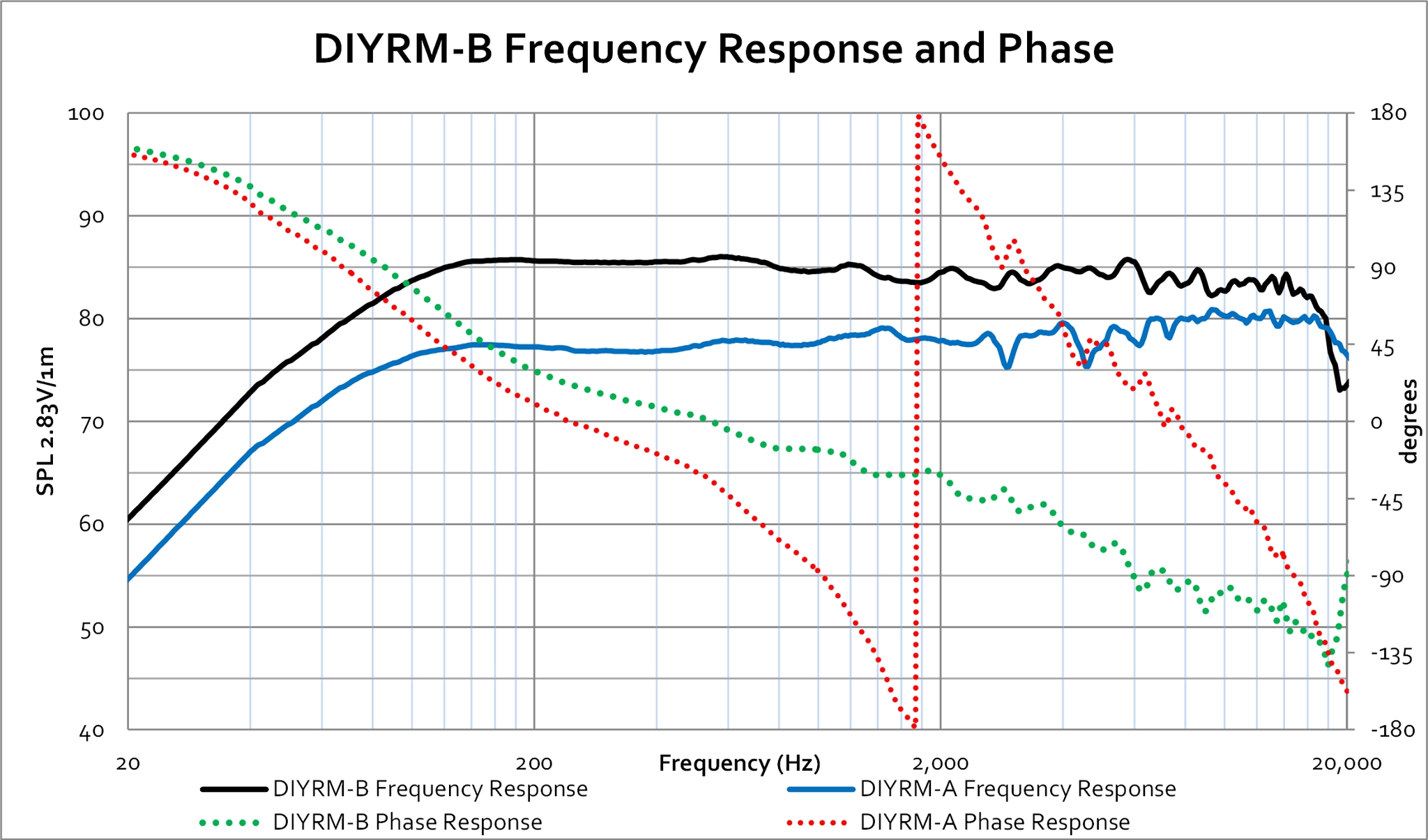

I've attached a frequency response/phase comparison for DIYRM-A and B, a quick sketch for the various ideas I have....and finally the frequency response of the LTH102/D290 pair since I already own those. (Very good performance on the tweeters/horns for those...)

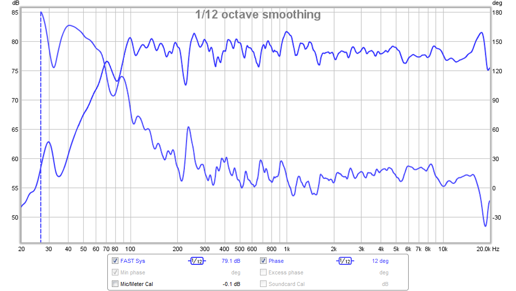

Nice work on the transient perfect B! First order XO slopes do have magic in them. I did one recently with a wide band aluminum full range for the tweeter (active XO) here:
FR58EX and AC130F1 micro-FAST / WAW - diyAudio
It does square waves too but bass is not as robust as your box. It's tough to do a passive XO to achieve this - kudos!
Here is the FR and phase:

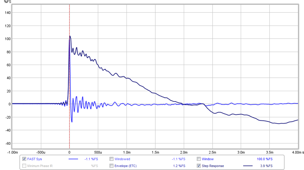

Do you have a step response of the B?
Here is what mine looks like:
