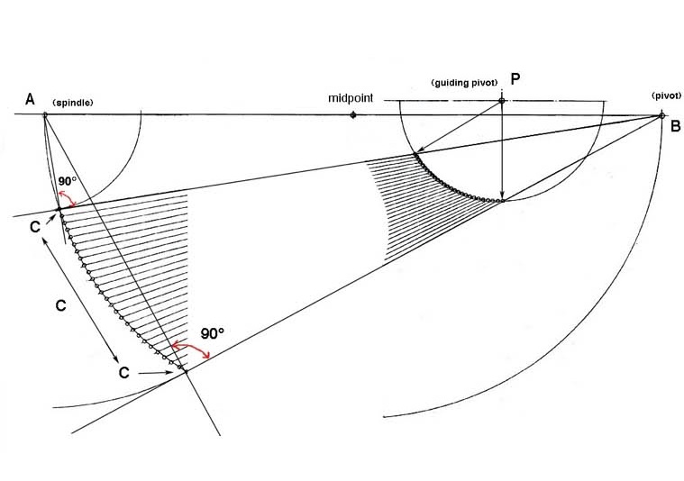

Jim and Carlo,
Check the alignment details of the ellipse and the Thales circle. They're not the same. Back about two or three hundred pages, Jonathan Carr found that, for whatever reason, the Birch design based on the Thales circle, although very nearly tangent, is only truly null at three points. Jim's results are null at all points.
Again, I think there's a possibility Carlo's design results in an ellipse, which would be a very cool bonus.

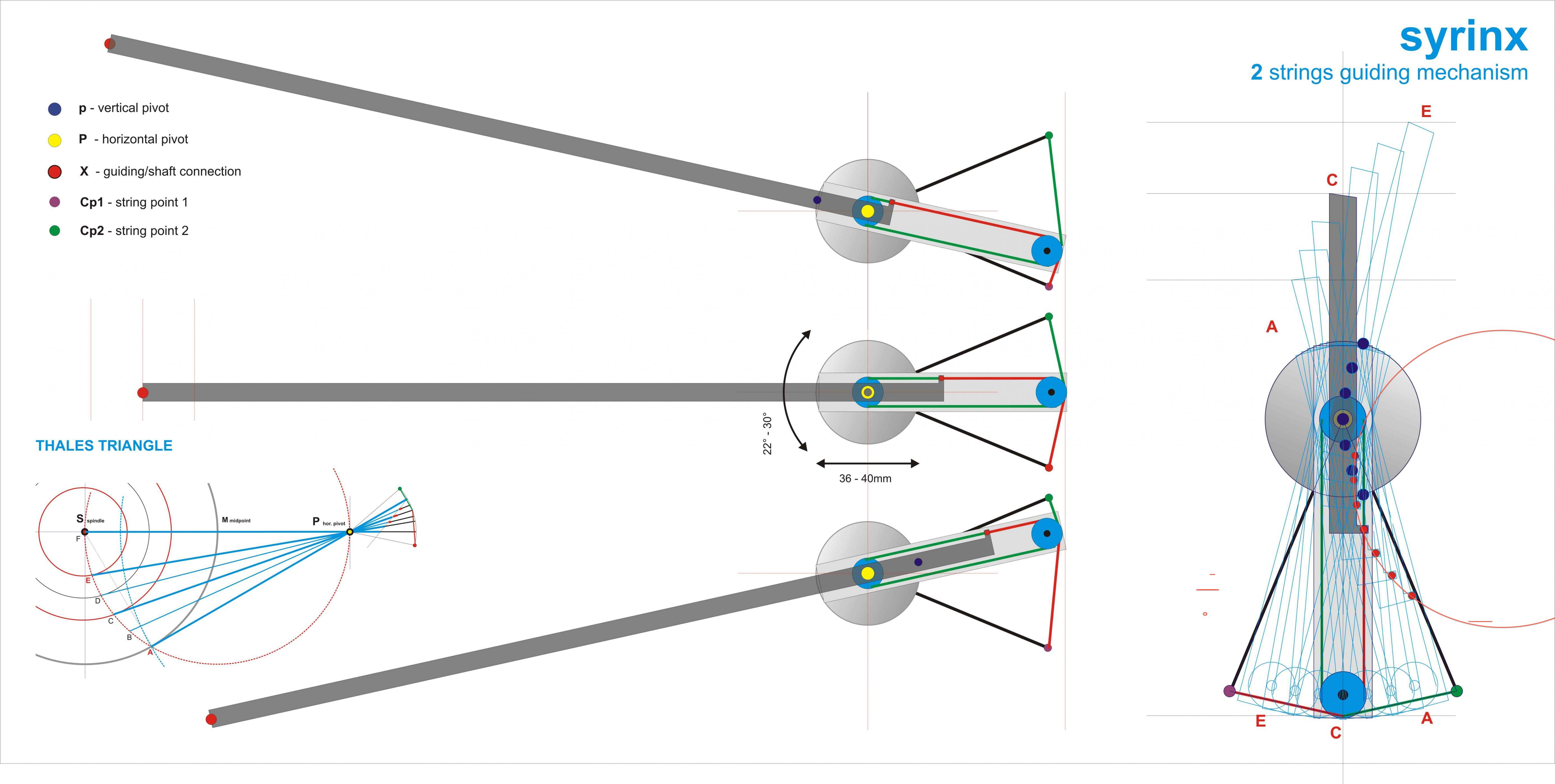

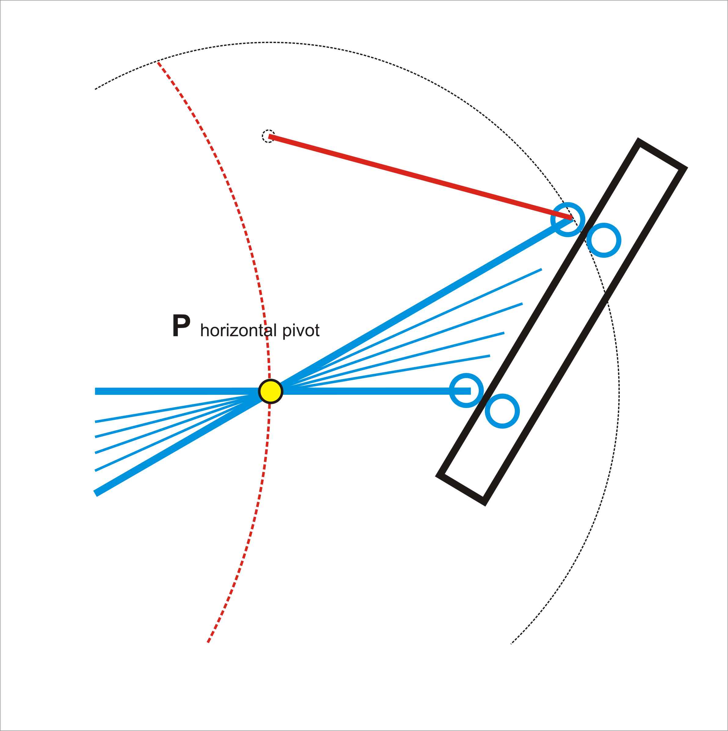

dear Direct driver
Since I do not love the strings (beautiful for instruments, less for tonearms, and for the same reason) i've previously explored many different options: gears, springs, cames, levers, wheels (left just magnetics to his master).-
What you say can be easy to build: the rail is a simple line, but is so steep! At first sight the side component of the force seems brutal.
The lever -in red- seemed more promising, but nearing to spindle the angles became problematic, multiplying friction and unwanted moments

Surely i'll be boring, but I'll tell the story of how I came to the Syrinx - may be useful.
Everyone was doing the Thales (stringed, or with polygon) using the radius instead of the catheter: useful from a constructive point of view and for selling, but geometrically a nonsense. So I tried to use the catheter (reinventing the wheel).
Of course the catheter has to be stretched, that can be done converting angular motion into linear stretching, eg with two gears. Elliptical like in Birch?
After I made a graph with my old compass and paper (I understand better this way), and marked on the back the various elongations of the catheter. Surprise, the function of the angular movement of the catheter was a line (wow! in italian * °° !**** !, unrepeatable) so elongation could be achieved without gears or cames, using a simple string,
But where are the underhang errors coming from? Because the string is a chord and not an arc, and a chord is always shorter than the arc. But for small angles the difference is small. At the beginning the gadget was designed for a rotation from outer groove to the spindle (40 mm elongation 30 °) and error was > 5mm, then lowering it to the reading area (36 mm - 20 °) it was reduced to <3. We can still improve by choosing proper nullpoints, as old Baerwald did, maybe to a +-1 mm.
All here: for no error it's needed a curved string that could follow the arc ..... who sells?**

Most of the guiding mechanisms you presented are BEHIND the pivot point, whose movement curve can be dramatic but what if the curved track is placed in FRONT of the pivot point as seen in Rex' graphic which is a variant of the Birch geometry. The Birch curve is closer to an arc instead of ellipse so it's easier to track on the rail. That's what I had in mind after abandoning the string approach.
My thinking is to minimise friction, using the stylus drag to pull the arm 'downhill' as it were.

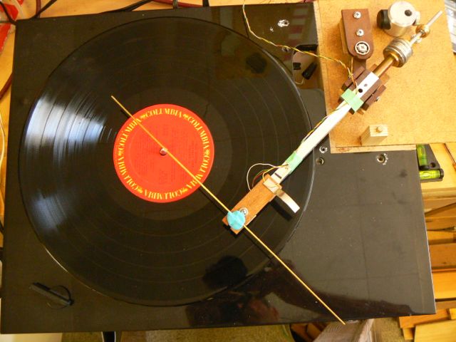

Parallel LTs can have large masses, 60 gr or more, but the groove can move them just fine so the side force on the stylus must be significant.

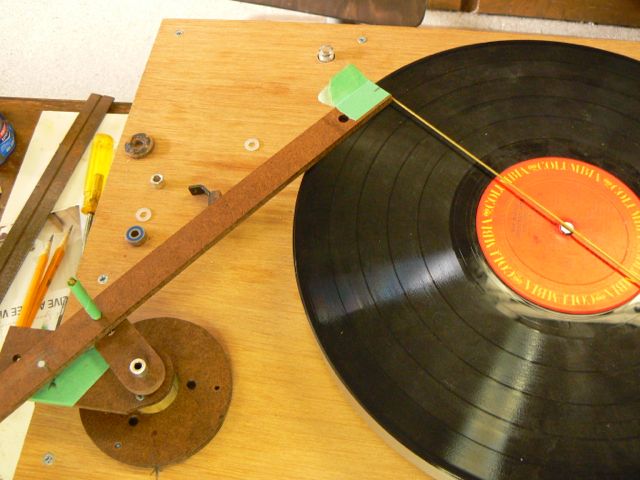

In the third photo, I've placed a circle over the red dots in your drawing. They don't quite fit. I think the red dots trace an ellipse. The circle you placed over Jim's ellipse doesn't quite fit. The circle/ellipse disagreement is a constant part of PLT design. There is something about the combination of circle arc around P and the fixed point B in the Birch geometry that creates very small intangencies across the LP - orders of magnitude less than an equivalent length pivoting arm, but still there. The secondary arm may not be the precise equivalent of the Thales radius and the difference shows as the stylus moves across the record.
The pointer on the Birch arm - fourth photo - would not center over the spindle. Lots of English words like your Italian words. In the second photo I removed B, placed the pointer over the spindle center and traced a point behind the secondary arm. The magic ellipse appeared and has appeared all over the place since then. It's the symbol of tangent.
I think somehow when you and your compass discovered the line and you designed your indirect gadget, you designed an arm that is more tangent than the Birch.

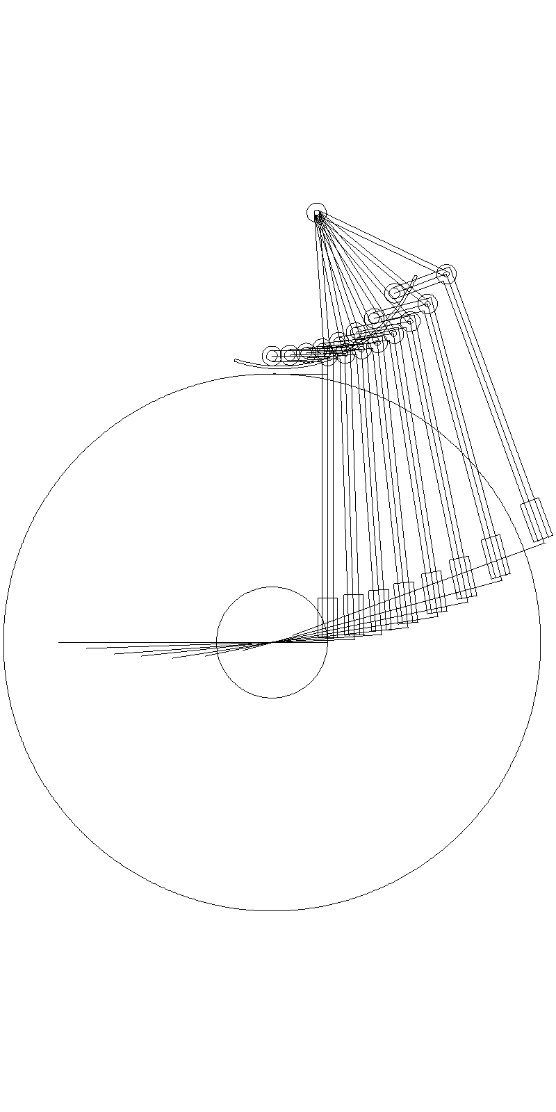

Rex,
If I understand your drawing correctly, try putting a magnet at the end of the stub arm, under or over, then put a ferris guide, either circle or ellipse, under or over the magnet, as appropriate, and see what happens. You'll have to account for some torsion at the main pivot from the magnet.
Rex,
Hmm, yes. Using a magnetic guide, which can be any curve i want, can ensure exact tangency. As drawn, this guide is so close to circular as to not be worth using. I might as well use another pivot point, as drawn by Carlo.

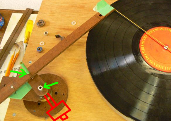

Hello Doug.
Kindly see attached picture that you have posted in #1394
Can unipivots be used in two places shown by green arrow. The moving pivot of arc piece can have counterweight to balance the cartridge holding arm. So We have extremely less friction, absolutely tight tolerance and when minor warp occurs the whole tonearm (The one with cartridge) moves vertically.
Regards.
Regards.

Since I do not have a mechanical cad (and I would not know how to use it) but just my old graphic program, I have to make certain checks just like on paper: with my eyes. So I often trace circles not to say that the points are above, but just to see how much they are away - Sorry if this has led off path.
So I did for the Jim chart - he and Dd talked about Thales and I wanted to see the differences. The only thing I have noted is that Jim had done a wonderful job thinking that test and in relation to working conditions. Results are remarkable.
So I did for mine. I'm led to believe that that curve is a cycloid (rotation + translation, like a wheel rolling on a surface). I've already asked 2wice about this.
However I'm just a diyer** and I think that Syrinx has worse problems than that: but I want to try it the best I can, and if it will turn smoothly and play acceptably I'll be happy the same. I'm not a skate taliban (just a bit for azimuth)
