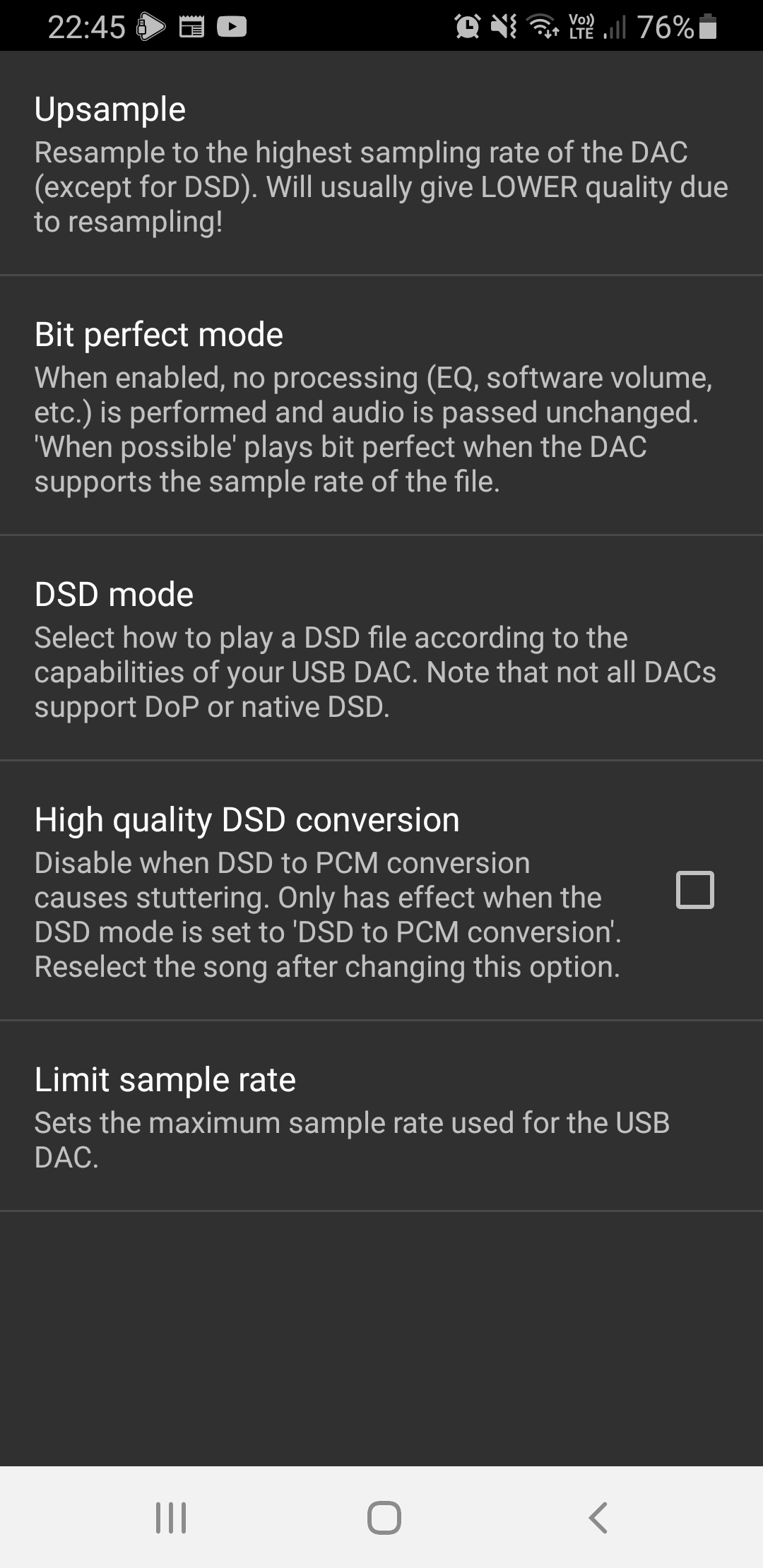

My first attempt at i2s from USB has resulted in silencio.
I am using my Samsung S9 >USB cable> DIYINHK xmos> AK4118 receiver> AD1862.
When I plugged the phone in it popped up a message acknowledging the Xmos board.....encouraging.
Selected USB input on the 4118 board but it isn't seeing a signal. Tried playing Spotify and via USB Audio player Pro. The info in the Audio player window whilst a song is playing indicates USB DAC 44khz.
Anything I'm missing ?

What settings have you configured for USB Audio-Player-Pro for an output device ?? Post the device setting page.

Within USB player. This is the USB audio tab.
Upsample is off
Bit perfect is on
DSD is PCM conversion
Sample rate limit is not set.
Can't find anything particularly pertaining to 'devices'

A little update. I took the 4118 out of the system and I have music!
Using my Samsung S9.
However I can only get music through USB Audio player . Nothing from Spotify or Radio Paradise apps.
How can I get music to play via other applications than USB Audio Pro?
