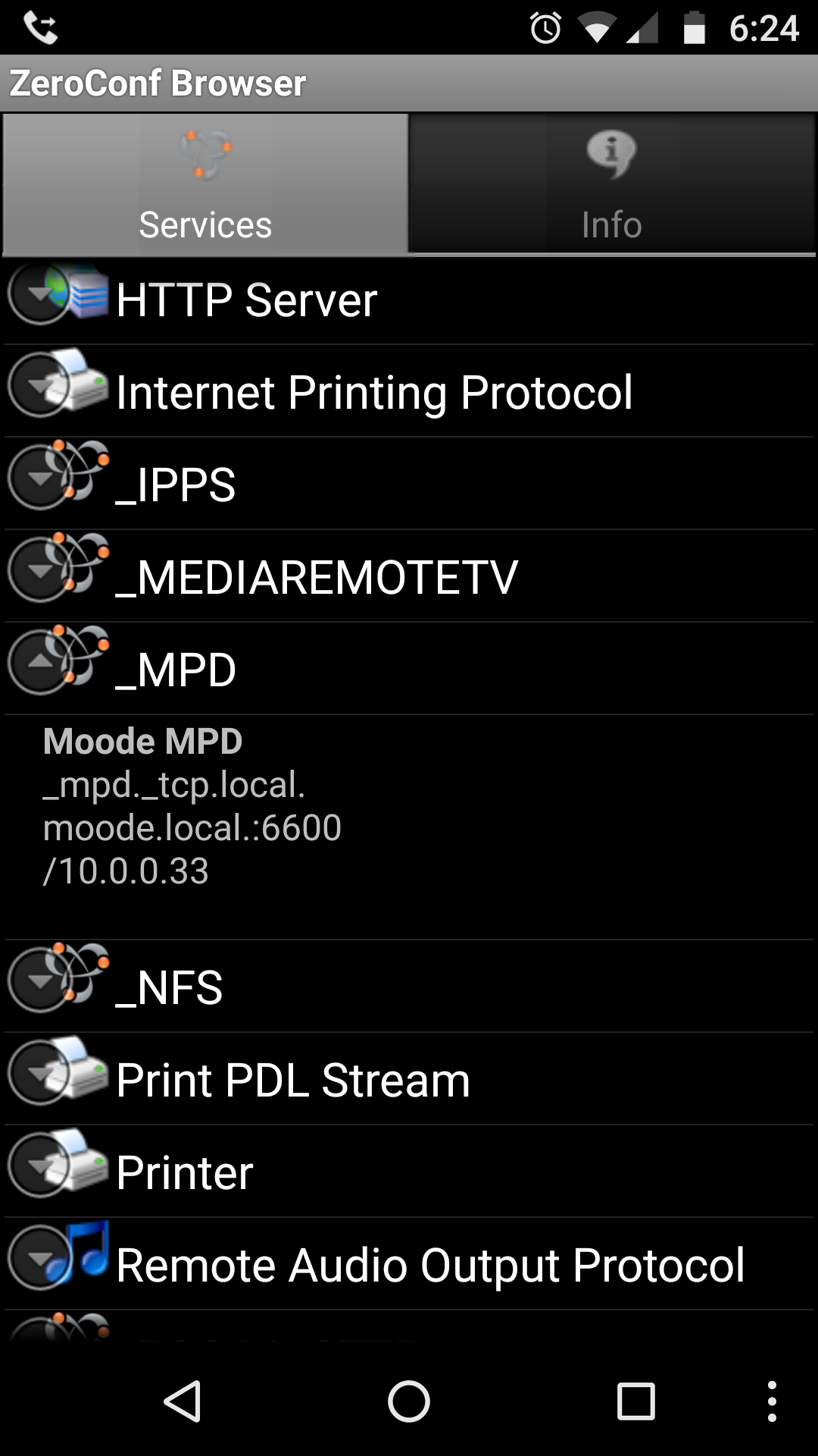

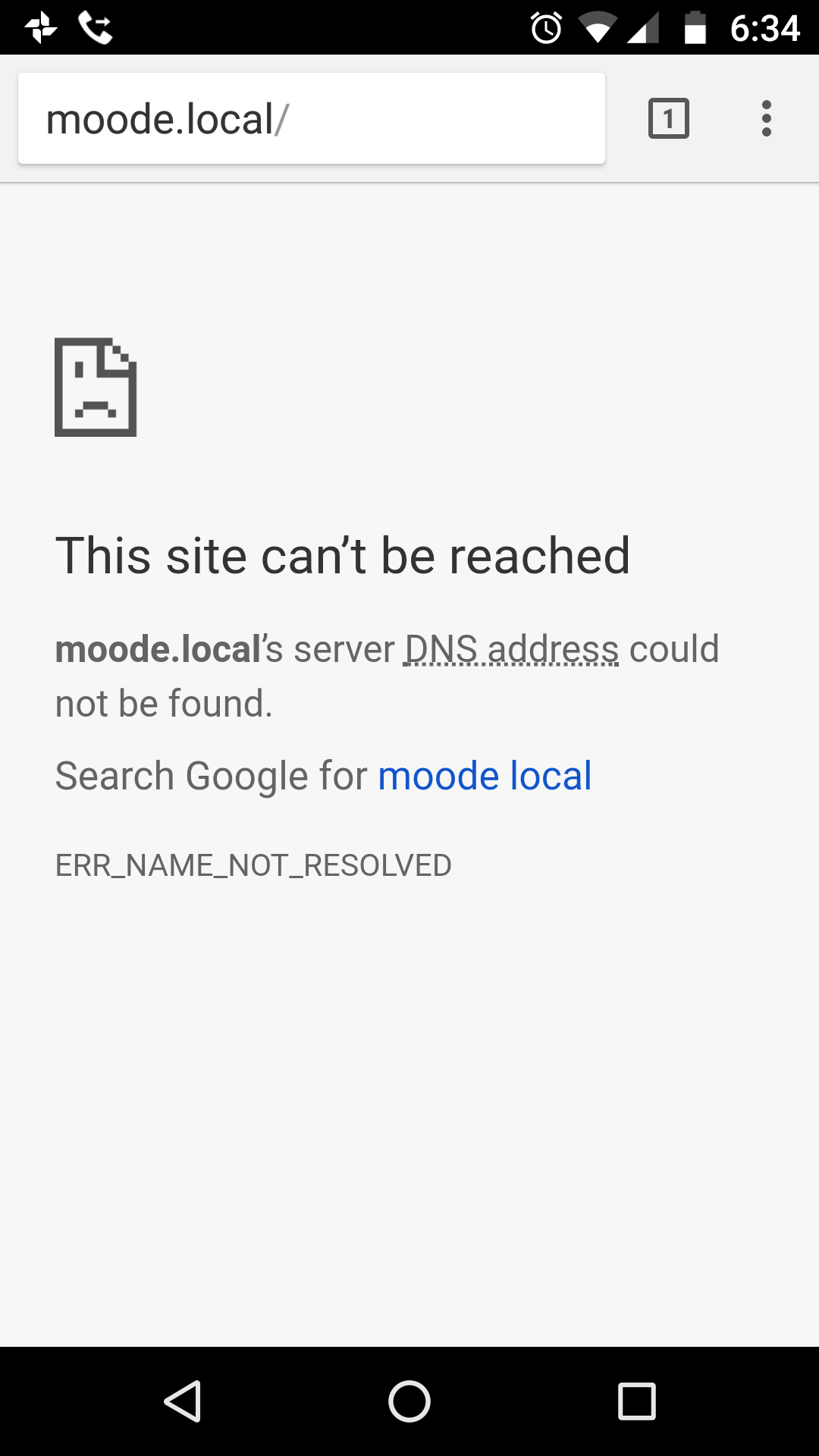

I am running android 7.0 on MotoG5. Downloaded zeroconf. I typed in moode.local/ in chrome browser did not work for me. See attached screenshots. I clear all the browser cache a few times but that did not change result.

I doubt that chrome will ever resolve mDNS addresses. This was to see if you could find the IP address easily.
Is the Zeroconf browser able to pass you along to a web browser, by selecting from Zeroconf?
Actually, you can resolve local addresses, but it requires hacking your router to block 8.8.8.8 and 8.8.4.4.
It’s easy enough to do, but may have unintended consequences if you run a chrome cast or other set top box.
