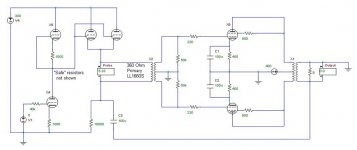

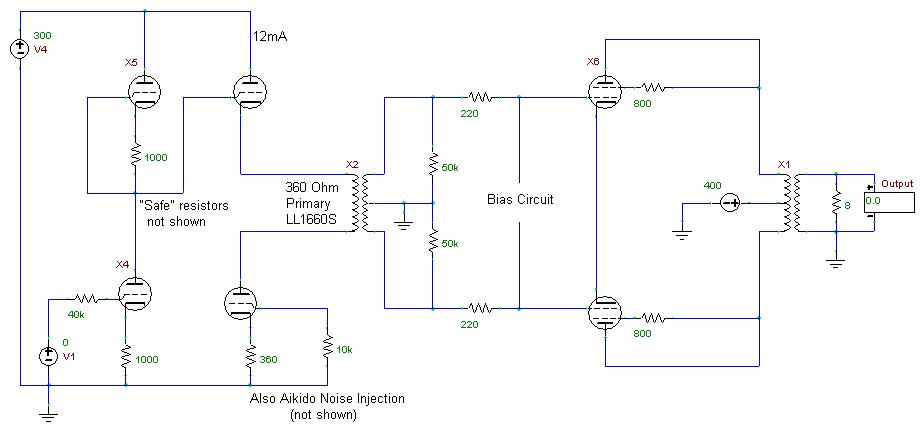

Attached is a simplified schematic of my current project, using 6CG7 valves. Not shown are Aikido noise cancellation capacitor/resistor divider, "safety" resistors in the Aikido circuit, and the grid bias for the KT88 output valves. Also not shown is ultra-linear taps for the output stage (if desired). I'll probably build this as a Class-AB1, with about 50mA idle (each) on the output valves.
The LL1660S has about 360 Ohms of primary winding resistance, which means the transformer winding also serves as the cathode bias resistor to Aikido valve V2B (upper valve).
No comments.
:xeye:
Thank you for clarifying your position on this matter.
Bypassing the entire CCS (V2A, bottom valve) with a capacitor certainly rescued a lot of gain.
Bypassing just the 360 Ohm cathode resistor of the CCS (V2A, bottom valve) with a capacitor is also helpful, but not as much.
I'll do further study to understand the tradeoffs.
The entire CCS can be replaced by a single large-value resistor (about 16300 Ohms) that mimics a CCS. Again, bypassing this resistor with a capacitor looks recommended.
Since I am using dual-triode envelopes, I may as well use an active CCS instead of a resistor.
That leaves the question of choosing the bypass point - either bypassing 150VDC from the bottom of the interstage transformer to ground, or 3VDC from the CCS cathode to ground.
Also, I noticed the interstage transformer destroys the symmetry of the Aikido noise-reduction philosophy, so the noise cancellation effect doesn't work in this arrangement.

You may parallel both triodes for a cathode follower, and use a resistor bypassed by a cap instead of the CCS.
edit: extra gain may be reduced by a resistor from output to cathode of the first bottom triode (X4)
If the amp starts oscillating reverse polarity of the output winding.

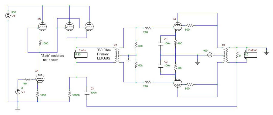

Here's what this is evolving into. See attached schematic. Maybe this form of GFB is more palatable?
I lament the fact that the Aikido noise cancellation is lost. Noise on the driver stage PSU is efficiently translated into the output stage, so some of the original beauty is lost.
[cathode bias is shown on output stage for simplicity]
Looks interesting, though it is not a GNFB, it is a local NFB around an output stage only.
What noise cancellation do you mean?
Reconfigure as a standard aikido and use parafeed style arrangement to drive the transformer. Connect one side of the transformer primary to the node between the CF cathode and the CCS plate. Place the blocking cap on the low side of the transformer primary. This will allow you to use the psu noise canceling circuitry in the aikido design.

In your situation I would be very concerned about this issue.
There are three ways of overcoming this;
Use a simple Ring of Two or LM317 CCS in the tail of each KT88. This may not be acceptable to you because it requires a cap in the signal path and you lose some voltage over the CCS.
Use a voltage divider trim pot to adjust each grid individually off your bias supply. The will require regular adjustment.
Alternatively a trim pot can be used to adjust a self bias network, but again you will need to put either a resistor or a CCS in the shared tail. No cap though but adjustment will be a regular chore.
There are some sophisticated bias servos on the Tubecad site, but not for the beginner I feel, and they eat voltage.
I know you are unhappy with your bass response and this is at least partly due to your lack of feedback. Without feedback your bass will inevitably be substandard. Think about moving your interstage transformer to the front end and driving a LTP into the KT88 grids. This will allow you to wrap a gNFB around the amp and back to the LTP. Alternatively you can easily introduce Plate to Plate feedback. Your frequency response should improve at both ends, your phase splitting should be perfect (better than the interstage by itself) and you should be able to eliminate the interstage parafeed cap. Most of the advantages of the interstage transformer are preserved. All for the price of one extra triode. I am thinking of doing the same to my 6080 PP amp, but my issues are much less serious due to the lower output impedance of the 6080's.
Another possability is to try to tune the parafeed cap to introduce a bass resonance which will artificially compensate for the bass fall off you are experiencing. I found something around 1-2uf hits the mark though this will depend on the particular brand of interstage you are using.
Think about it.
Shoog
