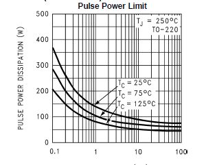

Later,I got interested in.When I plunged my head deeper in the datasheet , I found something very strange that you see on the figures bellow. You read on the top-right corner Tj= 250°C TO 220. This is the power dissipation capacity of the output transistors, as it existed first in TO220 casing. It is the only transistor I found on planet earth capable of functioning 100°C higher than normal ones. What is purpose ?
If I translate the technical curves into human language , it means if this transistor gets his head plunged in frying oil of 250°,his feet cooled upon a barbecue of 125° ,electrocuted by 70V ,it must still be singing loud and dissipate 30W (50w/8ohm output).Even a security (spike)provider is avoided .Now, where else you can imagine such extreme cruelty other than in HELL."(see "lm3886 singing at HELL°")

The datasheet is not advocating high junction temperatures, but claiming that it can survive at high junction temperature.

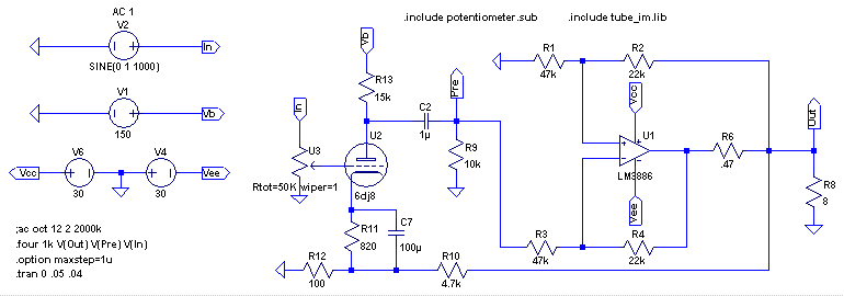

possible alternative
If you are looking for another existing similar circuit, those proposed are not valid ,but one found on Italian website ,Mauro's my ref tube version instead of op amp ,can be modified to be a democratic hybrid amplifier.
The circuit is theoretic ,as it is ,it is an oscillator. But applying lower transconductance ,reducing overall gain and providing a dominant pole ,It must work. Whereas high voltage protection and start up facilities , can be inspired form Andrea.
What kind of sound it may give I can not predict .
I don't understand the purpose of these circuits. The valve is obviously introduced to add some "tube sound" rather than being an input buffer. Therefore, don't put the valve in the fb loop, a circuit like Joe Rasmussen's "Tube Gainclone" linked above makes much more sense.

My understanding of the 250 degrees documentation is that the chip can withstand short bursts of energy that the spike is not fast enough to track and respond to. But only to an extent so national is warning the user of to wide, spikes.
Sorry, it is of course the thermal shutdown circuitry that shuts the chip down at 155 degrees. See chapter 7.
