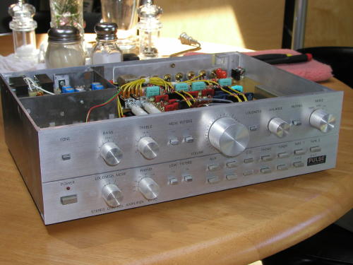

My first all out project was a preamp with all possible features. At that time it was running on 220V and was using DIN connectors. You might not believe me but only knobs and a groove across the front face were custom machined, all other openings were drilled out and filed by hand. As I remember it took me a whole day to do it.😉

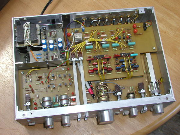

All the boards were designed and etched by me and as usually I wanted to avoid excessive wiring. The circuits are arranged in two levels, where bottom contains phono EQ and power supply and top actual preamp and elaborate filters. I think there was not a single feature I didn't put there.😉 But then, I was more influenced by Japanese makers then by Mark Levinson.

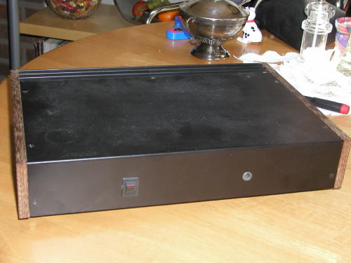

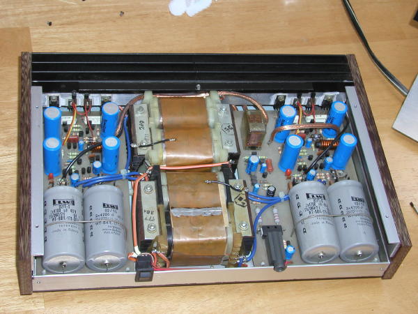

At that time I was also into mini systems (315mm width) so both preamp and amp were of that size. The amp was low distortion class B, nothing particular about it if not the small size. It delivered 50 W and I never needed more. The chassis is not done from 1/4" aluminum, but from steel I used from other equipment chassis and cut to size.

The front panel looks very nice as well. Rub on transfers for the letters?
Just as a matter of interest, why the different transformers per channel?
One transformer of twice the size is usually cheaper than two, so I'm interested in your opinion given you used two transformers here.
Also, what transformers are those?
The transformers were changed later for 110V since original used 220V. Two of them fitted better in available space, I also think that using separate transformers for ea. channel is better (you know true mono construction). Now I would use much bigger transformers thou.
Dry transfer lettering always worked good for me, and even after 20 years you don't see much wear.
