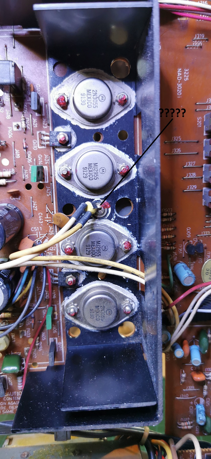

anyone know what these cables are attached to the heatsink as i cant see them on the schematic.
noise supression? just a guess realy.
also i dont think ill be leaving those transistors in there either, not heard good things about that make.

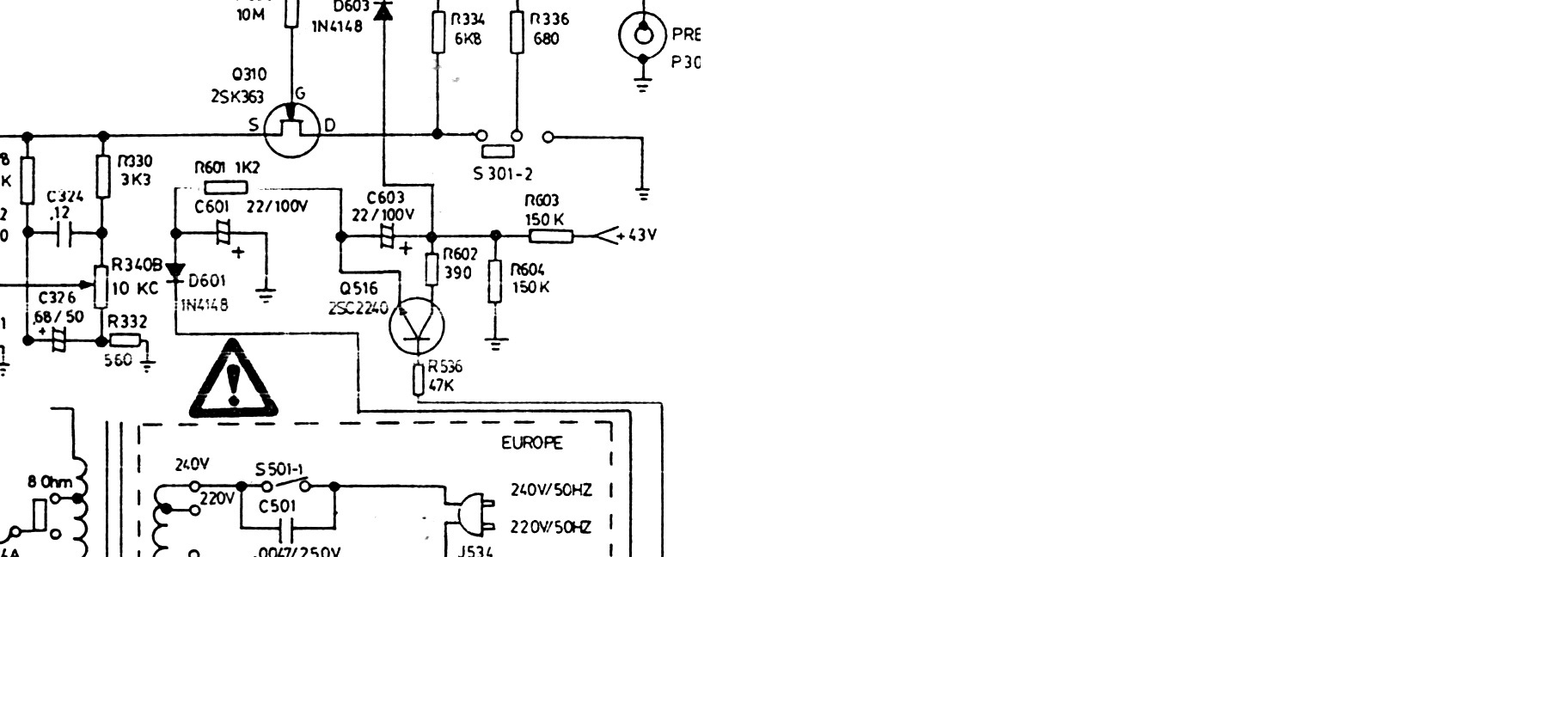

so its connected to Q517 and is a 2SA1015 which if you look at the pin out config its connected to the base,the other cable is connected to the emitter of the Q517.C601 is also connected to this which is on the list
and this is the transistor on the diagram
im wondering if it is somekind of over heat protection
