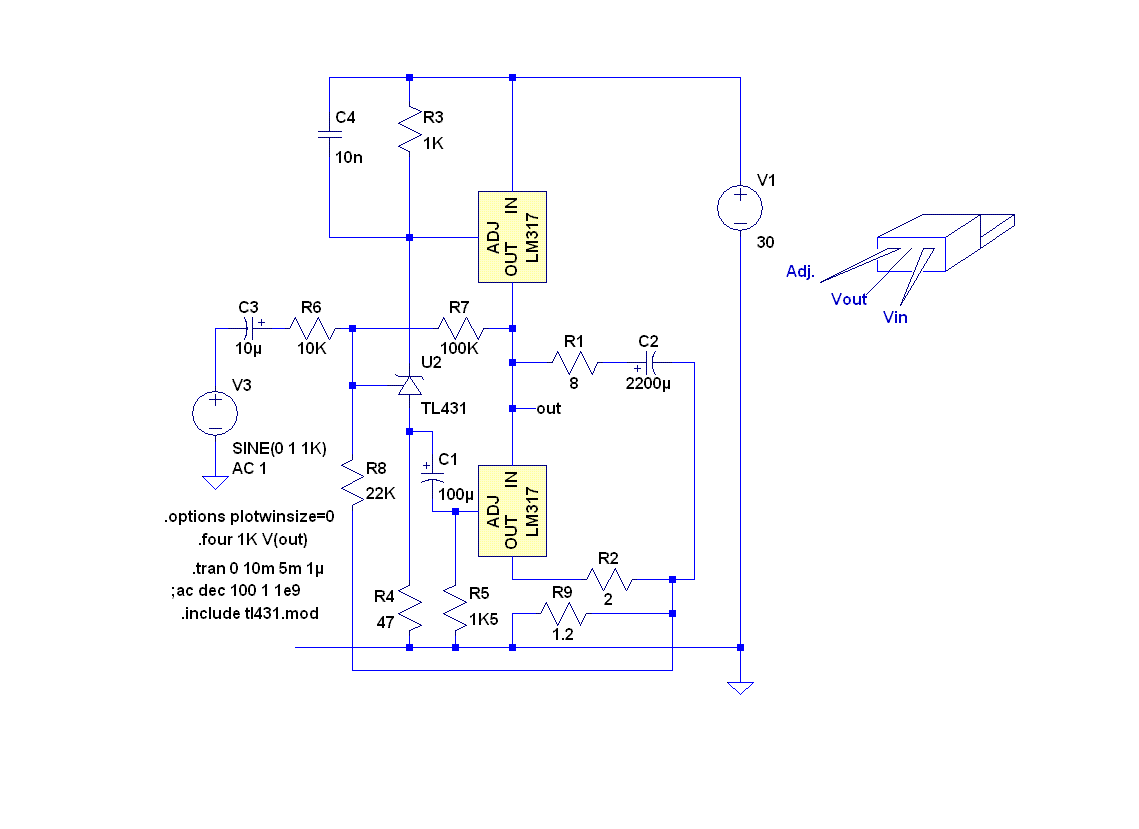

And now, the Regulator-Chip JLH Amp.
After the Regulator Chip Amp and the Chtringlunator, it is time to translate the JLH topology into voltage regulators (I hope JLH won't be turning in his grave).
The task is pretty straightforward, and the results are excellent.
And since the circuit operates in class A, it doesn't have slew-rate issues.
In practice, R2 and R9 can be halved: the spice model I have for the LM317 reaches its current limit at only 850mA, about half the actual device. This will make the amplifier able to drive a 4 ohm load.

A small rectification: the circuit shown in the pictures above is slightly modified.
Here is the actual schematic.

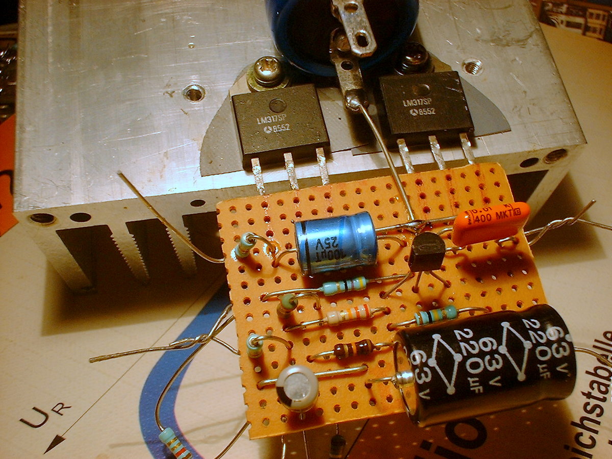

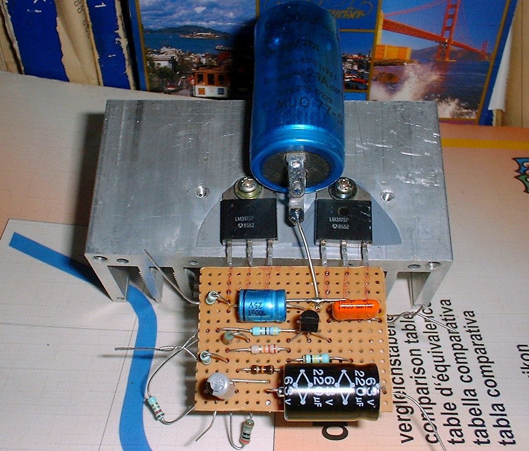

Am bored as usual so tried my skill in laying out the single sided circuit board (38mm x 65mm) based on the schematic that Elvee had designed.
For sure not the best layout as I am mechanical trained with no prior knowledge in circuit design.
