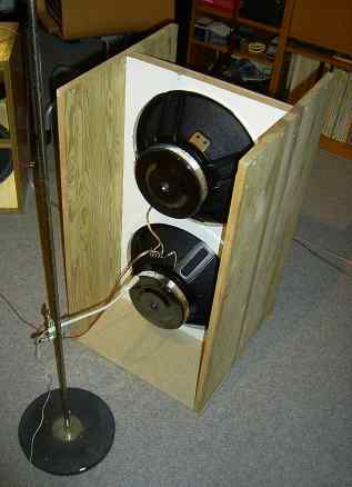

I promised to do some measurements to look after the effect of pulling off the top cover from a H baffle.
First a picture of the assembly:
It shows two 15" drivers in a H frame of 82 cm height and 40 cm inner width. Depth is 20 cm in the back and 22 cm in the front.
I did measurements with the mike in the center of the back plane, 20 cm from the loudspeaker baffle.
The top cover was split in two halfs. One covering the front top and the other one covering the back.

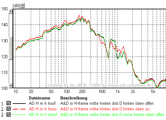

For MJK primarily:
The red line in the diagram shows the H baffle with the top cover on. Black line is with the back part of the top cover lifted off. It´s hardly recognisable, because the green line, showing both covers lifted off (as in the photo) is at almost the same position.
What I see is, that removing the top of a H baffle doesn´t change the character of the baffle much (in this assembly).
I know that I have to do some more measurements to complete the picture. So what measurements should I do next? I will have to confine measurements to the nearfield for the next sessions, so please don´t ask for more than 1 m distance.
BTW: SPL levels are not calibrated, but the mike is.
I agree. And to take it one step futher, there cannot be any standing waves between the sides of the baffle in any of the measurements because changing the end condition would have had an impact on the mode and the SPL response. So I conclude that in the frequency range you measured, I would not be worried about standing waves impacting the sound. This could also be checked by plotting the driver impedance where a standing wave would appear as a discontinuity (wiggle) in the amplitude and phase.
