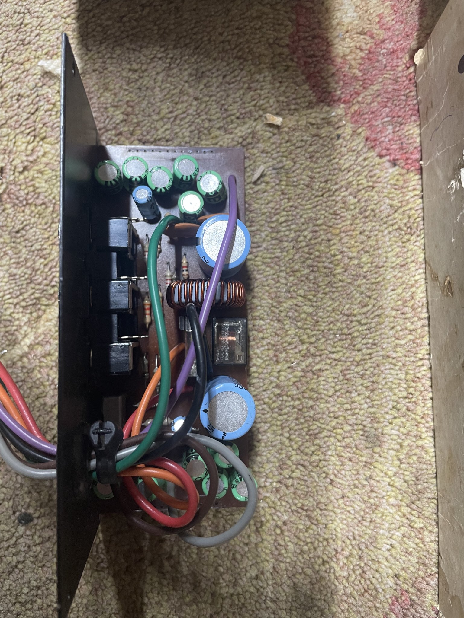

Anybody ever seen a series V Zeus with a board like this? Pwm. IRFP260M ps fets. Tip142/147 outputs.
I was expecting a ps with BJTs…
This one has a blown channel, mismatched outputs, and mismatched emitter resistors. Should be a straight forward Repair.
