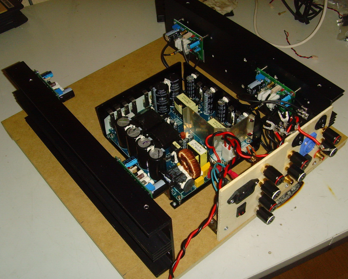

Well: I have had the chance to listen to the AMS 1000-2600 in my current active speaker-project (being connected to the bass-tones / -chassis only!).
I am using Nelson Pass ACA#1 for the high- and middle tones.
The AMS 1000-2600 is a very, very powerful amplifier and you are welcome to use it as your "party-amplifier"!
But concerning its sound: I myself feel that the AMS 1000-2600 is too slow to follow / control any rhythm of a bass (this is my impression) and will not use it in my current setup.
Best regards - Rudi_Ratlos
P.S.: Are there any better alternatives than the AMS 1000-2600 for doing an active 3-way speaker setup (concerning the bass)?
