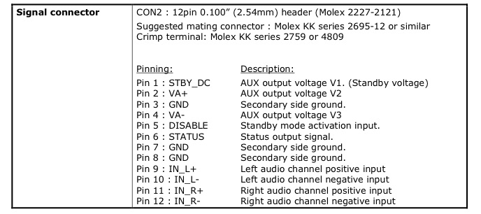

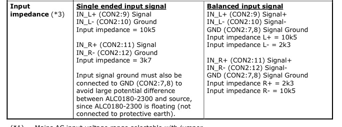

The inputs for the amp will be rca and from the manual it seems straight forward to connect in single ended input mode ie. + and - from the rca connector to the matching connecting pins on the amp board plus the - being also connected to a ground pin on the amp board.

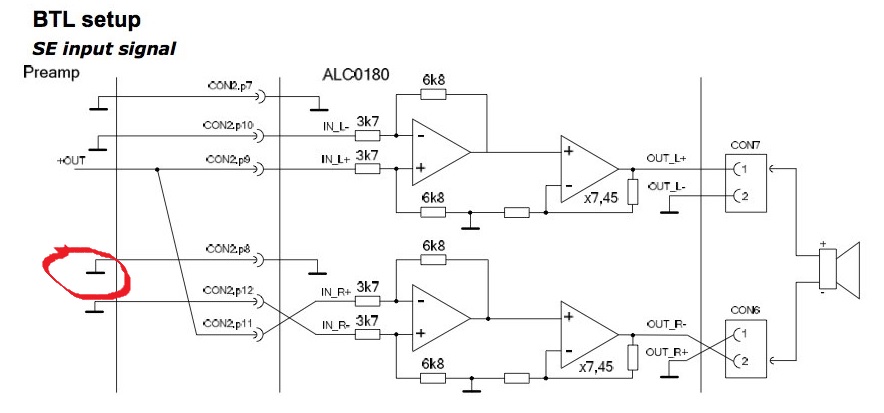

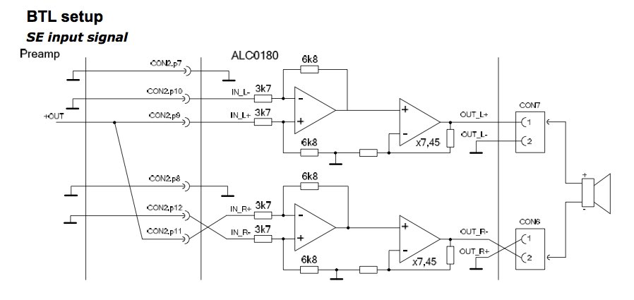

I don't fully understand the diagram for btl mode though.
I know that the + wire from the single rca connector has to split and join both L and R + pins but am not sure whether the - wire from the rca connector simply does not need to be used or whether it has to be connected to all the remaining pins on the amp ie p 10,8, 12 and 7. I would assume the latter. (It is the thick dark horizontal line that is confusing me, does it mean no connection or ground?)
Any help would be appreciated.
I have attached images of the connection diagrams and info that I hope will be useful.

Thanks for the link, I had seen it before, but it seems to differ slightly from the latest schematic from anaview which I posted.
Does that mean gnd Pin 7 and 8 which are usually connected to the - rca terminals when the amp is used in stereo mode are just not connected?
I presume from the different answers I have received that it is not essential.
I am going to order 2 boards and see how I go.

Can the aux power supply be used to power a preamp board?
For the alc 180 on pins 2 3 and 4 there is output voltage of between 7.5vdc and 16 vdc and a ground.
