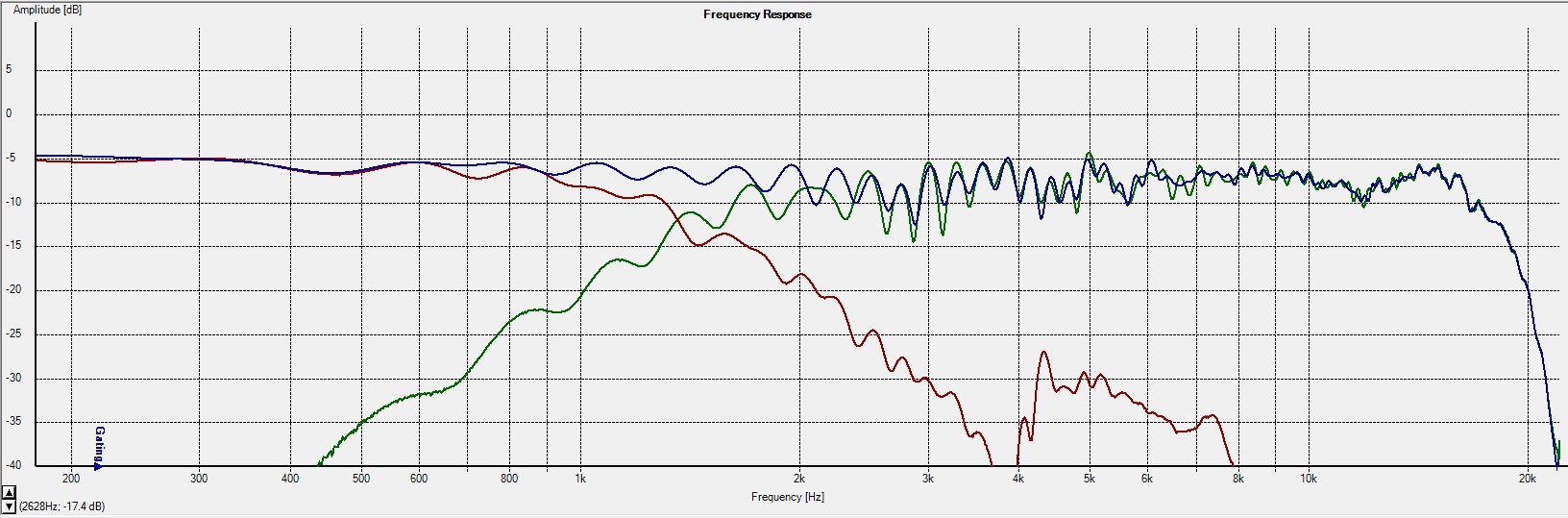

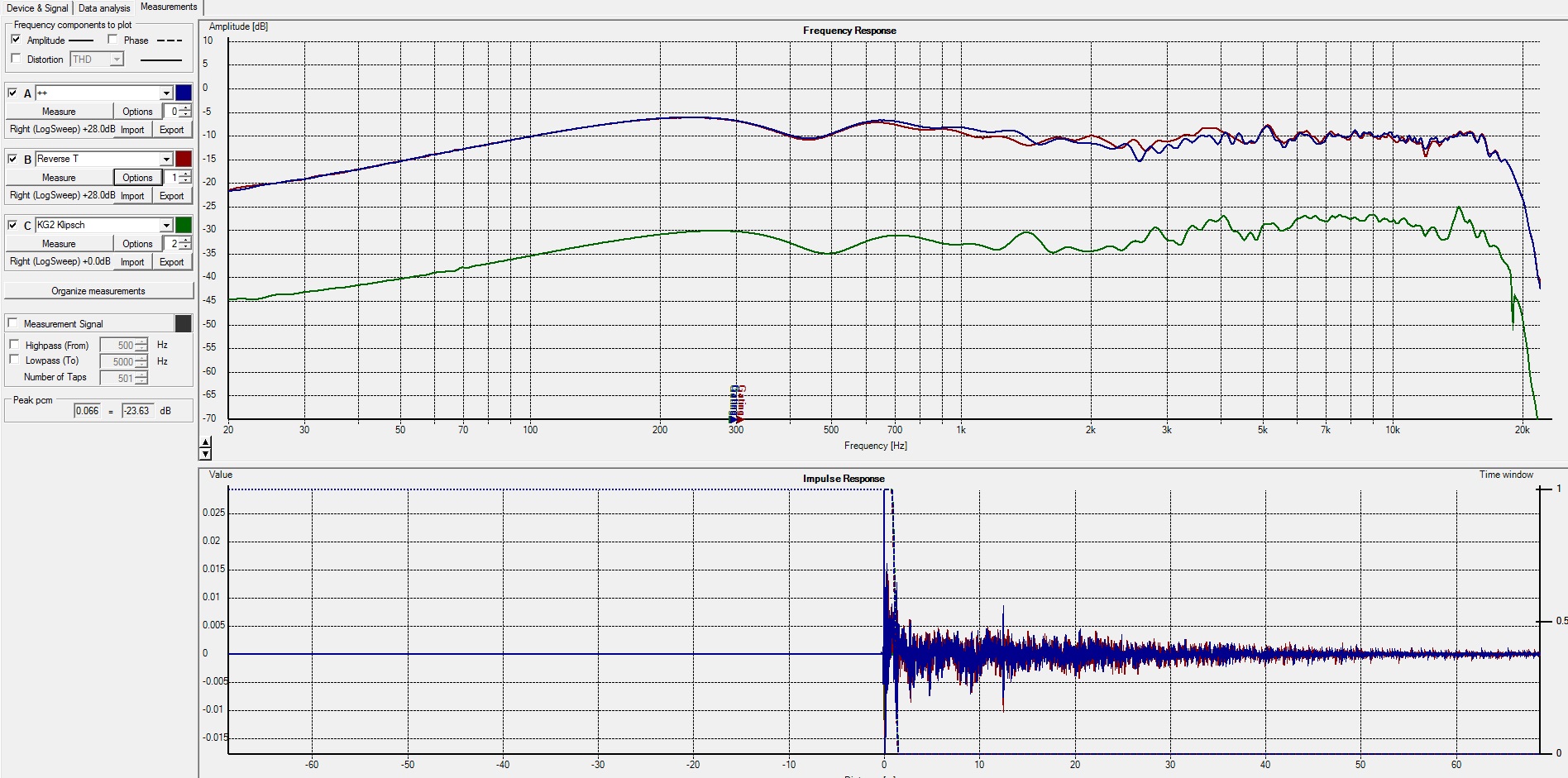

Looks great to me. If this is measured @1m, the tweeter level might be a bit high side for audiophile speaker (if you feel occasional harshness).
I like the tweet a bit hotter (past 5khz) because i usually listen at lower than 90db (fletcher munson curve).

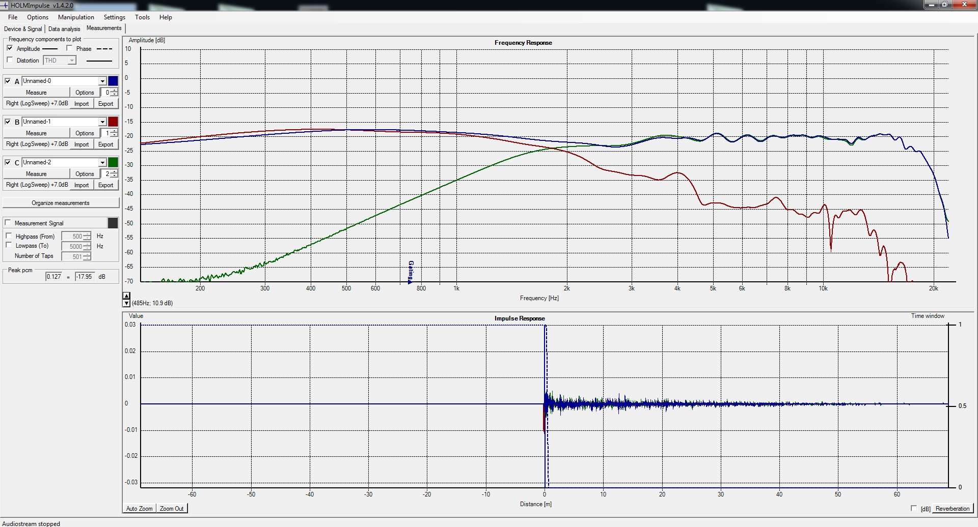

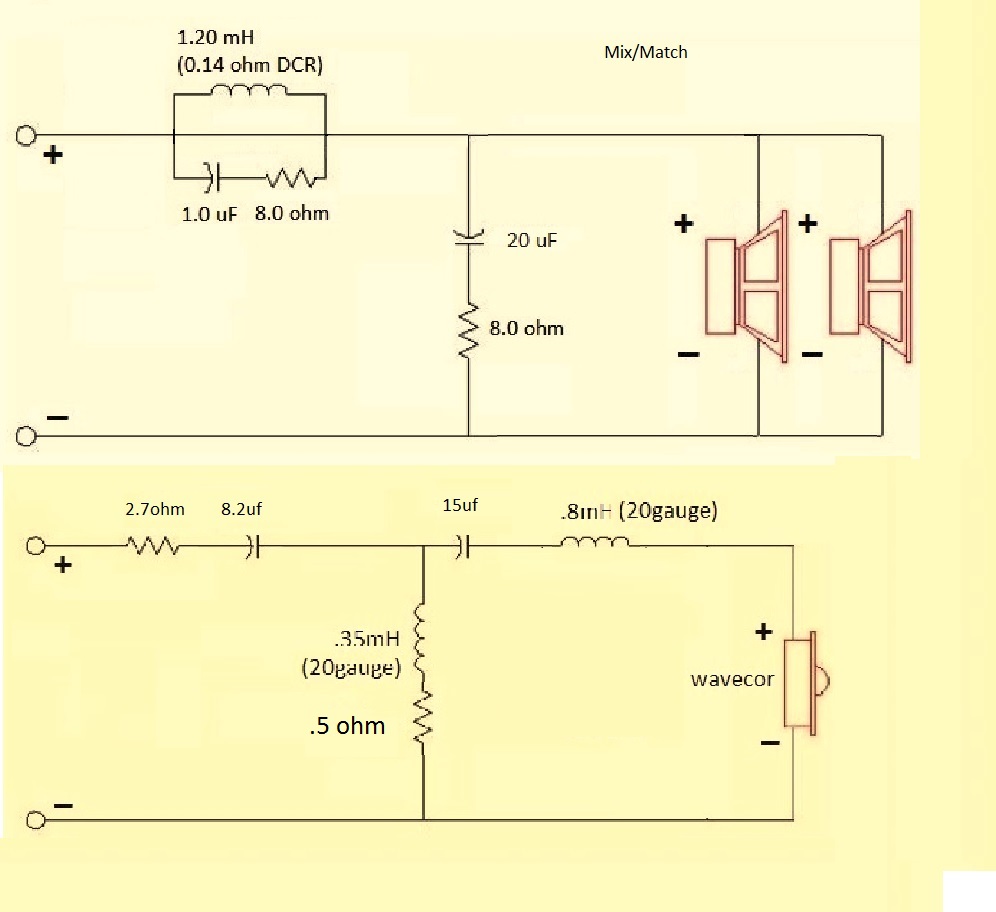

Trying to make a crossover point at 1500Hz with gate at that same frequency ?
I'm affraid that is quite inadequate for any serious crossover work.

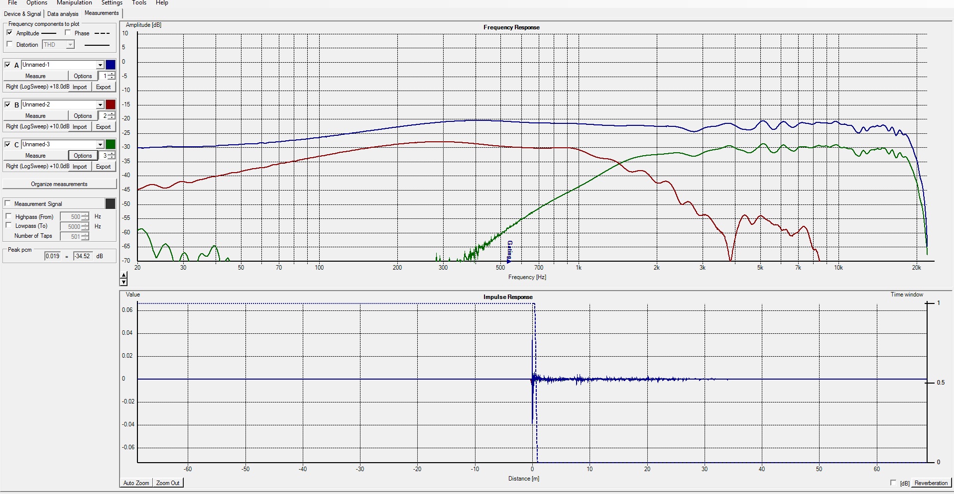

idk,,I liked the sound of the woofers more with the xo I was using, which was Anarchy/ RS28f combination.
Well knew I had to at least give this a try, so mix matched two xo designs i.e. Anarchy/ RS28f bass board for the woofers and a tweeter schematic (board) for the wavcore.
After tuning with the mic/ear realized the xo point was too close together and the mid-range was predominant, but after experimenting with resistor/cap, toned that down to a nice level. The xo point did moved to the right a bit.
They do sound very nice, a bit more open then the first go around; not as flat, but is that everything?

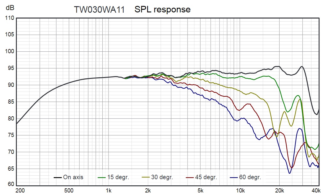

I have a question.
on the wavecore dispersion plots, when graph shows 30 degrees, does that mean 30 degrees off axis ?
Norm, I saw that also and don't know, but the semi horn does fill the room better than other tweeters I've used.

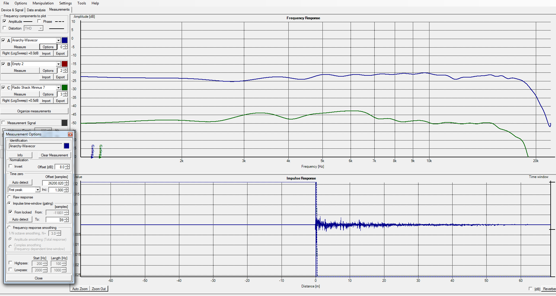

Almost forgot to check this, but the the phase is way off on the xo; same response (or better) with reverse tweeter polarity.
btw, Klipsch mtm on line 3 (green) a KG2, I did hear that store bought speakers are cranking-up the high end.
Yea, phase i think can be closer with 12db tweet plus 18db woof (electrically) not looking at driver rolloff. I think bagby said solstice is "time aligned" but I'm unsure if it can pass a squares wave in tact like a 6db.

The 30 deg is a measurement at 30deg off axis yes 🙂
The multiple angles show you where the driver is starting to become directional, in the case of the wavecore plot it's around 2Khz. This is much lower than for a non-horn loaded design which means it will better match say a 5 or 6" woofer for dispersion if you are crossing over around the 2 - 3Khz mark.
What you ideally want to see with the off axis measurements is them following the on axis just a number of db lower. Evenness is good. big variations not so good.

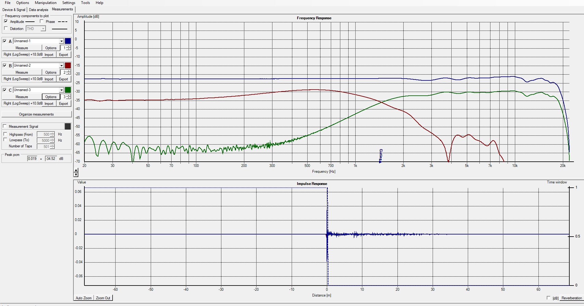

Doug, your measurement in post 36, is that of raw drivers? Could you post one of each driver with it's crossover in place and the phase box ticked?
I'm thinking based on your reversesed tweeter response you may have around 90deg difference in the phase.
Often a 2nd order on the woofer and third order on the tweeter will give you the right phase, but the wavecore being horn loaded has an acoustic centre quite a bit behind a regular tweeter and may not need as much phase shift to match the woofers....
