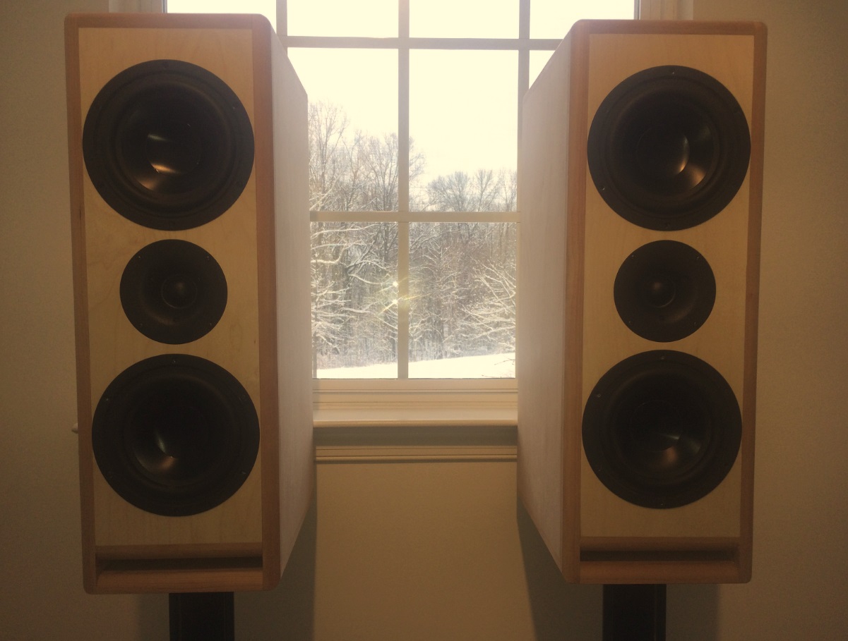

Well all good, and had plenty of supplies to make a pair of MTM's with front port/BB boxes; similar to the Renditions with the larger Wavecor tweeter.
Now the stumbling block, no xo schematic.
Any ideas folks?
TW030WA11_12
[TWO30WA11-01]
Anarchy 7 inch woofer by Denovo Audio
**Boxes shown, no wires, xo, etc.

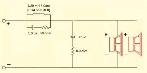

Now the xo, I guess this could use this for the woofers, works nicely. Wouldn't know what to use for the Wavecor.

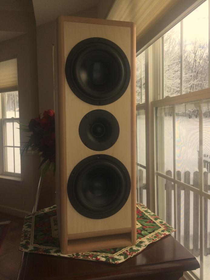

New pic with better light.
btw,,,two snow days in a row, plenty of material = start a second pair.

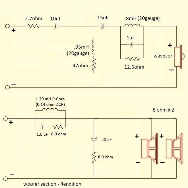

A lot going on AND a now have a xo design for the Wavecor, working on that today.....

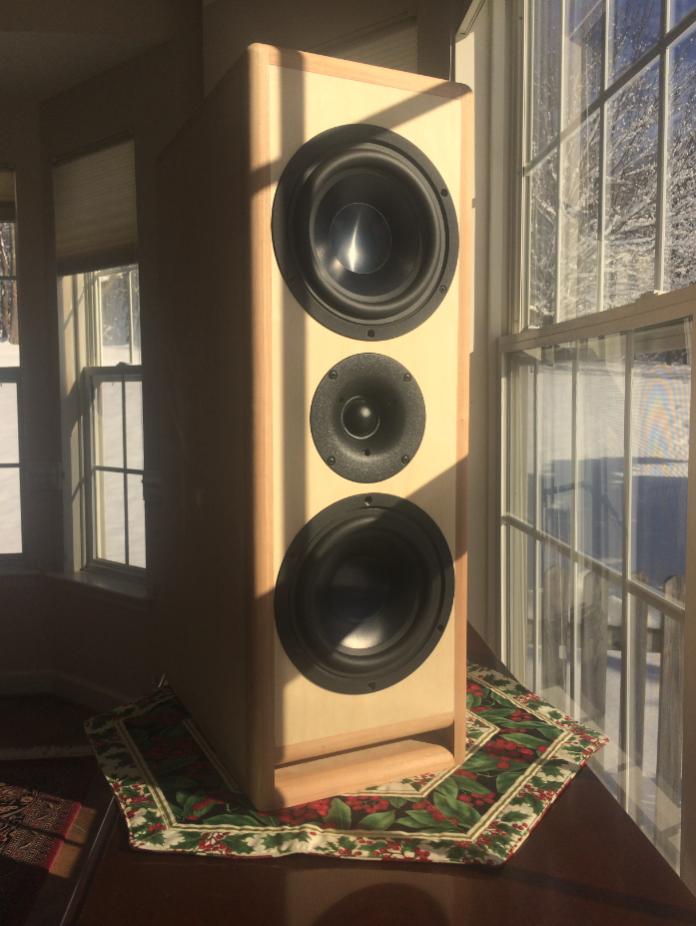

Great Success so far; a very powerful sounding speaker. Easy to forget they are 23" tall and no subwoofer, 3 make the house shake.
Used all the parts shown here: Denovo Audio Apollo MTM
Which is great deal anyway, wayyy less money than the parts can be bought separately.
Call me crazy but a big believer the BB ply, front port and 1/8" cork lining is an upgrade, e.g. the series drive resistor was too high; piggy-backed a another resistor which increased the tweeter level.
Didn't like the the low end as much as the Rendition mtm, there was some deep crazy bass, but sacrificed the mid range.
Will try this next, mix and match tweeter and midwoofer combination (xo on separate boards).
