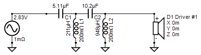

As discussed here I have implemented a good approximation to a 4th order LR to a Seas tweeter by estimating the existing Q and frequency, and using an LT to raise the cut frequency and make the response align to the 2nd order Butterworth - and then overlaying a further second order.
This gives a pleasing result with my miniDSP crossover.
I'd like to use this technique again - but with a conventional (if external) crossover. Is there any software that would do this, or should I just try to replicate the response by simply fiddling in XSim with trial and error? I don't need to introduce any gain, its all attenuation and raising the cut frequency.

Can you present the transfer function (TF) of your MiniDSP settings? In case we know that TF, it could be replicated -to some extent- passively. The impedance can be taken from the Seas datasheet I presume. Otherwise, without any data and measurements, we are basically shooting in the dark.

Is it not possible to low the spl end of the woofer instead by choosing a coil for the passive low pass with more Z, like an air coil, then avoiding the LT on the tweeter ?

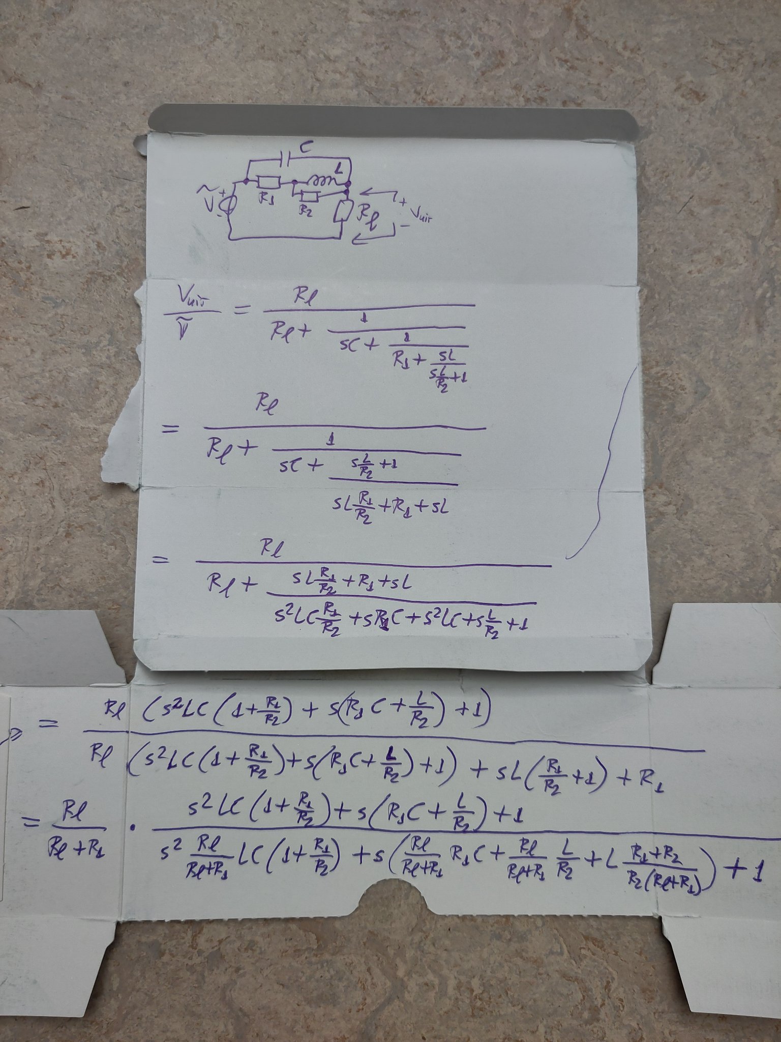

I never heard of a passive Linkwitz transform circuit, but I'll see if I can come up with an LRC circuit that has the required behaviour. I don't see any reason why it couldn't be done, especially not when bass has to be reduced.
