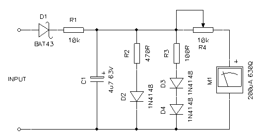

is there anyone ever try this schematic, I try make one with breadboard but it's very little movement, but with TA7318P it's worked. But I try to find another circuit with minimal part, because the IC TA7318P is a bit expensive and rare here.
here's the link to original website A simple passive logarithmic VU-meter

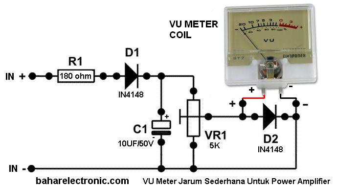

and also I found another schematic that work and also cheap, but I'm curious does it affect sound quality of the output of amplifier?
my amplifier si around 20-50 watt
here's the schematic
