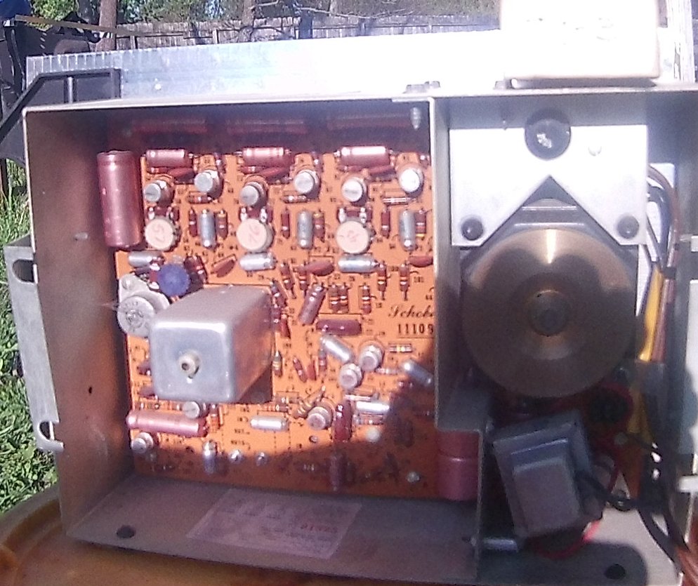

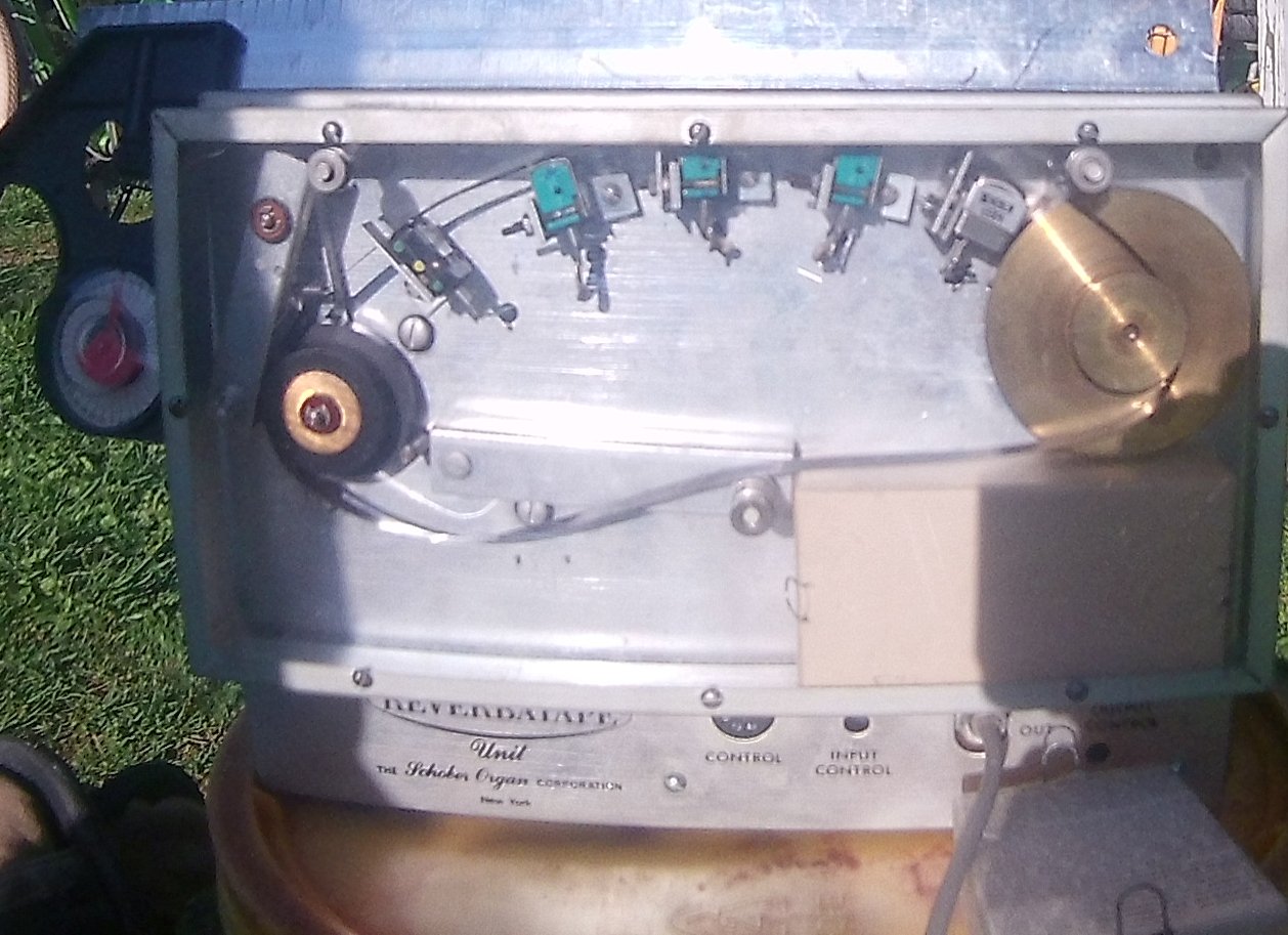

I've got one if you want to buy it, part of a Schober Recital Organ. It comes with several worn out tape loops in schober boxes, one of those "great" ideas from the sixties that wasn't very practical. PM me if you want to make it worth my while to box it up and haul it to the Fed Ex store. It's about 12 " x 8" x 8". It's monaural. No guarentee it works, but it's all there.
Personally I'm going to hook up a Digitech effects rack unit in the organ effects loop with about 100 different reverb ambients, or else use a PC and Audacity software.
My Hammond H100s have spring reverb, which I find interesting but not essential to my enjoyment.
The whole Schober project is rather dingbat, with undistinguished sound, but it comes with Pratt Reed keyboard with gold plated contacts, and as such will make a good candidate for conversion to midi and jorgan software on the PC.
This is a schober reverbatape unit. White box is a used tape loop. 1' scale on top for reference.
