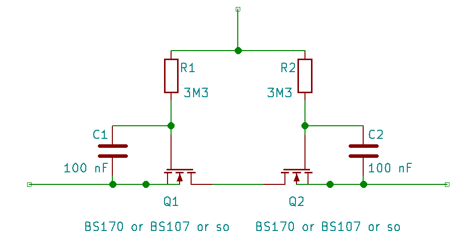

If you could find a P-channel depletion MOSFET, it will behave very similarly to a P-channel JFET except that the gate can't go in forward conduction. I'm afraid P-channel depletion MOSFETs are even rarer than P-channel JFETs, though.
Two bootstrapped NMOS switches in antiseries, maybe? (Ordinary enhancement NMOSFETs, small ones because of source-drain and gate-drain capacitance and because of leakage.)
To explain the idea and assumptions:
I assume the DC voltage on both sides of the circuit is kept at 0 somehow.
When the control voltage is also zero, both MOSFETs will then have 0 DC gate-source voltage. Due to the capacitors, AC voltage on the source is also coupled to the gate, so the gate-source voltage remains essentially 0 with an AC signal present. Even though the MOSFETs have essentially 0 gate-source voltage, their drain-bulk diodes can still go into conduction at signal peaks. Using two in anti-series ensures that there is always one in reverse, so you never get a conducting path from input to output.
When the control voltage is 8 V, both MOSFETs are fully on. The trick with the capacitors then slightly reduces distortion by keeping the gate-source voltage constant, but you probably wouldn't have much distortion anyway.
As an undesired side effect, the 3.3 Mohm resistors load your guitar and inject a very small thermal noise current. You could go for 10 Mohm and 33 nF (or 47 nF) if 1.65 Mohm extra load is intolerable.
The MOSFETs have some parasitic capacitance between gate and drain and source and drain (see their datasheets for details). If the load has a very high impedance, high audio frequencies will capacitively couple right through when the switch is off. You may then need an L-switch or a T-switch (switch and switch to ground, or switch and switch to ground and yet another switch). The same holds for P-channel JFET switches, by the way.
Because of the RC network, the switch turns on and off slowly. You know better than I do whether that is a problem or a feature for your application.
Mind you, the BS107 and BS170 require careful handling because they are quite sensitive to ESD. I hope that is largely solved once they have a big capacitor between source and gate.

@MarcelvdG , nice circuit idea.
The soft turn-on/turn-off could actually be a feature, making the switchovers click-less.
@MarcelvdG, yes this interesting cicuit. I have seen this but I did not find much about this antiseries mosfet circuit in relation to analog switches.
But this may worth to do some spice simulations to see if even the capacitor can be left out to make it simpler.

Leaving out the capacitors could degrade the switch’s ‘off’ isolation.But this may worth to do some spice simulations to see if even the capacitor can be left out to make it simpler…
One weakness of my circuit is that you temporarily get some current flowing from the control input via the large resistors and the capacitors into the signal path at switch on and out of the signal path at switch off. Using very large resistors limits that current.

Thanks for all the contributions. I think I will look for the n channel anti-series construction.
Does anyone have goo seuggestions for dual mosfets in one package to save space? But it should be possible solder by hand.
SOT23-6 would be perfect but SOT363/SC70 is also possible but the smallest package I could solder.
I found BSS138PS, FDG6301N, NDC7002N.
