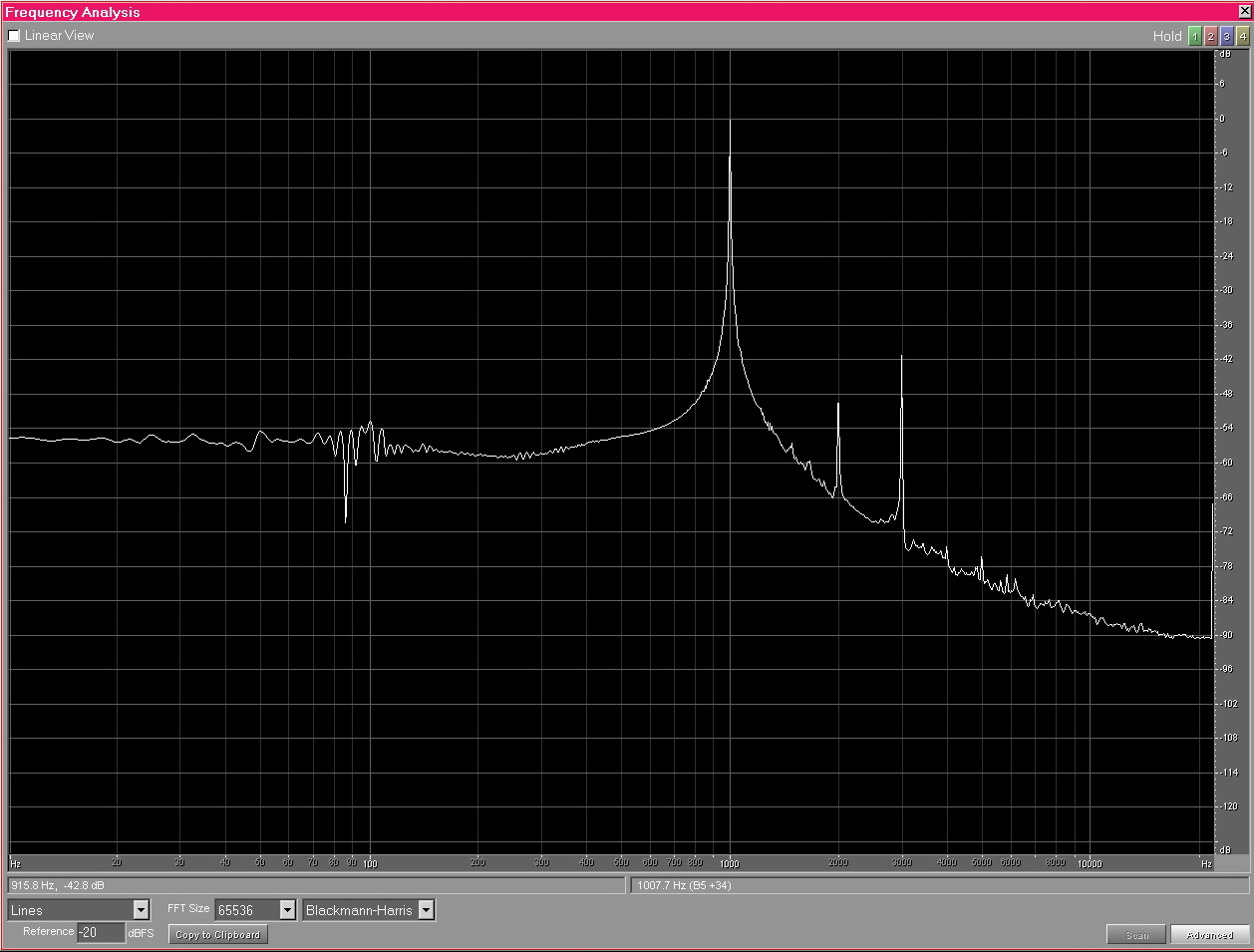

That 1KHz with the harmonics from the MC cartridge may be the very reason why vinyl sounds so much better. Looked at in isolation it's clearly not even close to CD in performance. But looking at it in such a simple context would be rather stupid (though this most ofthen the case). An MC cartridge is exactly the opposite of a speaker driver so the two mechanical inherent flaws tend to cancel each other, I wonder how this would look if it was analyzed through the system as SPL from the speaker.
It "sounds so much better" because you just can't get enough of the good distortion, certainly doesn't delivers more High Fidelity. I made the measurement (sort of) which you asked for. Here in Toronto ,where I am is no an-echoic environment, and also some hum in the system, so I had to use some denoising in the Cool Edit. For playback I used a Philips 212 record player with a 412 pick-up (I had no access to the Rega) a Technics SU-9070 preamp, an Elektor electronic xover ,a Parasound HCA-855a power amp, and an Altec 802 attached to a midrange conical horn. For the recording an AKG C451e omni mike (right in to the horn mouth, possibly somewhat attenuating the reflections), a Nagra pre amp, transformer coupled to the computer. The Philips is a bit better than the Rega was, and you are right the playback spectrum improved. The Philps H2: -38dB, H3: -46, while the playback came out H2: -49.5 and the H3: 41.3dB.
CD sounds dry, one must have a good system, with good speakers and a good recording to appreciate it, but then it's no comparison.

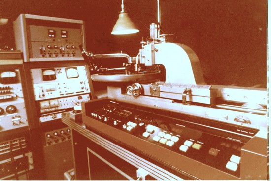

... First, I encountered many months ago a newsgroup article (not on DIYA) about the CBS Discomputer.
The CBS DISComputer was a cutting lathe that optimized the groove spacing dynamically to balance the compromise of playtime and depth of cut (loudness).
It was one of father's projects when he worked at CBS Laboratories in Stamford, CT.
In my life experience, I have never found that ADDED distortion added anything good about sound. However, I have often seen examples of LOW distortion amps, sources, etc, that sound relatively lousy.
Analog tape recordings are a good example: You had to live with the S/N and distortion, hoping to ride the gain to keep the sound acceptable, BUT the intrinsic quality of the music was retained inevitably with the Revox A77, running at 1/2 track and 15 ips. For example, Dave Wilson used this set-up for years, before he had me design a 30ips full track machine to replace it. The improvement was real but relatively small, when it came to just enjoying the music. What 'kills' sound quality seems to be lousy IC's and sometimes Class C output stages that are used all too often. In this case, a much more expensive Studer might sound lousier than the A77. We have made the comparisons.
In my experience, the BEST source is a DIRECT DISC vinyl recording (virtually unobtainable today), next best is a high quality analog recording, and third is a high quality analog recording made into a vinyl record. This is what Stan Ricker was attempting to get right.
Actual sine wave measurement of standard distortion will NOT tell you much about how the recording will actually sound. Listen, and you will find this to be so.
