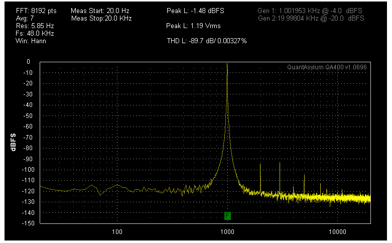

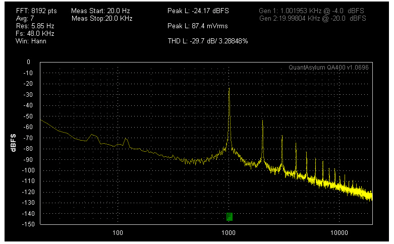

Here's a Rega Planar3 + a Paravincini preamp with a Benz Micro riding on a 1kHz track on a test LP vs a Tascam CDP playing a 1kHz test track. Chose the first if you in for listening to extra harmonics. Now a record player doesn't have to be that bad, but this never gonna happen to a CD player. 🙂
