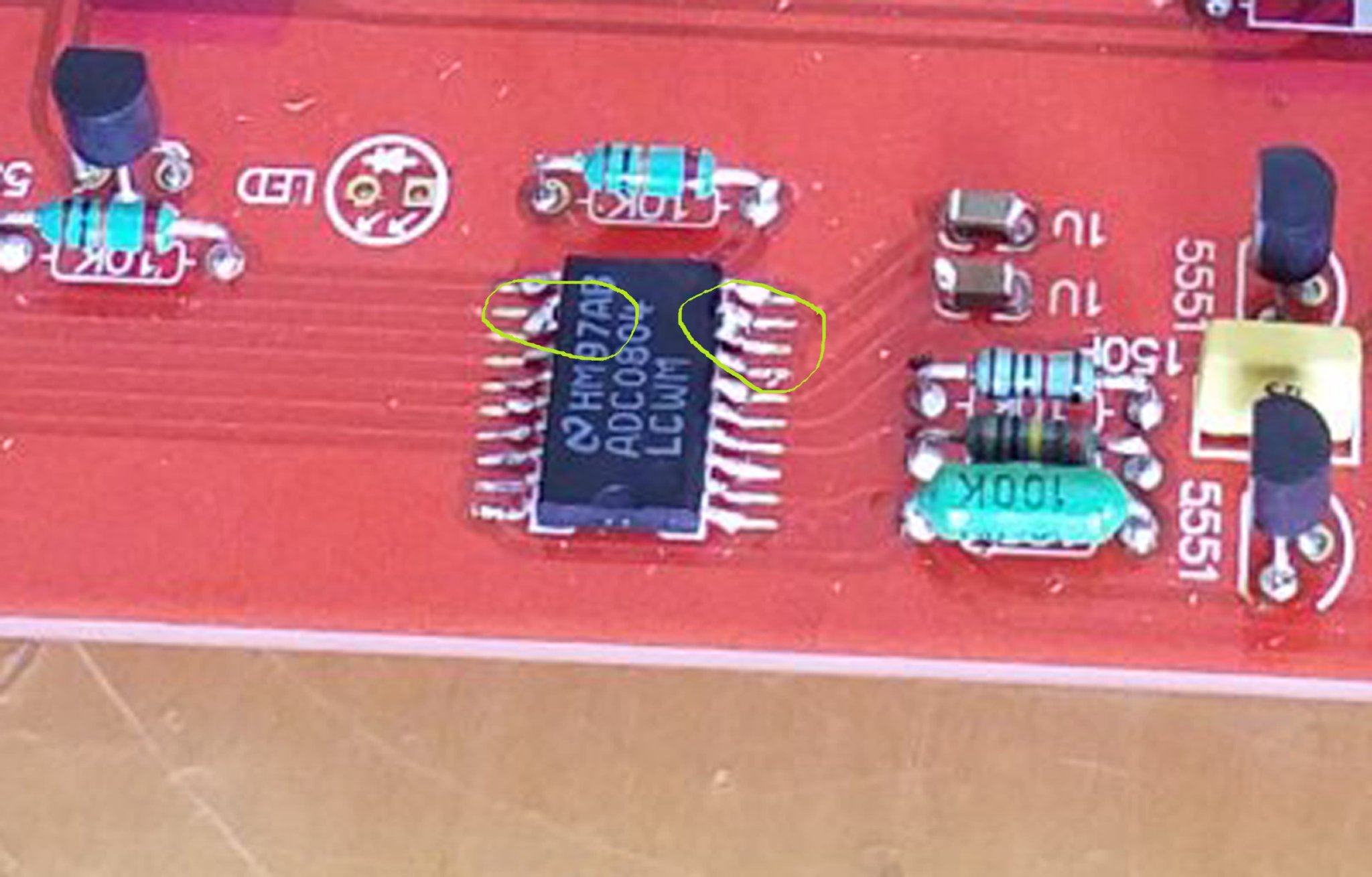

Don´t know, if they´re intended or not, but if not..... You might wanna remove the "shorts" before powering up 😉Heres pass p 1.7.
Brass heatsink, distributes heat equally, original Harris irf610, itt relays, siemens 0.1% resistors bought for attenuator but not installed, mkc caps paralleled with Russian petp capacitors.
Think its gonna be a nice preamp with its finished, haven't figured out chassis yet.

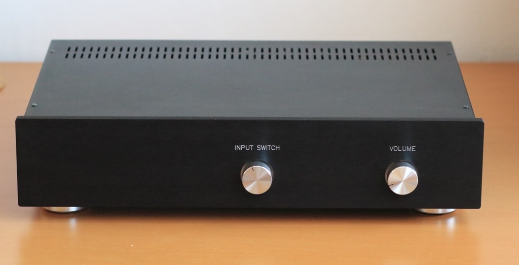

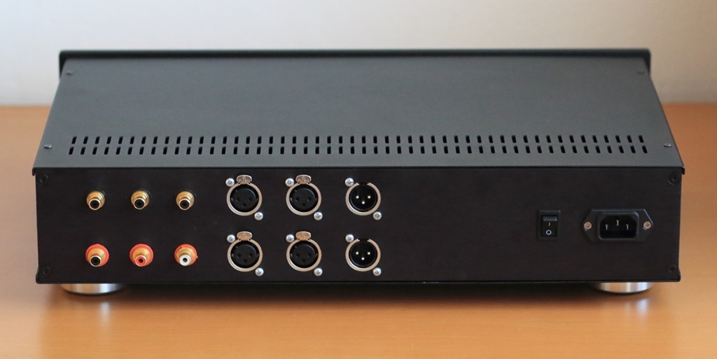

Not a build, just assembly 🙂 Muses72320 vollume control with Single-ended to balanced converter. Dont mind the wiring on the RCA, about to redo them ith twisted pairs solid core silver wire. 3 RCA inputs, 1 3.5mm input on front, XLR out....
I might have some problems with the voltage out, getting 9V on XLR at full gain and 0dB...i create a thread about it.

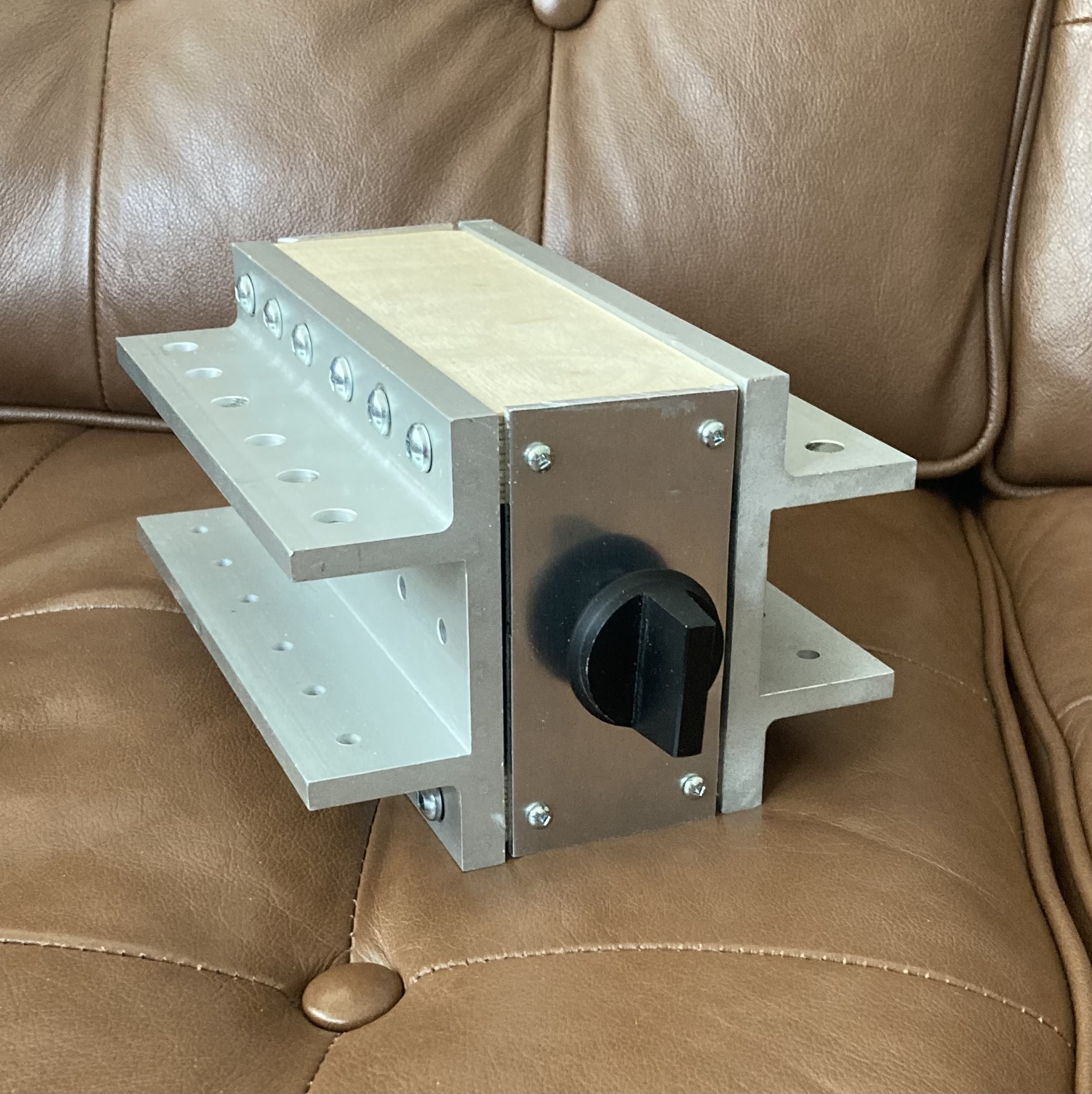

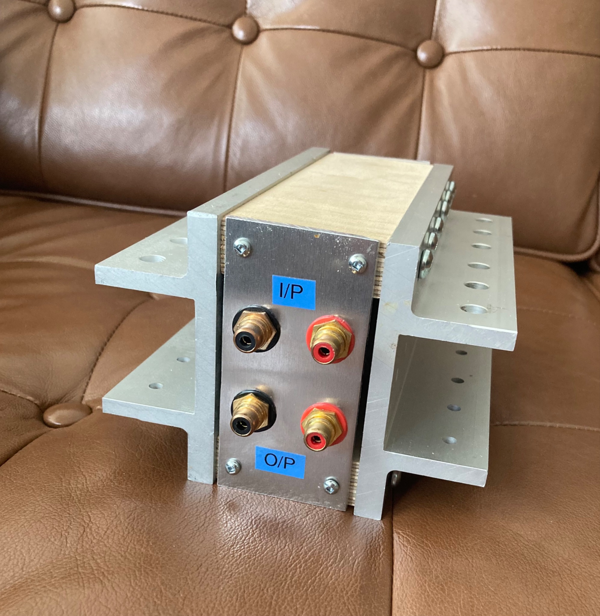

I had just one evening to build a stereo passive volume control for a power amp using whatever I had in my junk box.
Criteria was excellent quality components and it must be heavy so that it stays put.
I found a couple of chunks of Aluminum bracket for the weight, cut a couple of pieces of Baltic birch and drilled holes in a couple of aluminum plates - simple construction helped keep it under control and it all had to be done in a garage with gloves on due to freezing temperatures.
Had to be smart with use of available screws.
Found a nice Noble potentiometer, and a roll of Teflon coated small strands OFC signal wire.
Beautiful job. Congratulations 👍👍
