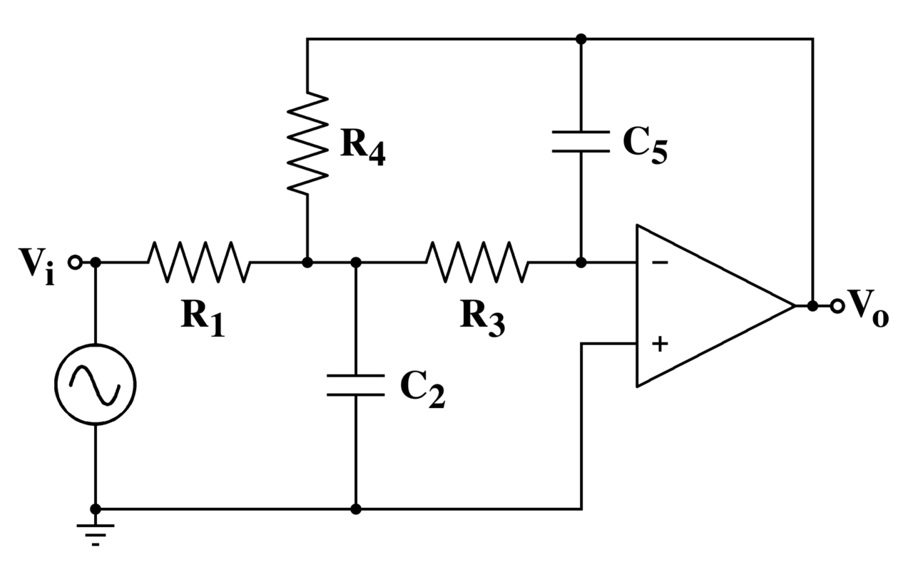

Or use an inverting opamp as a summing stage.
And if you want to low pass filter the summed channels, then use an MFB low pass active filter. It both sums the two (or more) channels and applies a 2pole active filter all from one opamp stage.
Duplicate R1 for each extra input channel.
Gain = R4/R1
for a two input version Vout = Vin*R4/R1 + Vin'*R4/R1' (potentially twice the individual channels).
Gain = R4/R1
https://en.wikipedia.org/wiki/Electronic_filter_topology
As the junction of R1 and R4 is not a proper virtual ground, but part of an active filter, you can't simply duplicate R1 for each input channel. Each extra R1 effectively reduces the value of R1, so changing the Q. Instead, for three inputs use 3xR1 for each input etc. Then the filter circuit sees the same source impedance as for one channel.
