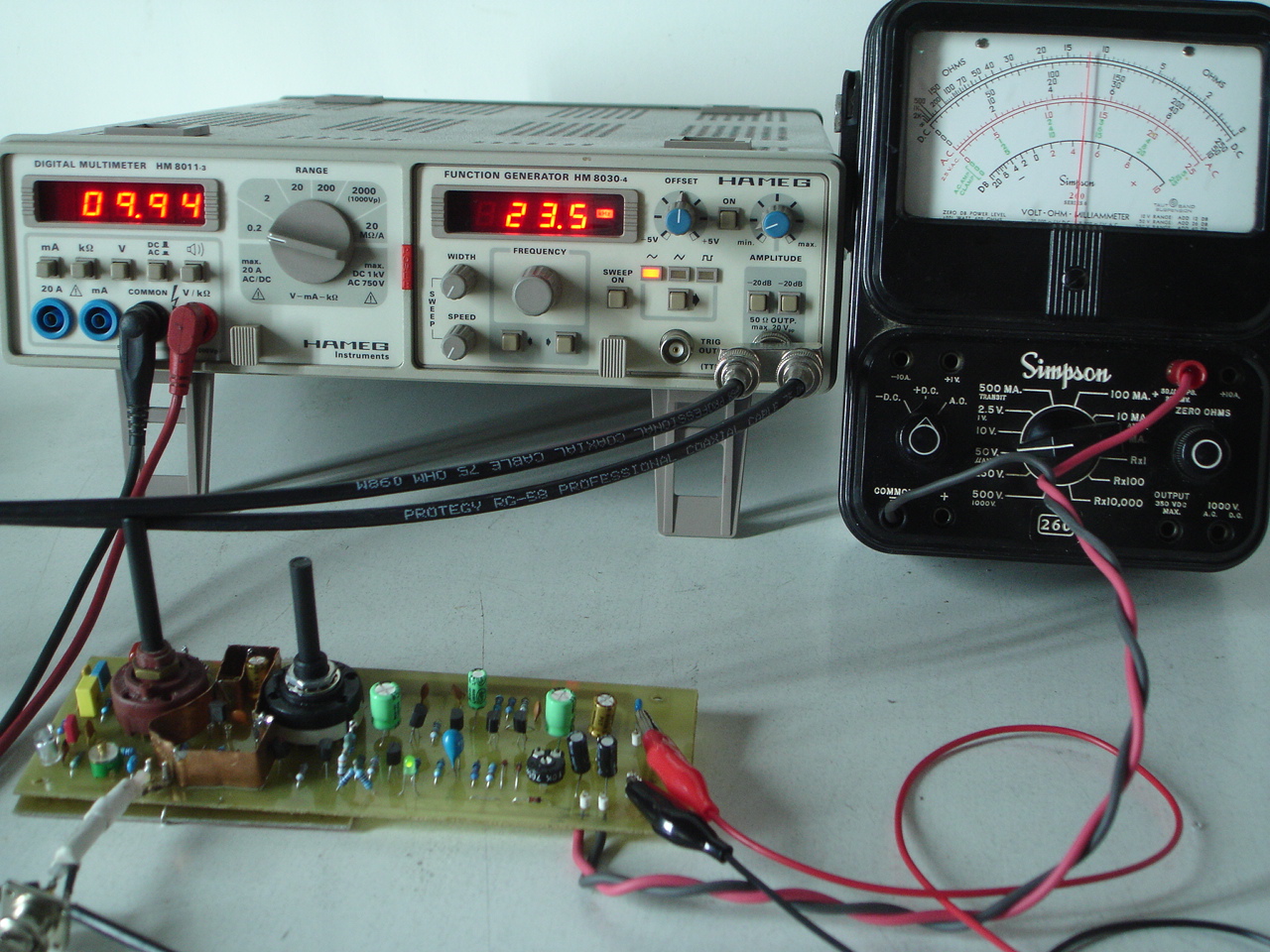

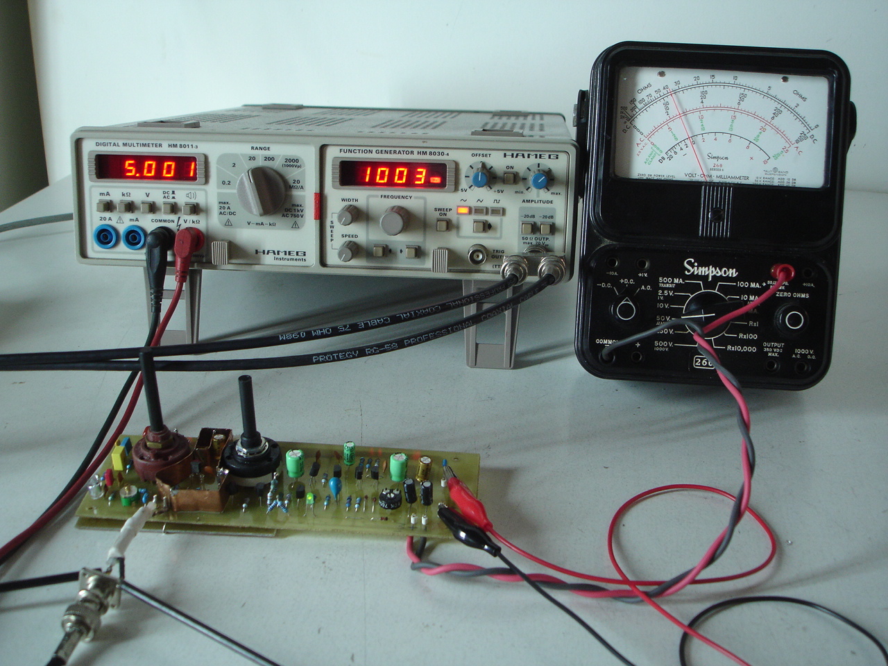

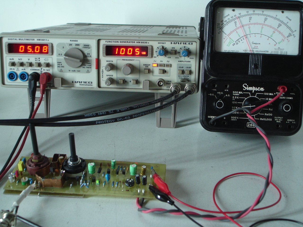

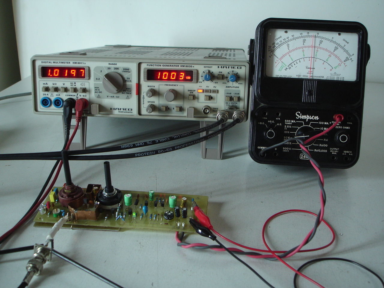

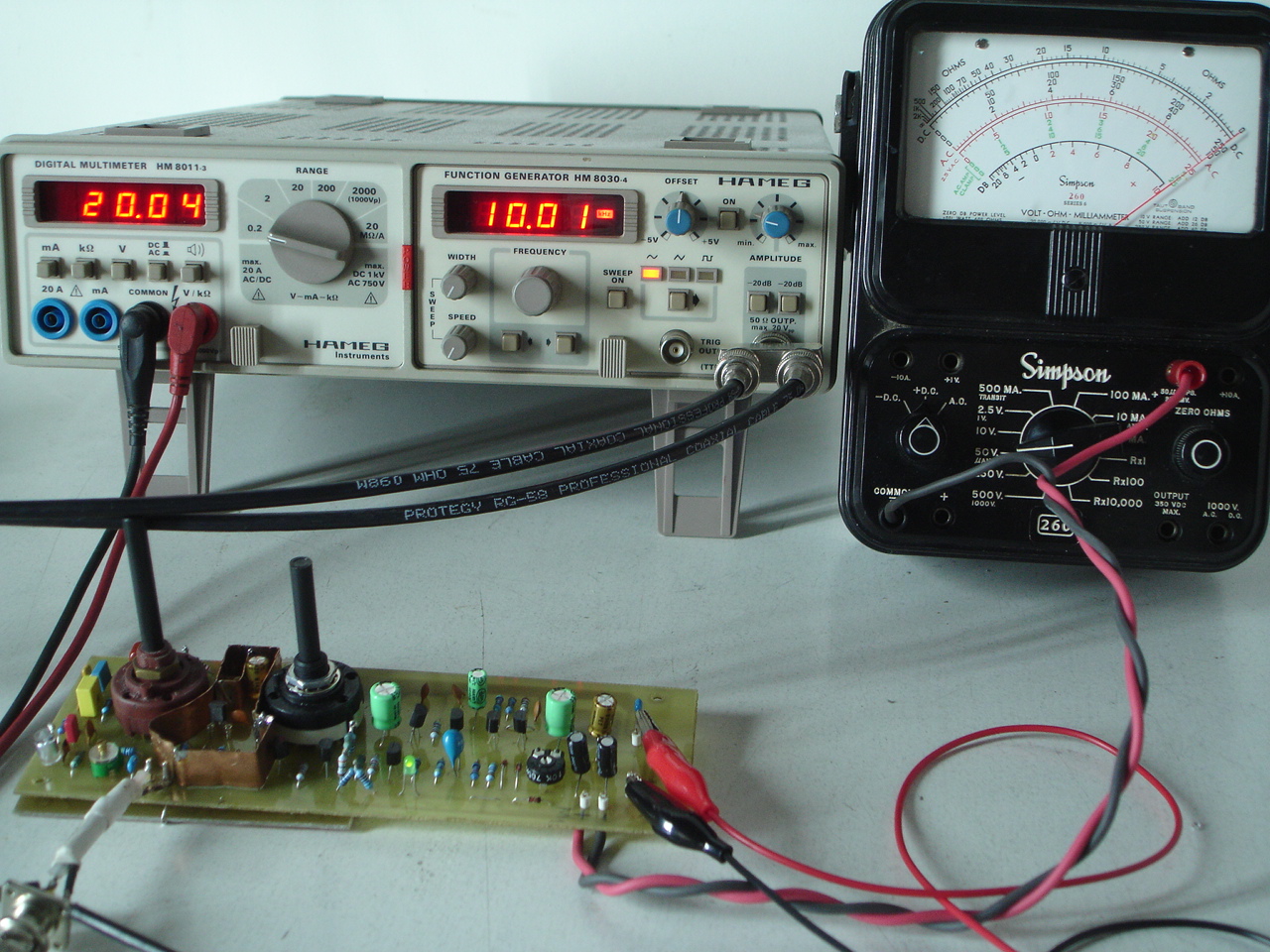

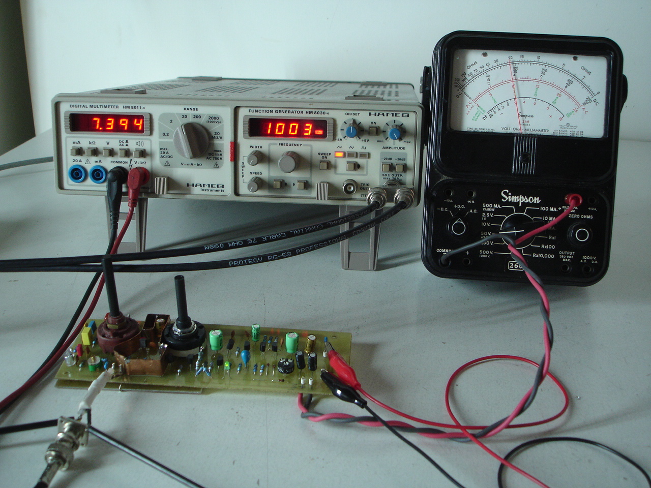

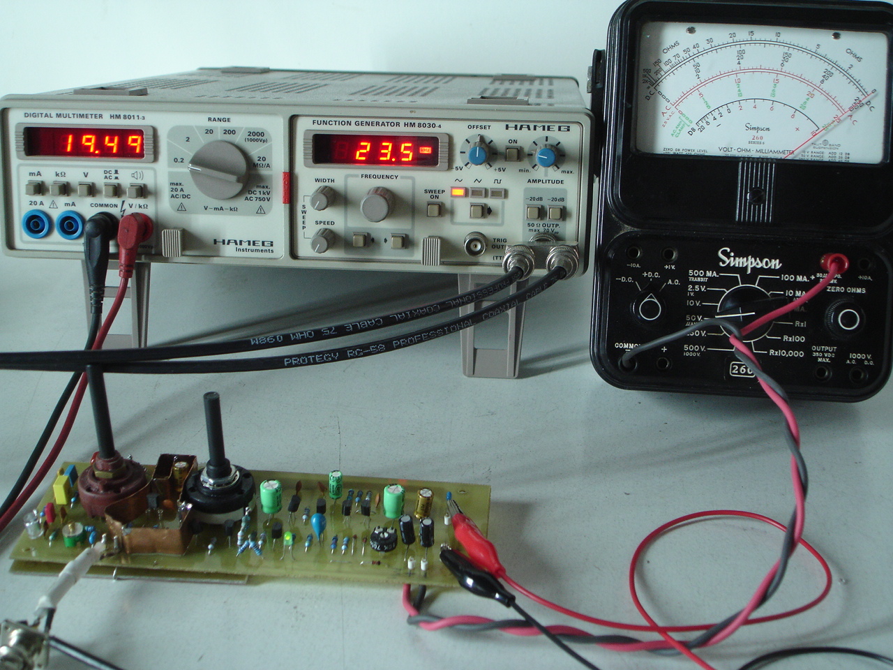

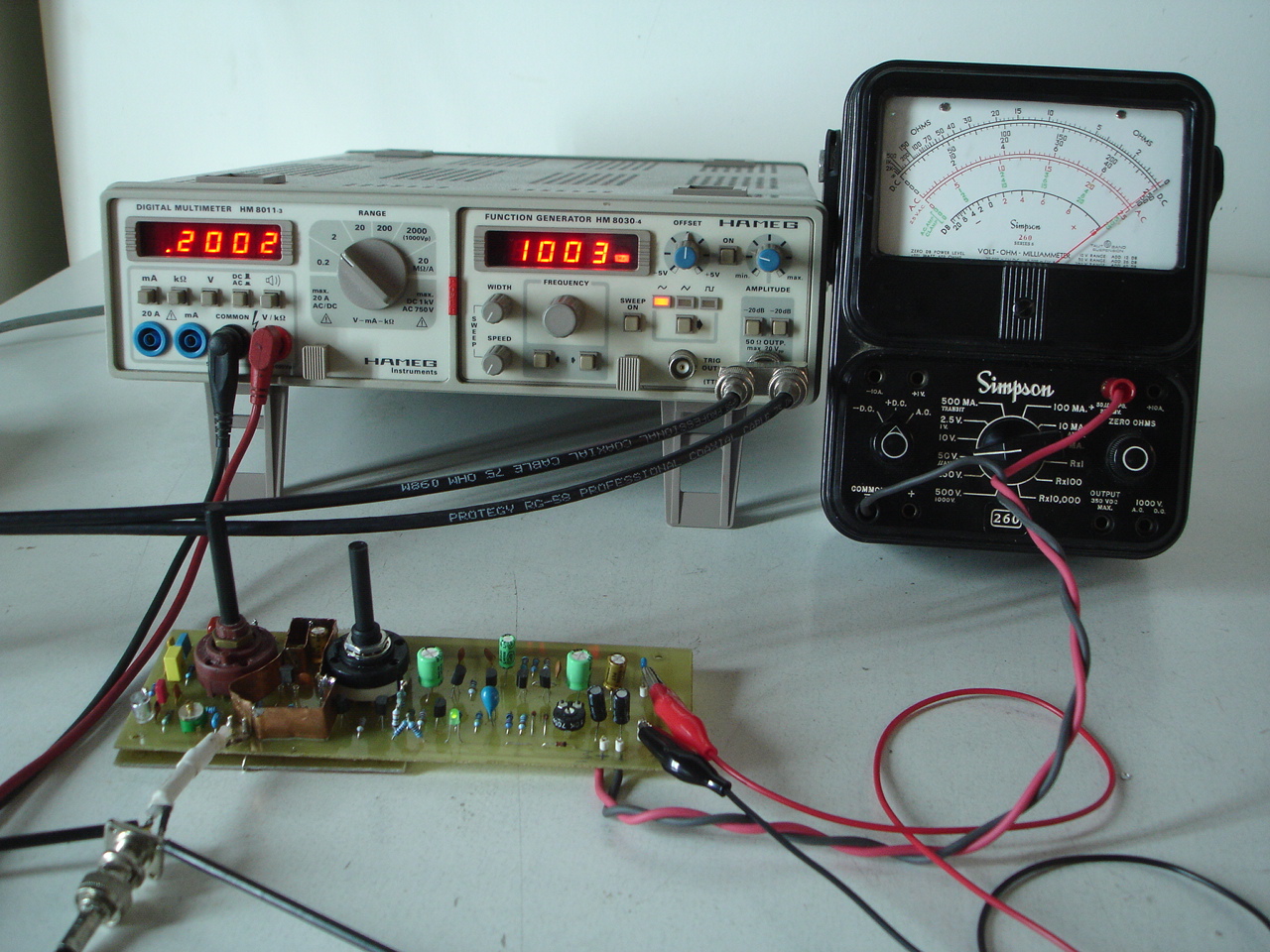

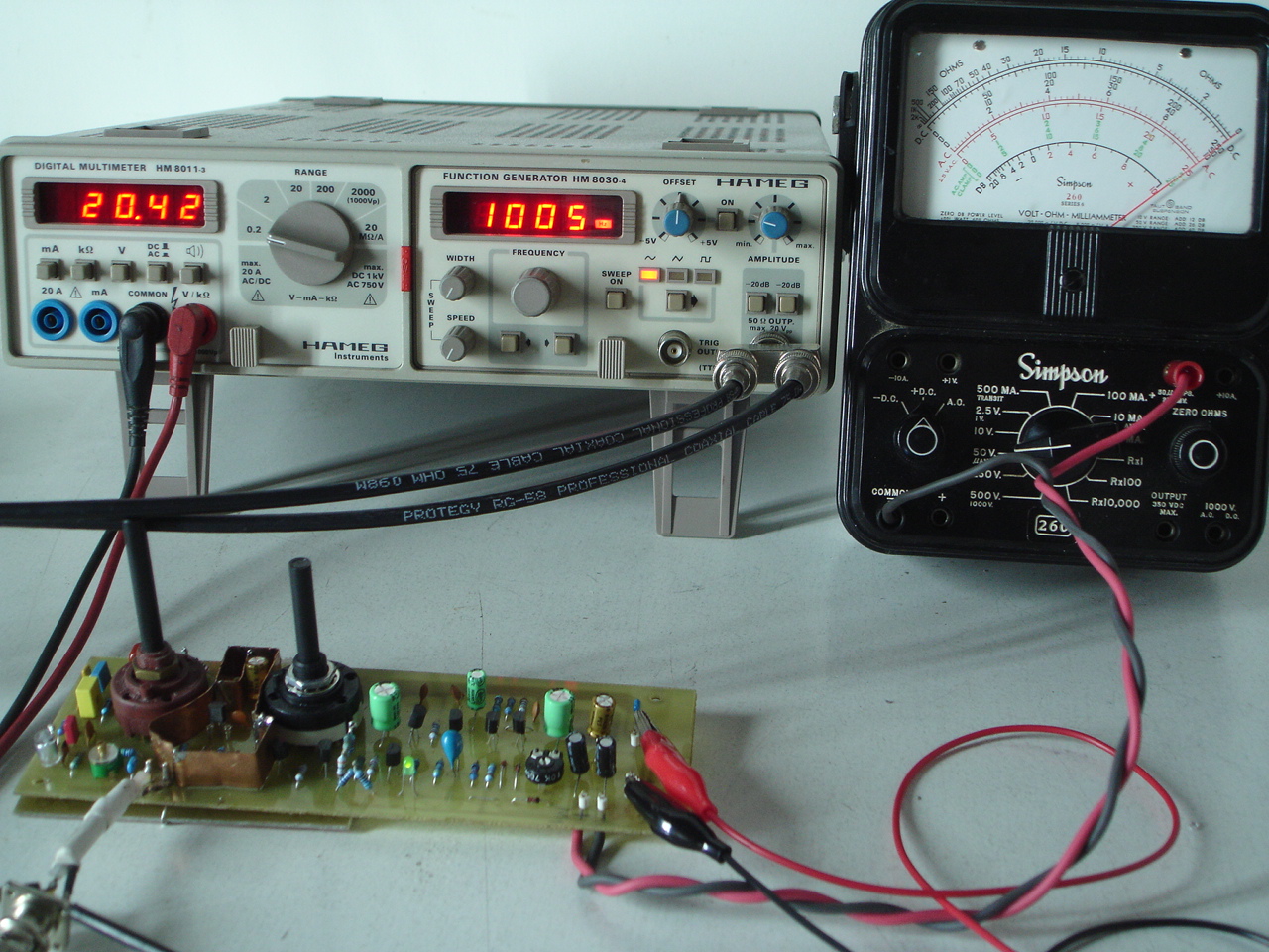

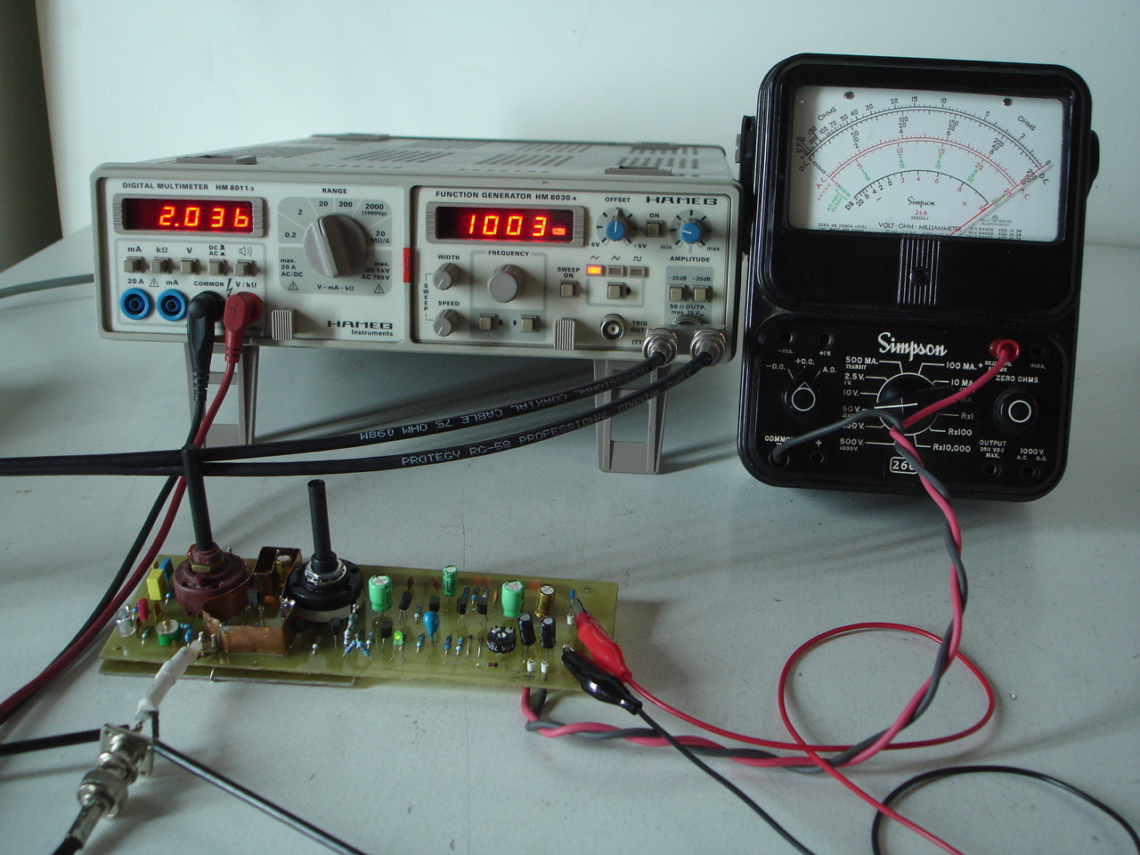

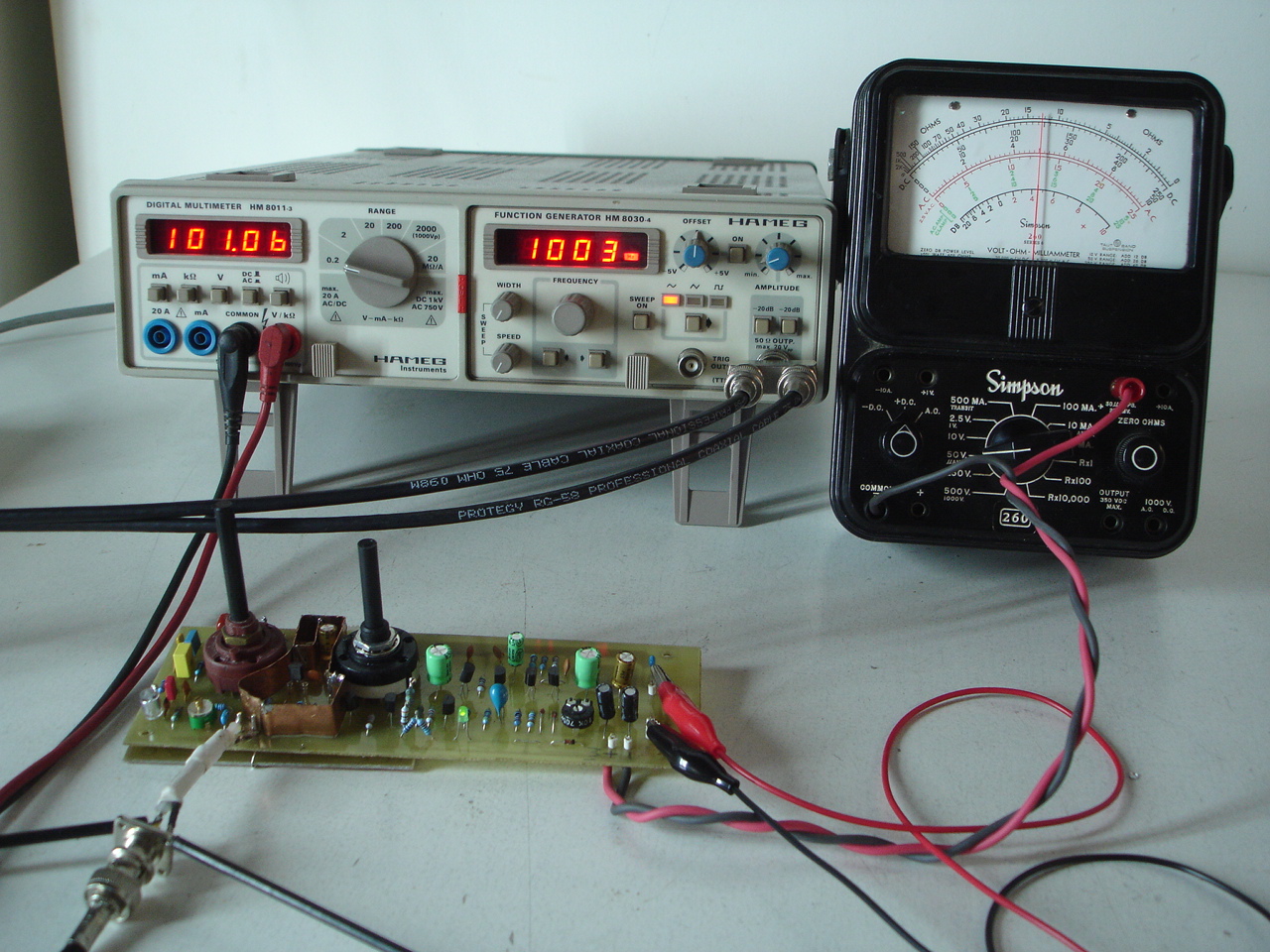

A first test using a Simpson analog voltmeter at 50μA scaling.
The rest
Thanks , i believe not bad for a such simple circuit.Cool !!!!!!!!!!!!!!!!!!!!!!!!!!
Congratulations .
Are some of those test frequencies 10Hz and 23.5Hz, or are they kHz?
Are all the others at 1kHz?
Post #32 pictures 4 & 5 frequencies are 10kHz ,Pictures 6 & 7 are 23.5kHz.Are some of those test frequencies 10Hz and 23.5Hz, or are they kHz?
I will post soon measurements up to 100 kHz when i find suitable voltmeter for comparison ,and measurements for low scales 200μV,600μV when i have a divider.

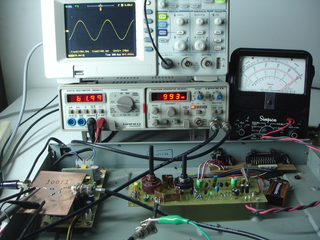

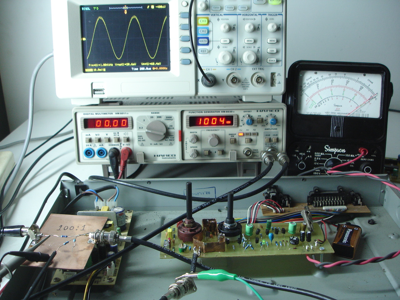

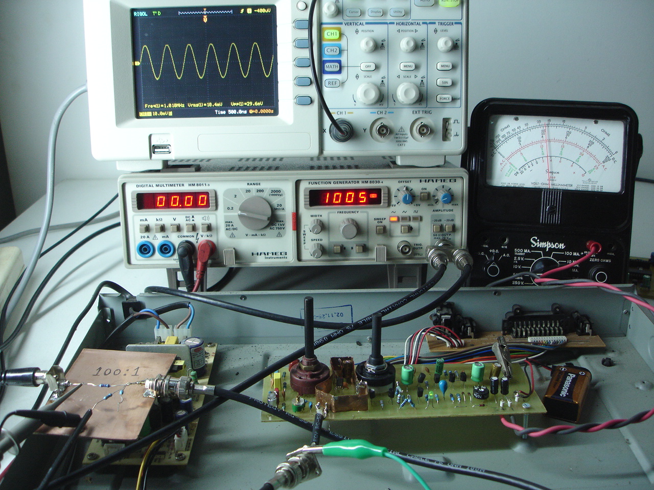

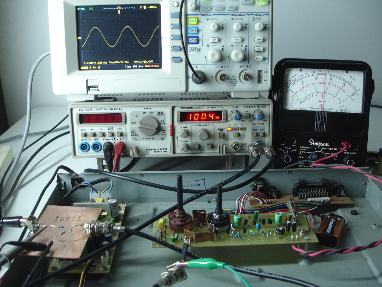

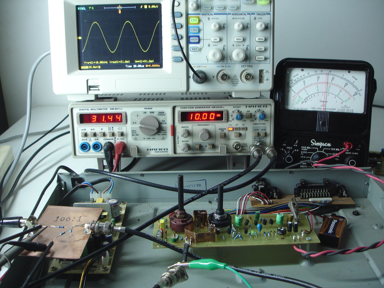

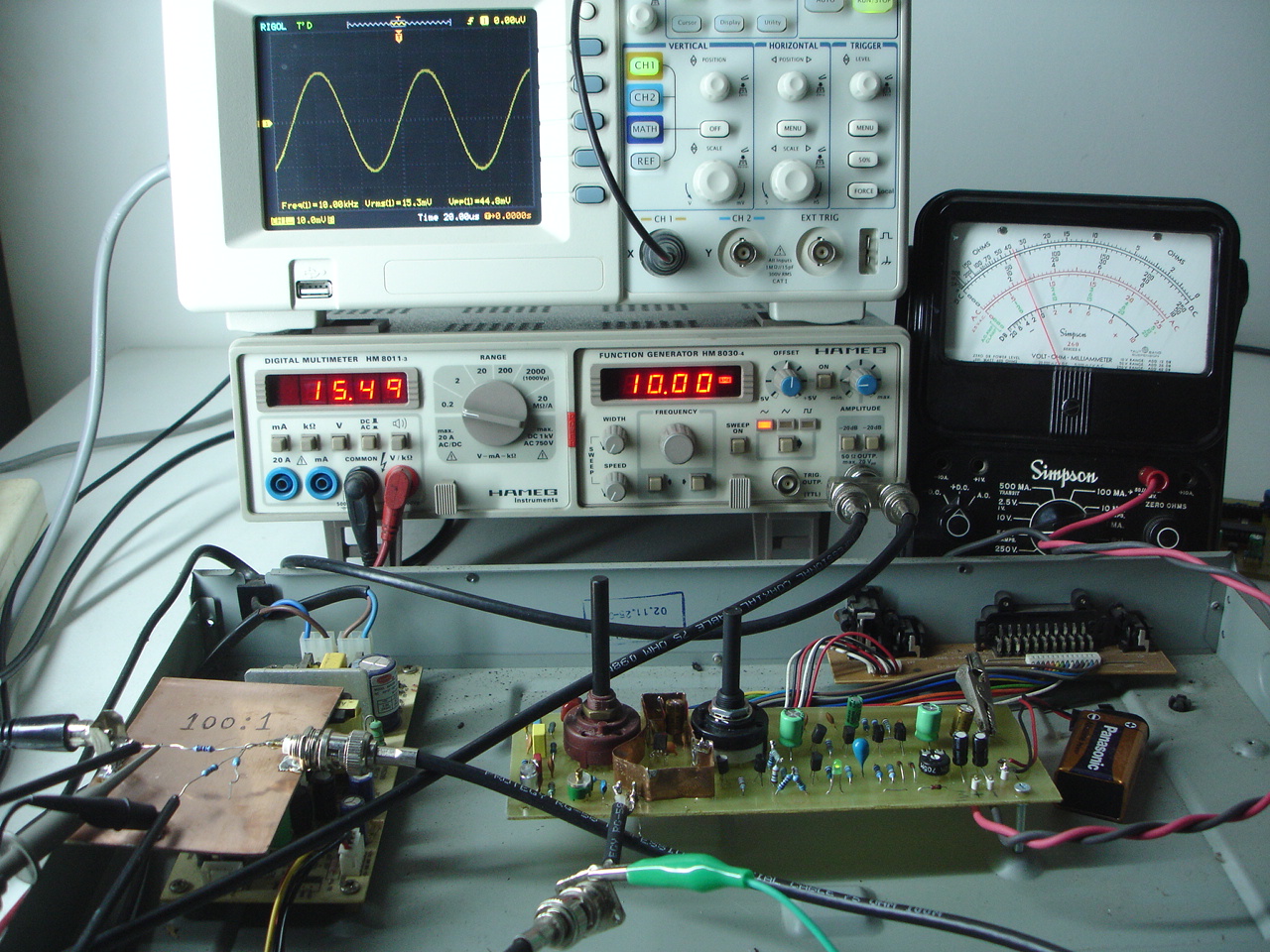

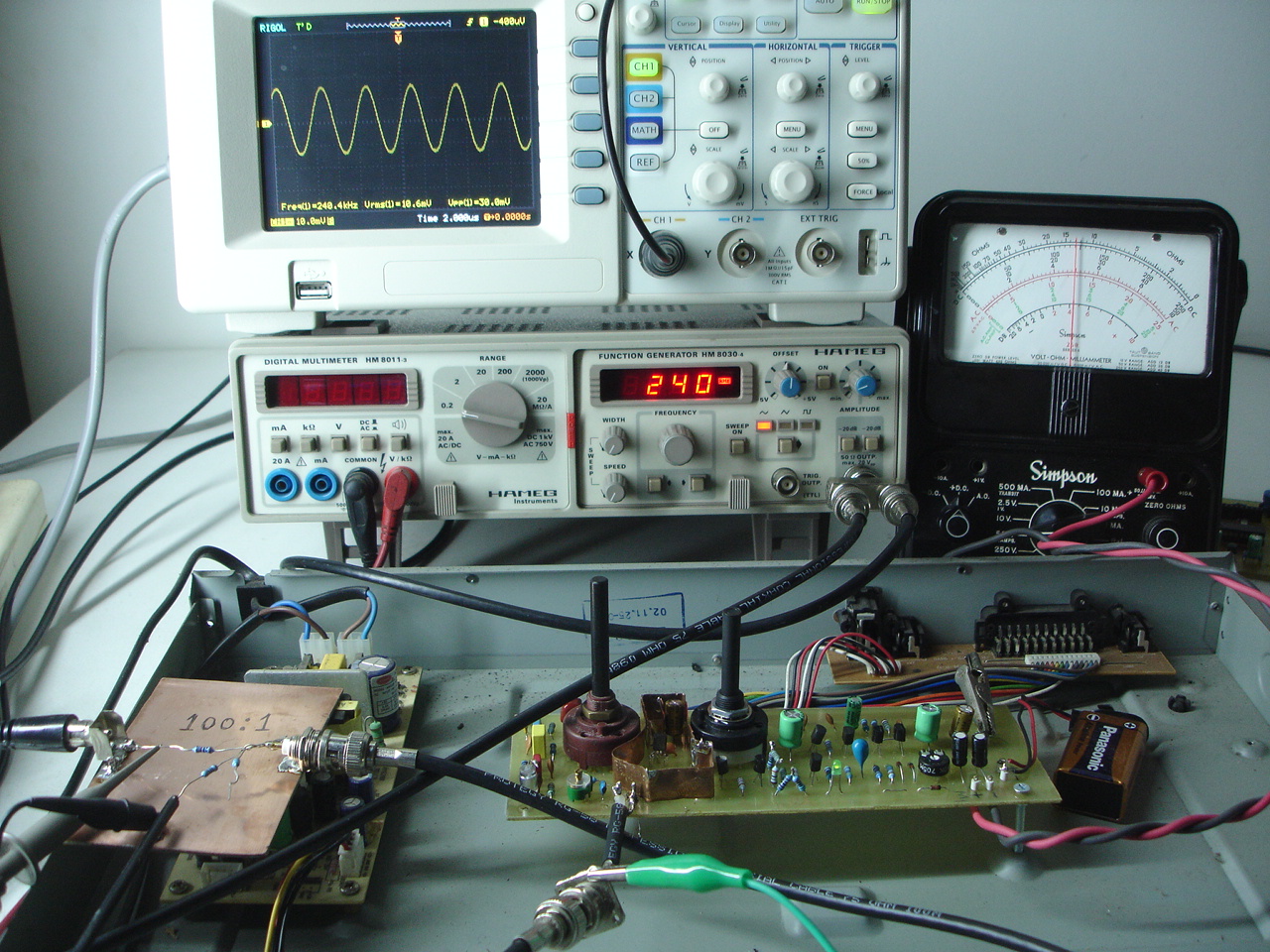

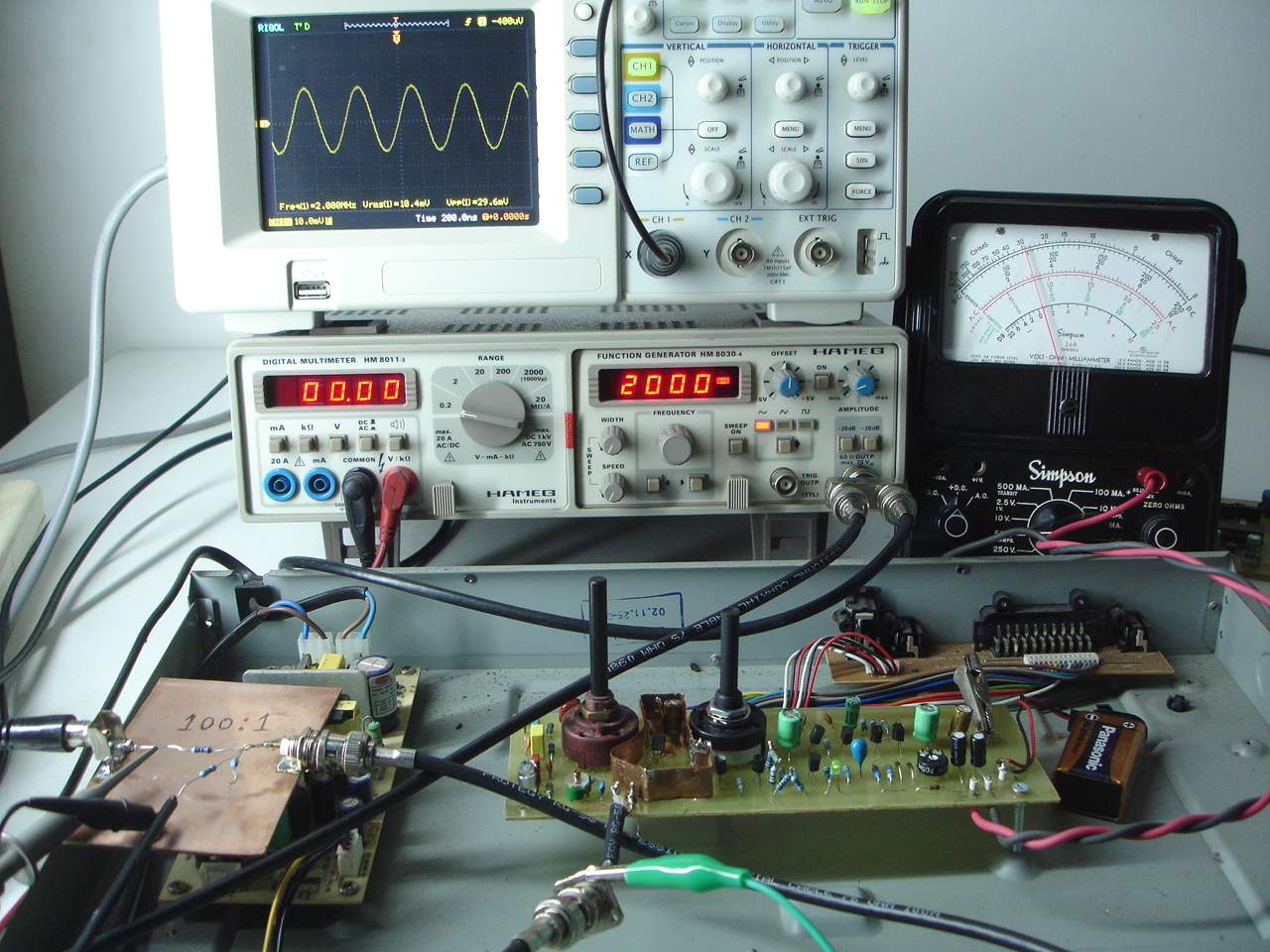

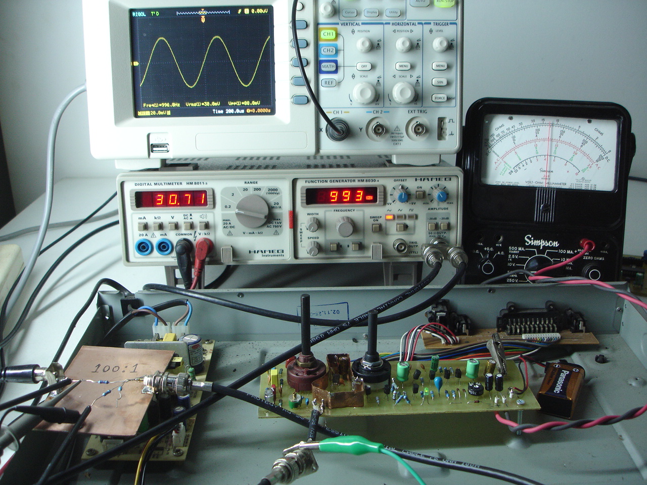

Checking the low scale 200 mV & 600 μV
A divider 100:1 used.
What you see on analog voltmeter is that you see on scope divided :100
Picture1,2,3,4,5 scale 200μV.
All other pictures scale 600μV.
