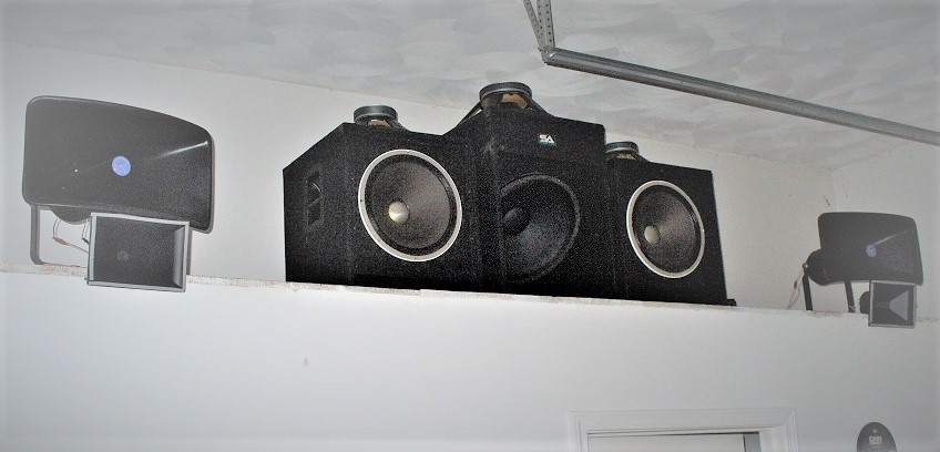

Loudspeakers are chosen for clarity, range, efficiency and dynamic capacity, along with durability, compatibility and affordability. Room decor is not a factor, though with rearrangement and some faux cabinetry the exact setup desribed (minus the sub perhaps) could be made so. Their cost was ~$1800, dominating the cost of the system.
Subwoofer (1): A Peavey 18" Pro Rider is mounted in a Seismic Audio 18" downfiring sub cabinet with internal crossover bypassed. The result is a tight, smooth and efficient subwoofer that functions nominally from 60Hz on down. Its basic purpose is to relieve the bass drivers of the longest-throw frequencies, as their xmax is limited.
Woofer (2): Each woofer consists of a vintage Altec 421A mounted in a Seismic Audio 15" cabinet, again with internal crossovers bypassed. Each runs from 60Hz to 200Hz. The sound is pure Altec, tight and smooth. They are of course efficient. They cost ~$100 each used, were not recones, and worked perfectly.
Midrange (2): Each mid is an Atlas CJ-46 reflex horn loading an Atlas PD5VH driver, used over a remarkable 200Hz to 3kHz thanks mostly to the very long path length of the horn. The driver, rebranded, has been used as the mid driver of the Klipschorn. Despite its 'stadium' appearance, the horn/driver combo is clear and smooth and enables a choice of amazingly low high-pass points, which is what drew me to it. I frankly didn't expect it to work this well in a hi-fi application.
Tweeter (2): A Klipsch tractrix-hybrid horn, used recently in 'home theatre' speakers until replaced by a newer version and sold off at ~$35 each, has had its Klipsch driver replaced by an Eminence N151M-8 ring-radiator. An 0.47mF film capacitor is shunted across it to suppress residual RF from the class T amplifier, mostly to make scope readings clearer. Its minor effect on phase is compensated elsewhere in this writeup.

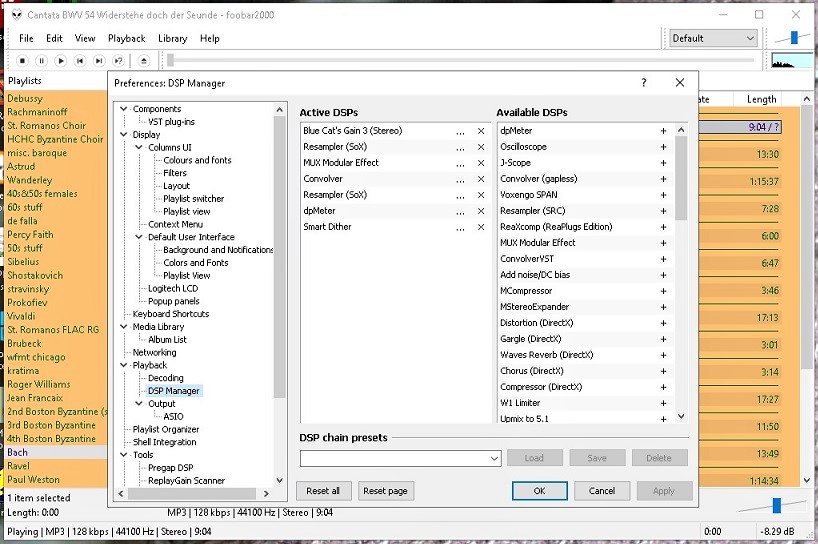

a. Front End
The purpose of the front end computer is to supply source material, process it and send it to the outside world as an SPDIF stereo signal. Foobar2000 is the vehicle of choice. Source material is kept on an M.2 PCIe-adapted NVRAM storage disk (except for that which is directly streamed from the web). This includes downloads, CDs etc., all of which are converted to FLAC for storage. The DSP stack has, in order,
i. Blue Cat's stereo gain module (to drop source levels ~8dB),
ii. Sox resampler to upsample for signal processing,

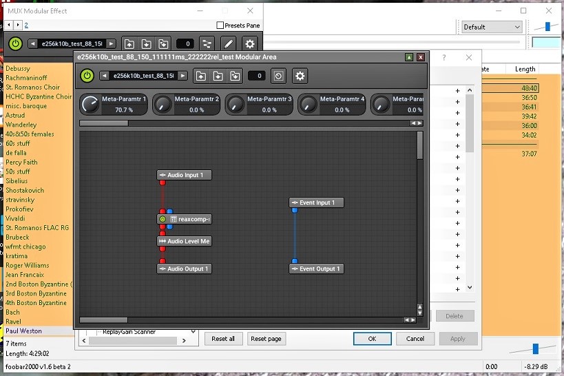

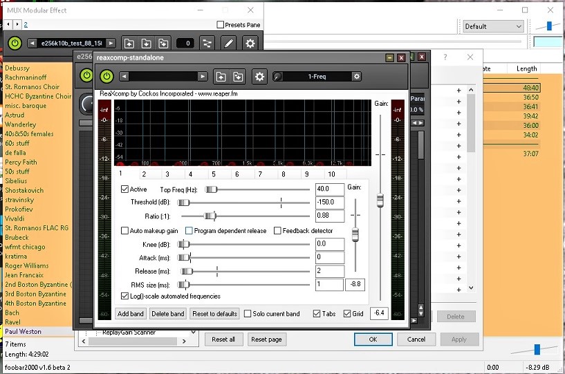

iii. Mux Modular, used solely as a wrapper for Reaxcomp which exhibits some instability in foobar otherwise. Reaxcomp, a compressor, is instead configured as a 10-band expander to restore dynamics, bands set from 40hz on up in octaves. The ideal would be of course one band per frequency, which is impossible for a number of reasons, but division into octave bands minimizes the dependence of a high frequency's expansion on a much lower frequency's level (since the former rides on the latter).
iv. Foo_convolve, the native Foobar convolution engine, which applies equalization from a curve built in RePhase (note foo_convolve seems to prefer stereo impulse files),
v. Sox resampler to match output to the data link sample rate, and
vi. Smart Dither set for 1 bit, 24 bits depth.
The output stage uses DS or WASAPI with copious buffering (latency is not a concern). A number of other (advanced) parameters are set to what seem optimal values (buffering, priorities etc. etc.). The resulting SPDIF signal exits the machine on the Sedna card's stereo coax output.

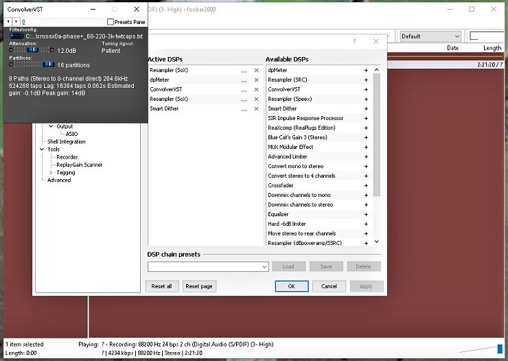

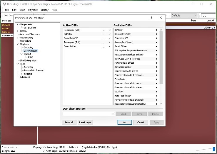

Here, the CM8828 sound card is used on both ends, acting as default input on its optical-in and as default multichannel output on the 7.1 (analog) outs. Output is configured for 7.1 surround, perfect for a 4-way crossover with a single sub, all output channels set for full range.
The DSP stack of Foobar2000 is loaded with Sox resampler (to upsample for filter processing), ConvolverVST (to provide 8 filters), another Sox resampler (to downsample for the output driver) and Smart Dither. "Foo_record" plugin permits Foobar to play the default sound input (in this case the optical input of the Vantec). ConvolverVST needs more clarification. Besides housing 8 separate mono brickwall filters, its configuration text file also provides
i. 2-to-8 channel multiplexing and mapping for the outputs to the sound card,
ii. precise delay for each channel, critical in eliminating propagation delay from the loudspeaker array, and
iii. a variety of other things I don't use but you might like.
It is set on my machine to 16 partitions and 'patient' tuning (beware... you may have to set tuning one level higher during initial configuration to end up with 'patient'... it is a bit high-strung but worth the effort). Depending on filter size and tuning level prepare for a long initial optimization delay but a good deal less on each startup after the 'wisdom' file has been written to desktop (which it is every time foobar is closed smoothly). The author of the plugin recommends 'measure' tuning (one level lower than 'patient') and you may like the sound and appreciate the much faster optimization time.

Clipping avoidance is important anywhere on the signal chain. To this end, recordings are conveted to FLAC (to save space over WAV files while maintaining lossless conversion, and in the case of lossy downloads, to avoid further signal loss) using Alternative Replay Gain set to 'prevent clipping according to peak'. Sox upsamples to 384ks/s during this procedure, using an option in Replay Gain. Despite extant information indicating that Replay Gain must be set during playback for decoding, my testing indicates that the track is indeed moved below clipping levels with no decoding required at playback (indeed, the option to 'Remove ReplayGain Information From Files' is greyed out for files recorded in this fashion). All this is good for me since I haven't heard a limiter I like. I don't know whether this behavior is an artifact of using Alternate Replay Gain (which I do) or not.
The 'declipped' source material is dropped by 8 dB or so using Blue Cat's stereo gain (which tests phase linear on VST Plugin Analyser) since the next step involves dynamic expansion. Reaxcomp is my choice, carried within Mux Modular (itself a VST which tests phase linear) for stability. It is configured for 10 octave bands of expansion as mentioned earlier, the rest configured minimally with 1ms RMS size and 2ms release, attack and knee left at 0. Threshold is maxed at -150dB and ratio set at 0.88:1 (expansive). It is tuned on VST Plugin Analyser. Bands begin at 40hz. Phase is measured and minimized via manipulation of the per-band gain controls. It takes a while, but phase is constrained to +/- 1* over about 50% of the usable audio spectrum and +/- 2* over nearly the whole thing. 3* is never reached except at very low frequencies. For some reason distortion measurements come out best at sample rates of 128 or 256 ks/s (literally, not the powers of 2) at below -120dB THD/noise. I don't know if that's an artifact of the VST or of the test vehicle, but I currently use 352.8 ks/s as my processing rate. Reaxcomp has metering for checking input/output levels. Not knowing its format (RMS?), I try to leave about 6db of headroom on output for loud tracks.
A note about meters: RMS metering, while of interest to speaker and amplifier manufacturers, is worthless for this exercise. You need a fast peak meter. Acceptable RMS levels will do you no good when your cymbals, superimposed on a huge bass wave, are being sheared off.

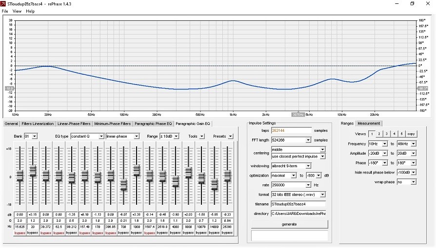

Next comes foo_convolve, which carries the equalization curve. It requires no phase testing (VST Plugin Analyser can't test it anyway) as the impulse it processes is generated in RePhase as a phase linear FIR with 352.8 ks/s sample rate. RePhase offers a wealth of options for windowing, tap number etc. etc. Find what you like best. I use 256k taps (as the power of 2) with 2x the number of ffts (automatic in RePhase).
Note: the Sox plugin contains a filter but it is also a FIR which can be set to produce linear phase, and is perhaps bypassed by going to 99%(?). It will also suppress aliasing and imaging if so desired (certainly a good idea on the possibly base-changing initial conversion of source material).
Sox resamples back to 88.2ks/s for output to the sound card. Foo_dsp_dither (Smart Dither) is used as mentioned; it is optional but I recommend trying it (why not, it's free). And so we exit the front end without clipping, having done due diligence with various available peak meters. It is worth mentioning that foobar has a native peak meter under visualizations, operating at the output but not pluggable into the DSP stack. We also exit with darn near phase linear processing, the worst offender being the expander as mentioned.

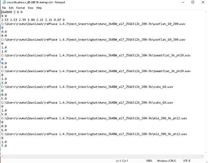

All of this is done by ConvolverVST via its config text file. Since there is only one subwoofer its two channels are summed to one for 7 actual outputs (also in ConvolverVST). Clipping avoidance and linear phase are of course as important here as on the front end.

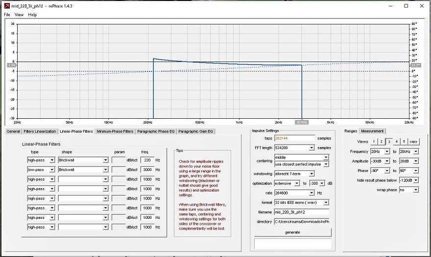

The filters themselves are generated in RePhase as phase linear FIRs with the same number of taps and ffts as on the front end's loudness curve. Crossover points are 60hz, 200hz and 3khz. The filters are brickwalls. If a driver requires some equalization it is done with an overlay of the curve onto the filter. Moreover, since RePhase permits phase equalization, phase slopes are included in the mid and tweeter filters to compensate for measured deviations from linear.
Sox is again used to resample to filter rate (here 264600ks/s, or 6x44100), then again to output driver rate (88.2ks/s). Peak meters are used as in the front end against signal chain clipping.

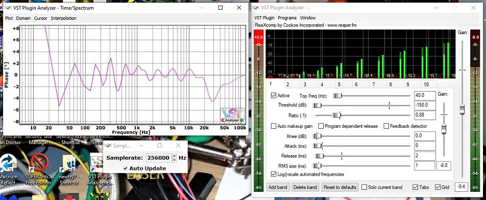

Dynamic expansion is something I've always liked. I built expanders in the 80s for my analog system. The problem being served is that most loudspeakers, microphones, anything mechanical, will impart some sort of compression to recorded sound. Additionally, much music is recorded with a lot of intentional compression for a variety of reasons. Playing through an expander (especially a multiband expander), properly set up, produces to my ears more lifelike sound.

the loudspeakers

expander on front end
curve in convolver on front end, shown in RePhase
expander under test in VST Plugin Analyser, phase

convolverVST on crossover machine
convolverVST config file on crossover machine

the loudspeakers
foobar dsp stack on front end
mux modular on front end
dsp stack on crossover machine
midrange filter on crossover machine shown in RePhase.

In fact, it's better. I decided to 'expand' my multiband expander from 10 to 17 bands (incrementally, first 12, then 15, then 17). The 17 bands each comprise about 0.58 octaves. Phase and magnitude linearization become touchier the more bands you add; the current model has swings to +/- 4*, though the majority of the usable frequency range is less than +/- 3*. I also decided upon the oddball 256.4ks/s sample rate since that gives the best distortion figures, and it's doable with Sox resampler and RePhase filters. The result, despite worse (but still not bad) phase characteristics, couldn't be ignored --- the pluses of shorter frequency bands outweighed the minuses by a good deal. It sounds better than ever, and I know this because I still have every expander config I've made, each with its own long babbly title, and can A/B with the earlier models. It was worth every hour. How I wish my sound card hardware had arbitrary sample rates too, but Sox is so good it's pretty much a wash. The improvement is stark, in fact. Even a few vocal recordings that seemed hopelessly sibillant are smoothed considerably without resorting to notch filtering. And to minimize the amount of resampling I reran my 'room curve' on rePhase at 256.4ks/s also. It's endless hair-pulling and endless fun.
All processing is an artifice anyway. The major 'trick' to removing artificiality from expansion appears to be the narrowing of bands. At a point this collides with less manageable phase at least on reaxcomp (which is, after all, a freely-offered plugin).

Leoman, how are you able to use Atlas CJ-46 horn down to 200hz when the datasheet freq response clearly shows that it's good around 700-5khz?
Hello noviygera, I saw the same graph you saw but also saw horn loading to 115Hz so I decided to get a horn and test it (I already had the drivers). I had been using University Cobreflex II horns at 340 Hz (well below the 400 or 450 University had used in their Classics) and was looking for a horn with lower cutoff. What I saw actually stunned me. There was mild smooth rolloff on good-looking sine waves as I went below 300Hz with the Atlas, but I didn't expect to get to <180Hz prior to seeing the sudden appearance of what looked like 2nd harmonic (or possible reflection? It's been over a year) appear on the scope, though that was not audible. I immediately ordered a 2nd horn. I decided to use 250Hz to leave slack for complementarity, but found that the setup simply sounded better at 200Hz. The rolloff was easily manageable in the crossover curve.
I don't know how to explain Atlas' graph except to suggest that perhaps at 15W, which I doubt I ever approach, things are different? My 'listening area' is about 45'x28'x12' but I use very little power to drive them up to uncomfortable levels for me. My shelving is done with a mike and scope, and things are pretty smooth on sweeps. I know that the horn is marketed and heavily used for applications not generally employing crossovers or other speakers, so I'm quite certain it produces strong output well below 700Hz.
Chris661, I'll take your word for that. Experiment is always better than literature anyway, IMO.
...how are you able to use Atlas CJ-46 horn down to 200hz when the datasheet freq response clearly shows that it's good around 700-5khz?
It is a long horn with a small mouth.
The driver is well-loaded down to 200Hz. But the directivity does not come up until 500-1kHz.
If you use it outdoors, the 200Hz goes all around and is lost.
Indoors the lows are contained and propagate quite well.
