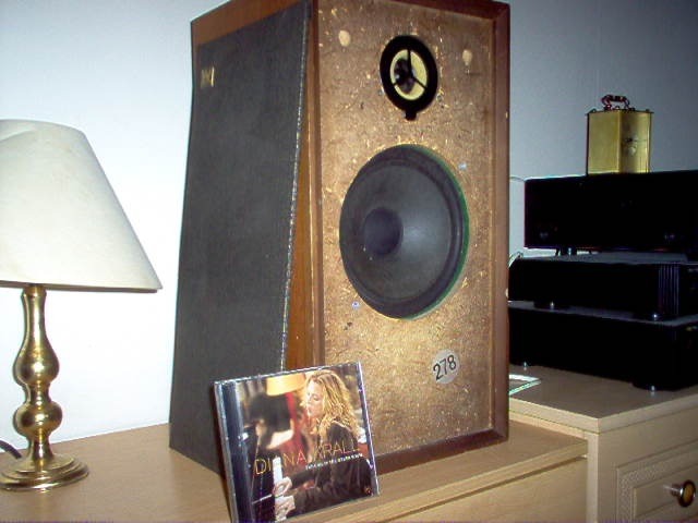

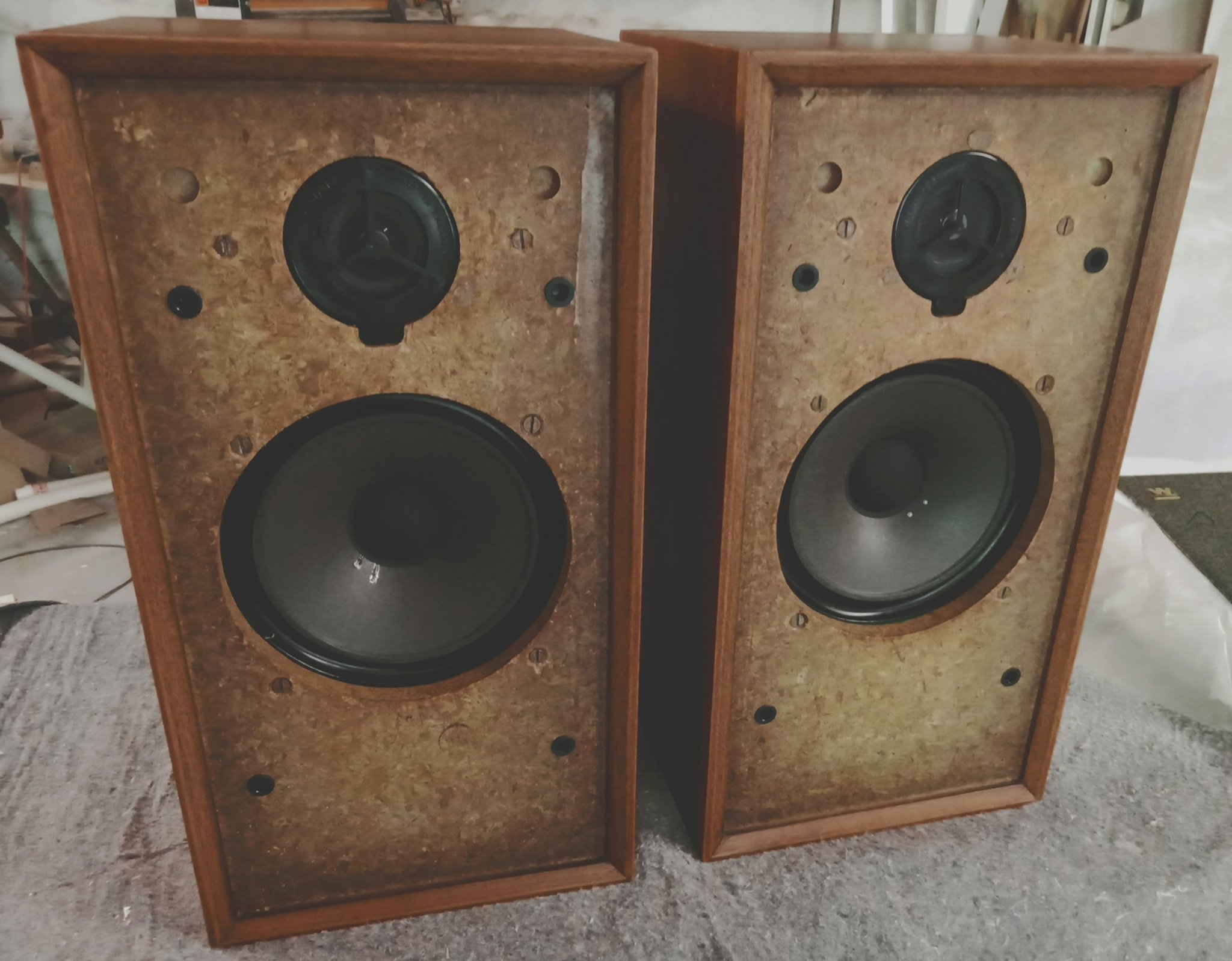

What Glee I felt when my local Charity Shop offered a pair of Wharfedale Super Linton loudspeakers for a mere £30! Supposed Classics from the early 1970's!
As an expert in cheap two way loudspeakers, I thought I would breeze through this. How WRONG I was, how HORRIBLY, HORRIBLY WRONG!
First off, the 5.8R tweeters were wrecked:
Interestingly, the Wharfedale Purple Jellyfish tweeter bears a passing resemblance to the Henry Kloss Fried Egg tweeter.
But since they were fried, I lost interest.

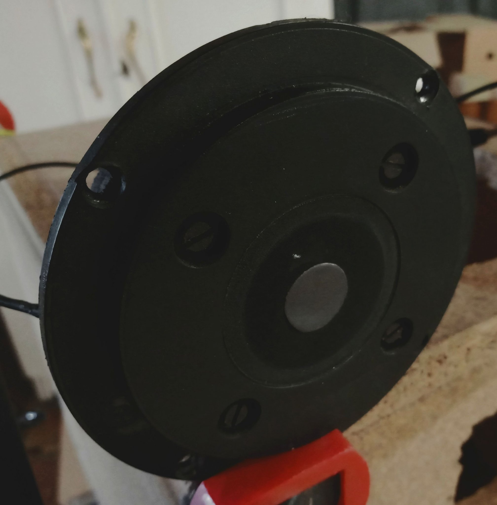

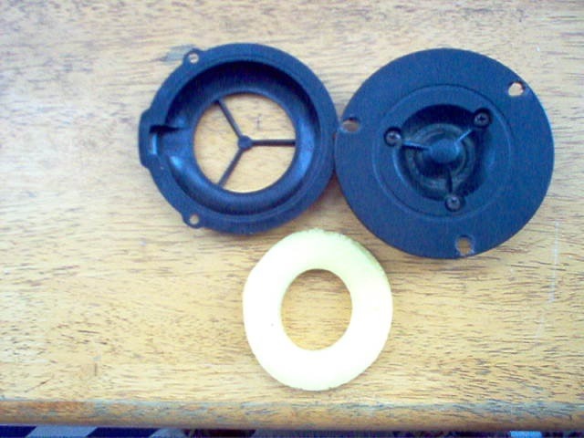

Decided to replace them with Visaton DT94-8 91dB mylar tweeters:
After some thought, I added a foam ring surround:

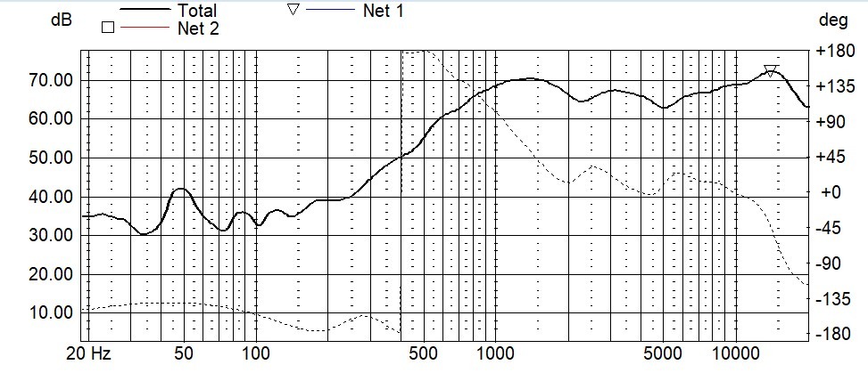

All went swimmingly well with Miss Diana Krall playing Jazz. Alas Leonard Cohen wrecked my Party with his bassy efforts. Sounded horrible! All distorted. Voice-coil rubbing I think.
I concluded that not only were the tweeters fried, but the 4.1R basses were wrecked too!

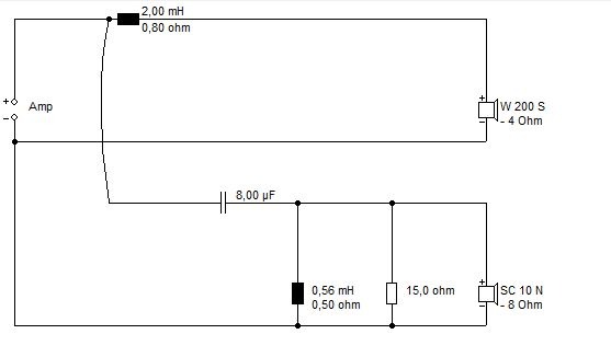

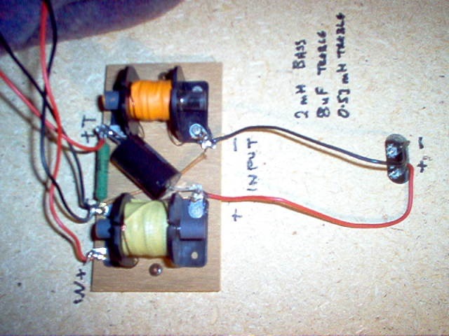

For the interested student here is the simplistic filter:
I swapped the 8uF for a more sensible 4.7uF.

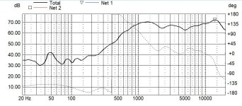

Only salvage I can think of is to fit some new Faital-Pro drivers:
https://www.bluearan.co.uk/index.php?id=FTP8FE200AF
Problem being the cutout on the bass is 178mm and maximum diameter allowed is 222mm. I can doubtless find another 91dB tweeter somewhere.

The Faital Pro woofers do look nice. They have a good bit of sensitivity, but you may need to give them a ported enclosure.
The cabinets / enclosures are fine, no damage?

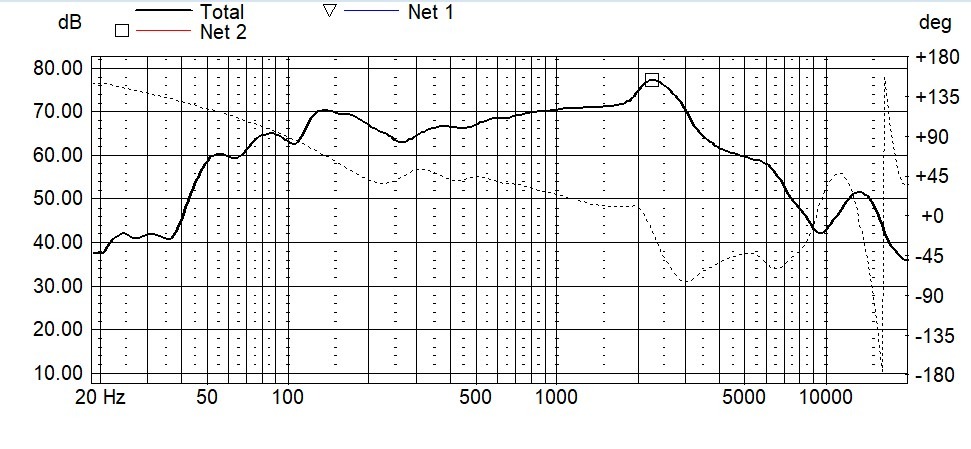

...about 18 months ago I did work a similar pair. the woofers were fine but the tweeters blown. In the spirit of retro I used a pair of AD 0160 mounted from behind and got a super result. X-over was changed to suit and the cabinet braced.
Hello bbe22

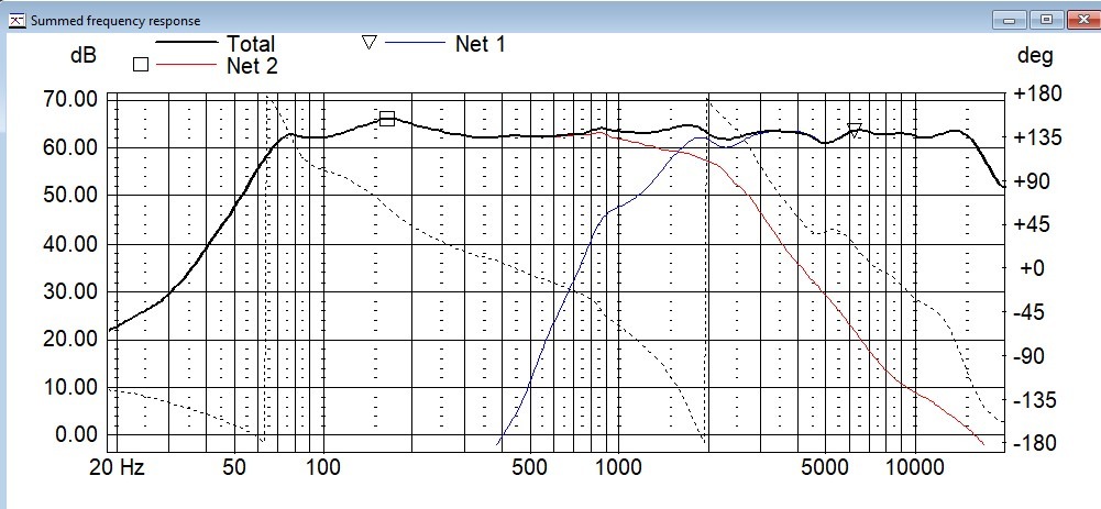

Good job. The LspCad graph looks super smoothened.
Do you happen to have unfiltered, unsmoothened in-box measurements of the (thus raw) woofer and tweeter on a 5db/Div scale?
Hi Boden I am comfortable working in 1/6 th smoothed (so that's how I measure) and on sim on a 70 dB Y axis. Now one can debate the merits of my choice for sure, but , I seem to get reasonable results. So sorry do not have those for you 🙁
Yes. Thanks.

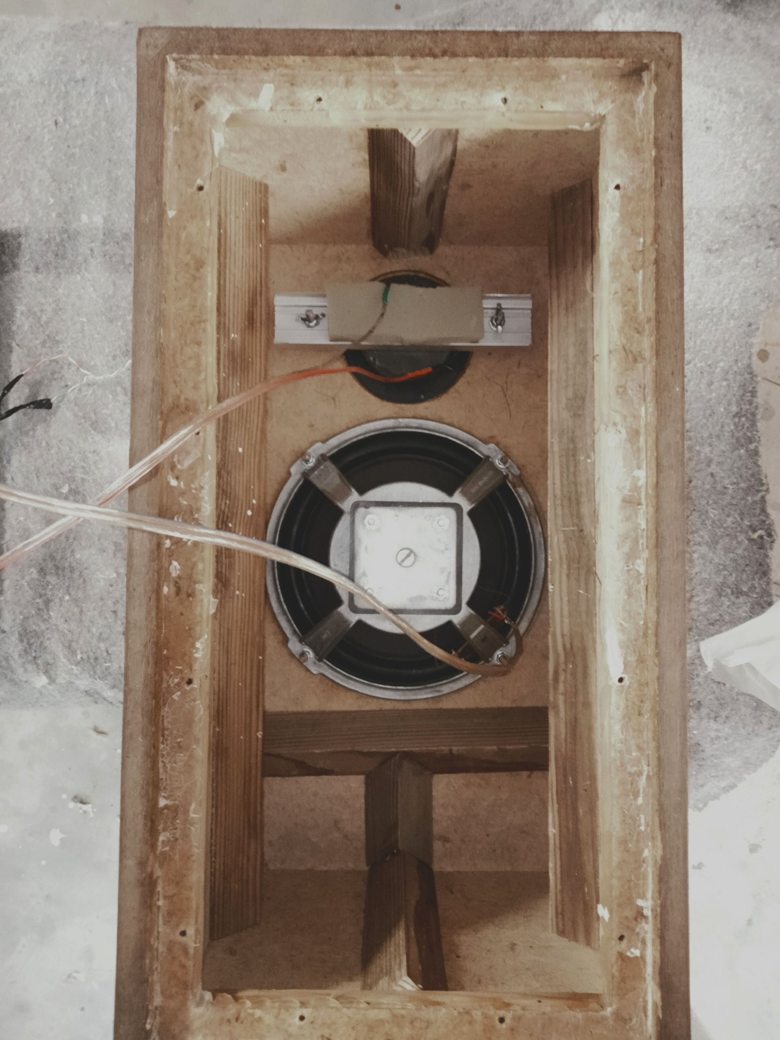

I presume these to be the Super Linton W30D.
I read elsewhere that the old alloy basket, square magnet Wharfedale woofers can be disassembled from the back (magnet kept in place by four bolts and an adjustment screw in the middle), so you may be able to inspect and re-align the voice coils.
