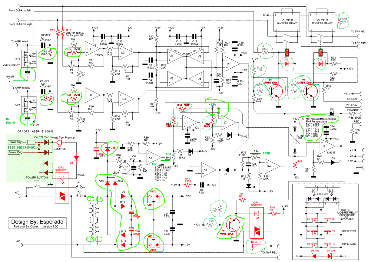

An ultimate amp protection circuit ?
version 3... check for values pls.
Here they are.
The two diodes Z1, Z2, protecting the power mosfets can be replaced by a Varistor,(depending of the voltage of MOSFETS used, what do you think?
Some color changes, to allow more choices, like impedance values for input preamp, transistor, to can use any ones diyers can have.
Some errors in resistances values, corrected, one path too.
If changes of colors bores-you, i can do-it myself on your image.
Changes are outlined in green.
