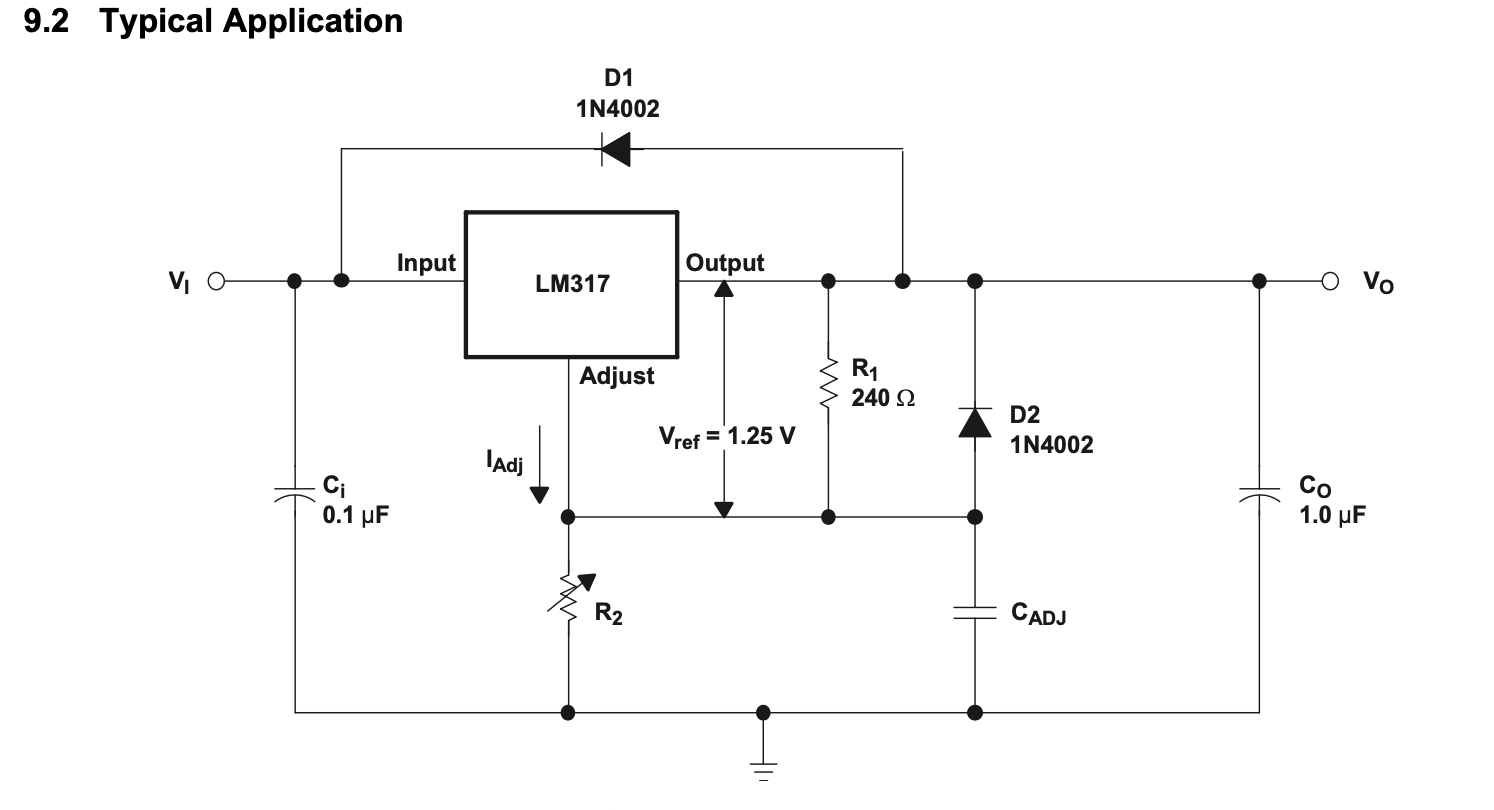

An rc filter at the output of lm317?
The regulators must be decoupled as per the data sheet recommendation to preserve stability.
Adding any 'R' after the regulator totally negates the whole point of having a regulator in the first place because now the output voltage is modulated by load current.
Also adding large amounts of 'C' after the regulator destroys its transient response to changing load currents.
A low value capacitor from pin 2 to ground is all that is recomended for stability.
So i had crcrc filter from the output of 317/337 into an opamp circuit, the filter values 10r and 1000uf. I have to admit despite the technical objection the circuit sounds better with the filter than without. The 317/337 regulator circuit by itself is very robust and stable, btw.

The LM317 and 337 do NOT need any output capacitance for stability -read the datasheet; and it's true from experimentation.
The input side cap is more important than stated, measurement suggests that c.100uF is better than 10uF is better than 0.1uf stated minimum. There are really, really good reasons for that also - the Errol Dietz paper, originally, that demonstrates that output loads are reflected at c -20dB to the input side capacitance. If you have freedom to design that layout, the '0v' end of that input cap - decopuled from raw PSU by a dab of L or R - can then be returned to 0v near the load - and then good things happen, because you've closed Kirchoff's loop.
There is also a minimum value for ESR in the output capacitor to ensure the regulators inductive output Z is at least critically damped in the resulting potential series LRC circuit. Use low ESR output cap and risk noise peaking. A subsequent RC filter could reduce this noise but best to deal with problem at source.

My understanding is the input cap is more vital when the regulator isn't close to their power supply caps. Output caps having low ESR sounds worse and if larger caps (than 0.1uF) on the input then a diode benefits from input to output.
My experience is thin though and interested in peoples experience
Some manufacturers LM317/LM337 are extremely noisy, lots of low frequency flicker noise.
I see some designs stuff a large say 1,500uF capacitor on the output of the vreg to mitigate this and it does cushion some of it. I can't see a RC useful.
Stability requirements for some LDO's need R added but not the 317/337 as they are not LDO's which have a PNP pass-transistor.
