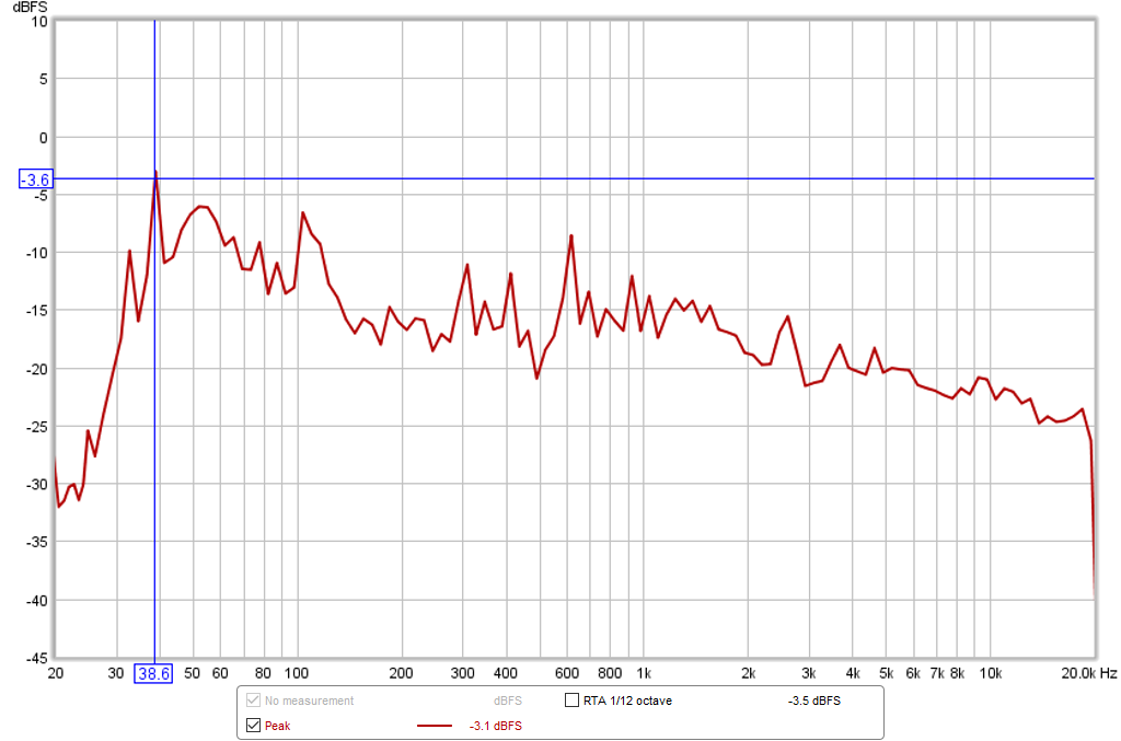

And peak near 85hz, then rolling..........
Yea, bass horn, hardly a subwoofer.......

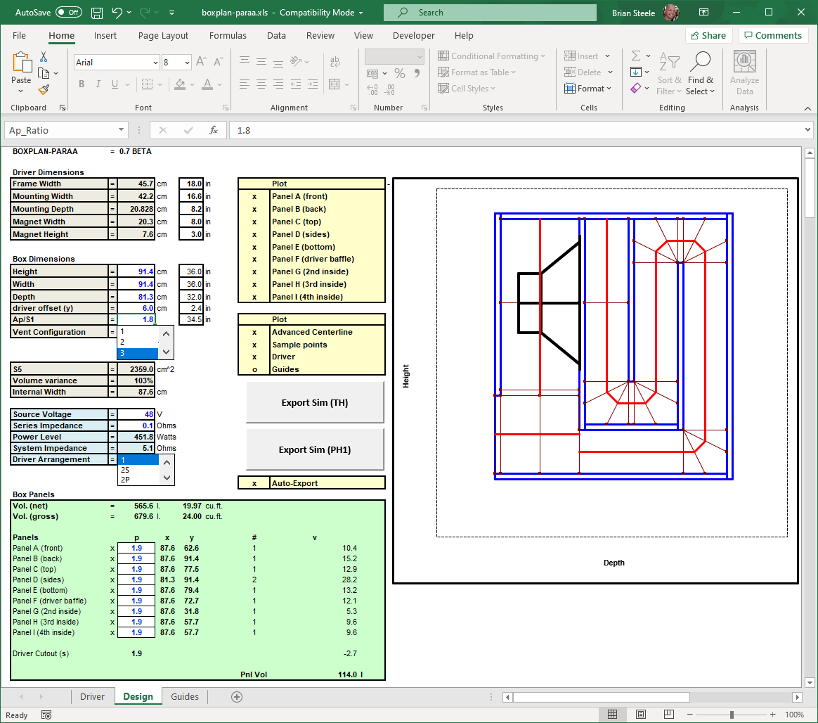

I had a chance to review. I think I might not bother to go with a redesigned "B1", but to go with a Paraflex Type A instead. Basically same performance at bass frequencies in a smaller box, and a driver that's better protected. I'll post a comparison in another thread later today.

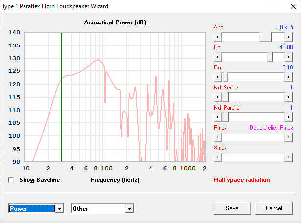

I'd love to do a 30 Hz build, but the problem is that when Fb goes down, so does power handling in the passband, peak linear SPL too, and the box size gets bigger. So it becomes a balancing act of deciding if going to 30 Hz will bring extra people to the club, and if not being able to 30 Hz would cause people to leave and go to another club.

I've managed to come up with a 30 Hz PARA-A design for the drivers that we currently have on hand, B&C 18TBX100. Unfortunately power handling drops to 450W in-band and the boxes are pretty large - 24 cu.ft. in total. The box is also an unusual shape - 3 ft. high and 3 ft. high, and 2.5 ft. deep. Probably not going to be the easiest thing to move around....

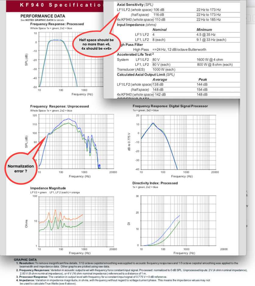

1. Bass horns do not couple well. 200hz, yes, zero coupling at 25hz, I can post the 13’ long eaw k940 bass horn 1 vs 4 freq response, otherwise 1 box of dual 12” = 113db 1w/1m (wow), box 4 boxes share 12db of boost better than 1 …………….
See my post #3 for their own freq response graph, nice to see some honesty.
how this design looks ( PI )
2. On the floor is not 2pi, that would require the bass horn exiting at the middle of a concrete wall. “I and djk chatted often and came to the conclusion of a 3pi for a horn on a concrete floor.
Not 4pi (free space) and not 2pi either.
So the mouth area (ideally) is half way between 4pi and 2pi.”
3. Ideally, the length of the horn is ½ octave lower than the mouth, so for a 100hz horn, it should be ¼ wavelength of 75hz (3.75’).
4. Usually bass horns end up with a horn with way too small of a mouth, so we get big ripples in the low response.

1) You found an EAW spec sheet with some mistakes, and have made incorrect conclusions based on it. The indicated sensitivity of the KF940 is not consistent with EAW's usual conformity to the industry standard of adding +6dB to half space LF measurements, and also seems to have a normalization error in reporting the "2x2" configuration.

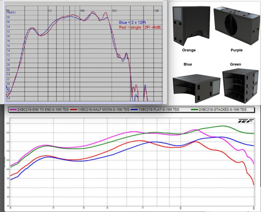

Attached are measurements of a single 12Pi FLH (Front Loaded Horn) compared with two, the overall response increases almost exactly +6dB as would be predicted (+3dB for doubling power, +3dB for doubling cone area and cabinet).
Also included is the DSL BC18, an interesting FLH that uses a large frontal boundary (BC=Boundary Coupled). The BC18 can be deployed with the frontal area Again, the overall response increases around +6 dB, though the increased boundary area of the "End to End"(purple trace) and "Half Moon" (orange trace) increase output in the low end compared to the "Flat" or "Stacked" arrangement. The top end of the response is considerably more sensitive in the "Flat" or "Stacked" configurations, similar to the upper extension seen in FLH like the KF950 or other folded horns that have increased upper DI (directivity index).
2) True, though the usual practice of also placing the measurement microphone on the ground plane ends up making a +6dB increase in level below around 100 Hz.

Whether the cabinet is FLH, TH, BR, PPSL or sealed, they all drop at 6dB per doubling of distance in the far field.
You, Norman, and countless others have mistaken room response variations (nodes, anti-nodes, modes) for cabinet differences. If the room sucks, it sucks harder with a louder cabinet ;^)
