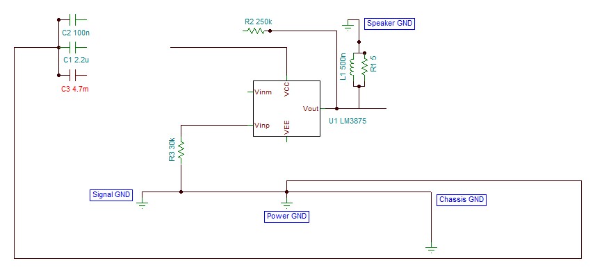

My Thiele network on the output looks like it will be 5nH || 10R.
5 nH?! That's 5 mm of PCB trace. That sounds awfully low.

The 5nH was a typo that should have read .5uH. The Thiele inductor value will rise the further we move from the output. Updated schematic.
You just shorted your output to GND through the inductor.
I have one question about decoupling caps, The LM3875 chip will have between 4 and 8MHz of bandwidth, the resonant frequency of 100nF should exceed this comfortably in theory but which kind of cap will do this the best in practice?
I suggest reading the Supply Decoupling section of my Taming the LM3886 website.
