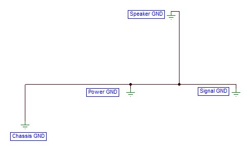

I am going to put this amp together in an unorthodox manner and start with the grounding topology. Tom is right to point out the final distortion numbers are likely to depend on how cleverly we can tie this amp together. While you guys look over the grounding scheme, you should start imagining the components working within it.
I suggest simulating the ground scheme. Include the supply capacitance (including parasitics) along with the impedance of the ground traces (at least the resistive and inductive parts). You can get pretty good estimates for those numbers from the on-line PCB trace and plane inductance and resistance calculators. I'll see if I can dig out a link to one.

Yes Tom, that was my next step after optimizing a Thiel network for the output. May I ask where you got the model for the LM3886? I will eventually need the LM3875 model and depending on the chip we decide to use for precision, I'll need those models too. By the way, I downloaded the TINA-TI package and it is is a treat. I have it running on an old celeron and it runs fine but strangely, I couldn't find any of the Analog Device chips in that package either. I'm currently playing with three spice modeling packages and can't make up my mind which to use. For the record, I'm looking at a 22V swing to get 30W/8R. How close to the rails should I expect to get when the amp is loaded? I'd like to completely avoid clipping this amp and none of my sources output more than 2V and they are all single ended so where would you set your input sensitivity (impedence)?
