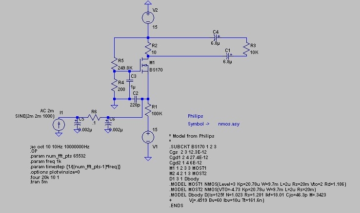

An IV amp using the BS170R mosfet
Hello
I've founded a bunch of BS170R mosfet, and I've found a IV amp schematic and mod it to use the BS170R mosfet.
It's for using it with the TDA1541A
It's not the Zen or a D1 IV amp but it sim good.
Any opinions, suggestions about it ?
I include an image of the schematic and the sim file in text form.
Thank
