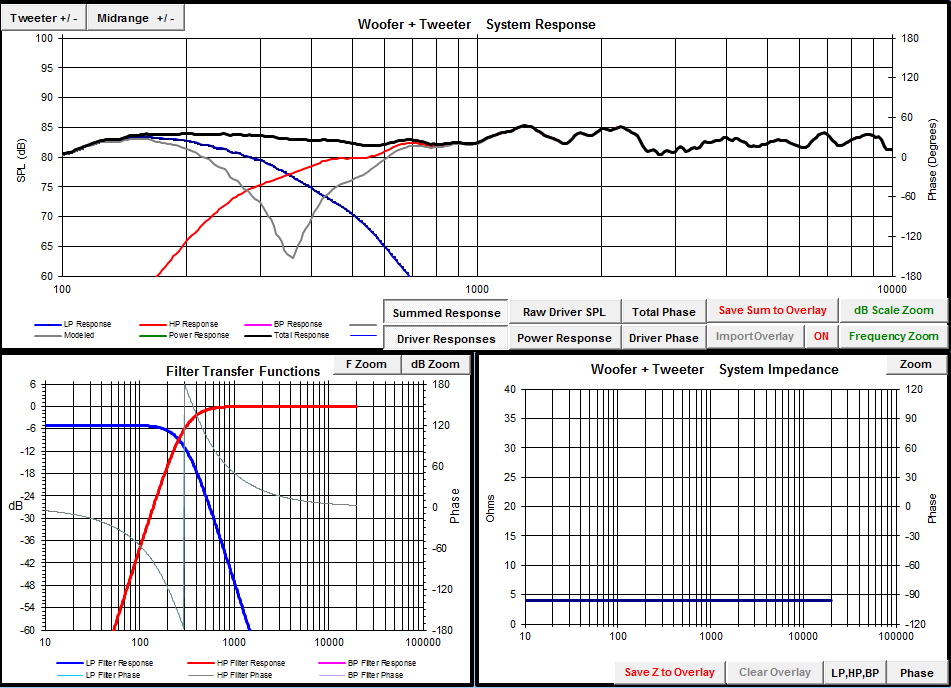

I don't have detailed measurements on this computer, but here is the simulation I ended up on. I haven't confirmed it worked yet. Hopefully over the Christmas break I'll get a chance to do more measuring of various projects, and I can confirm the model worked.
You can see in the transfer function that I have done any eq. Only level adjustment, and filters. Filters were 4th order each. Steeper than a lot of other FASTs. I nearly targeted 2nd order, and still might try that, but wanted to kill the woofer quick and save the little tang band from to much power. Plan to really run these hard. Already have 😀

I thought of that, but then they'd be at foot level, and I have a 4 and 2 year old who play a lot in that area of our house. I doubt the woofers would last more than a week. They're safe behind the screen, and quite point source this way too.

The measurements in my simulation are actual measurements. What I'm uncertain of is if the model is working in the cross over region.
And I say that loosely, as 9/10 the simulation works great.
From 500hz and up, it's real. You can see how flat it is. Stays within a 5db window. Sorry I cut off the 10khz+.

Sorry this took me so long. I'm rarely on my measurement computer lately. Someone asked about measurements. And hopefully this will help someone interested in the little TB. And the silver flute I suppose. I have better data than this on the SF.
Anyways, red is the system on axis. This is indoors so I don't have much choice than to gate out everything below about 200hz. 5ms gate time.
Blue is the woofer nearfield. It has a low pass of 300hz LR 24db/oct, so really anything past about 450hz is the tang band sneeking in there. Use your imagination and connect the two. Right at the cross over so don't want to splice them.
Really flat all the way up 😀 Listening to Miles Davis right now and it's so sweet.!
