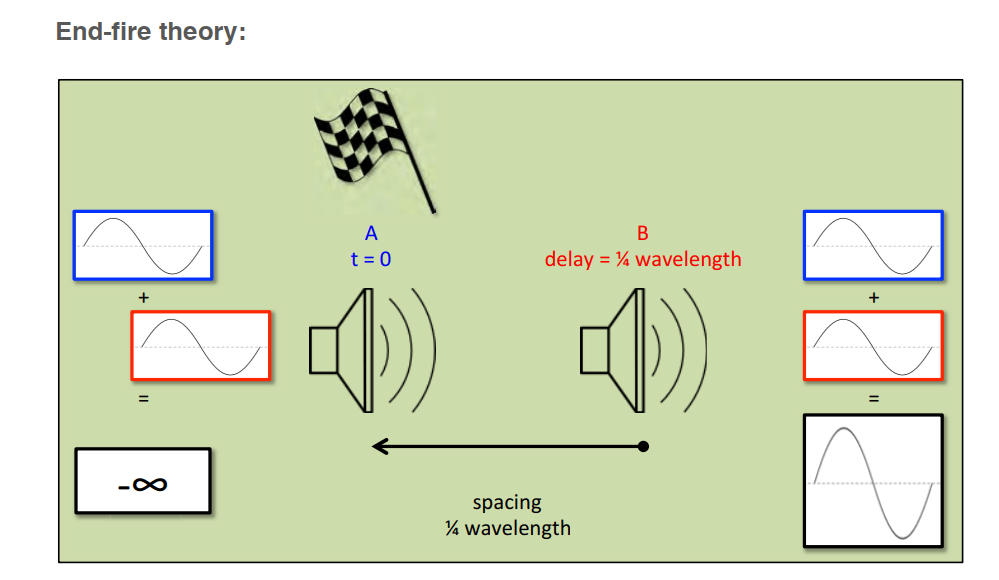

One popular way of doing cardioid subwoofers is "end fire." In an end fire cardioid subwoofer array, you put one subwoofer in front of the other subwoofer. You separate them by a distance and then you use DSP delay so that the sub in the front is delayed so that it's in-phase with the sub in the back.
This does two things that are really useful:
1) it makes the sound that's radiating towards the audience about 6dB louder over a limited bandwidth (because we've doubled the power and the number of speakers and they're in-phase at the audience location.)
2) At the rear of the end-fire-array, you can get a reduction in SPL of 10+ dB

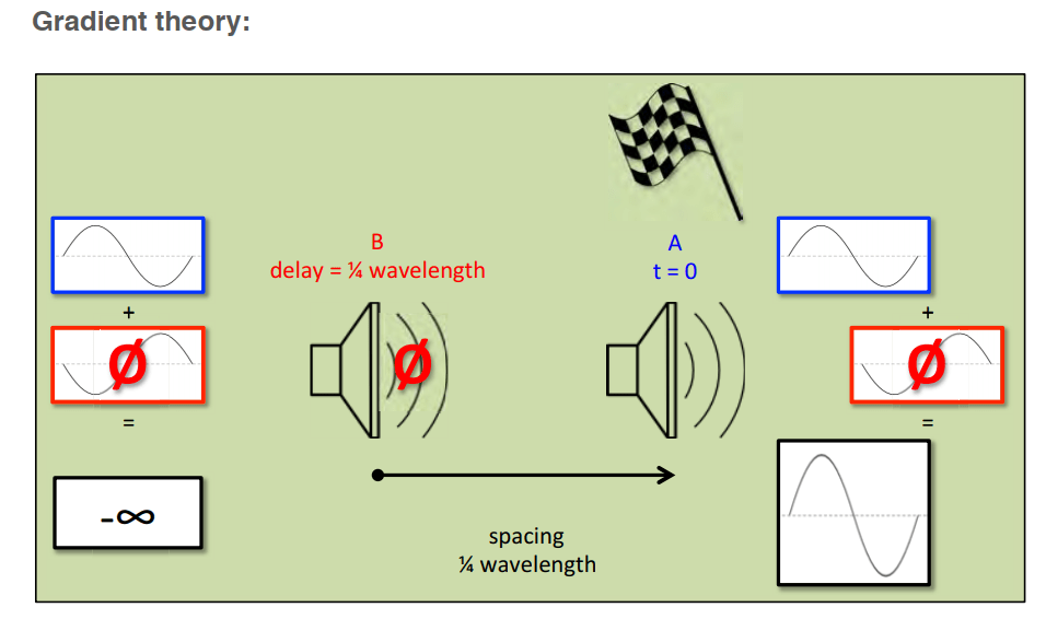

For today's thread on transmission lines, I think we're more interested in The Gradient Array.
A Gradient Array is basically an end-fire-array in reverse. (see : https://timobeckmangeluid.wordpress...reversed-end-fired-as-i-call-it-english-only/)
In an end-fire-array, the subwoofer in the front is delayed.
In a gradient array, the subwoofer in the BACK is delayed.
In an end-fire-array, both subs have positive polarity.
In a gradient array, the sub in the back has reverse polarity.
We can approximate a Gradient subwoofer array of TWO woofers using ONE woofer and some careful juggling of pathlengths and transmission line shape.

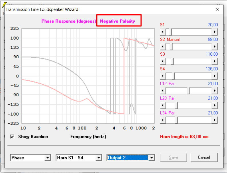

This is where stuffing comes in. I use the Hornresp Loudspeaker Wizard to fill the speaker with rockwool.
From the main menu of hornresp, select "tools" and then select "loudspeaker wizard." Then select the "power" menu and the "filling" submenu. Adjust the segments to reflect the filling of the horn.

Using hornresp, we can see the frequency response and group delay of the output from the woofer AND the tline seperately.
By doing so, we can see that the output from the tline is about one millisecond "behind" the woofer in the octave from 300 to 150Hz.
Sound travels 34 centimeters in one millisecond; this might be why the vents in the Dutch & Dutch 8C are approximately 34 centimeters away from the woofer. (Note that you have to measure from the center of the woofer; the cabinet is 48.5 centimeters wide, so the wavefront travels 24.25 centimeters just to reach the edge of the cabinet.
The output of the tline is about 10cm back from the baffle, and now you know why (IMHO)

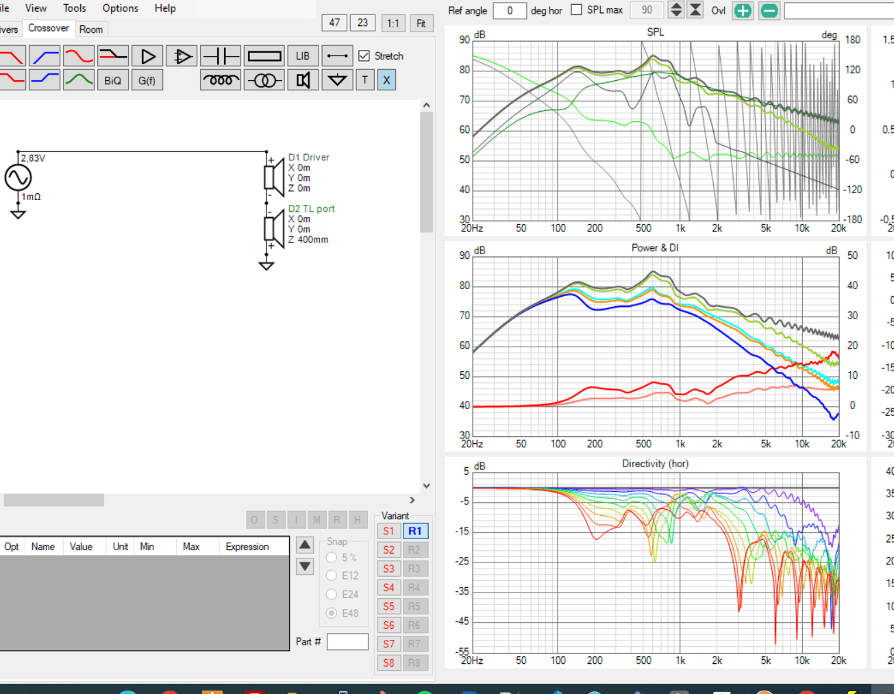

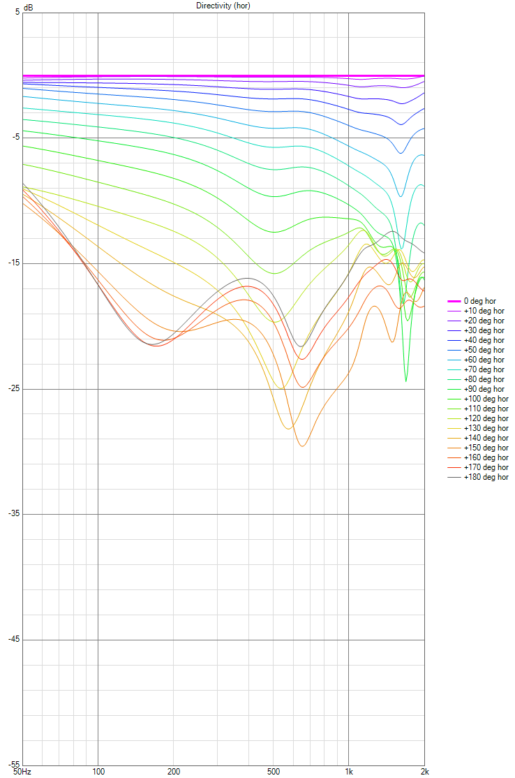

Hornresp can't do polar sims of this tline.
My idea of doing a passive gradient was based on the fact that the ouput from the vent of the tline is definitely delayed, which is what we want for a gradient cardioid woofer.

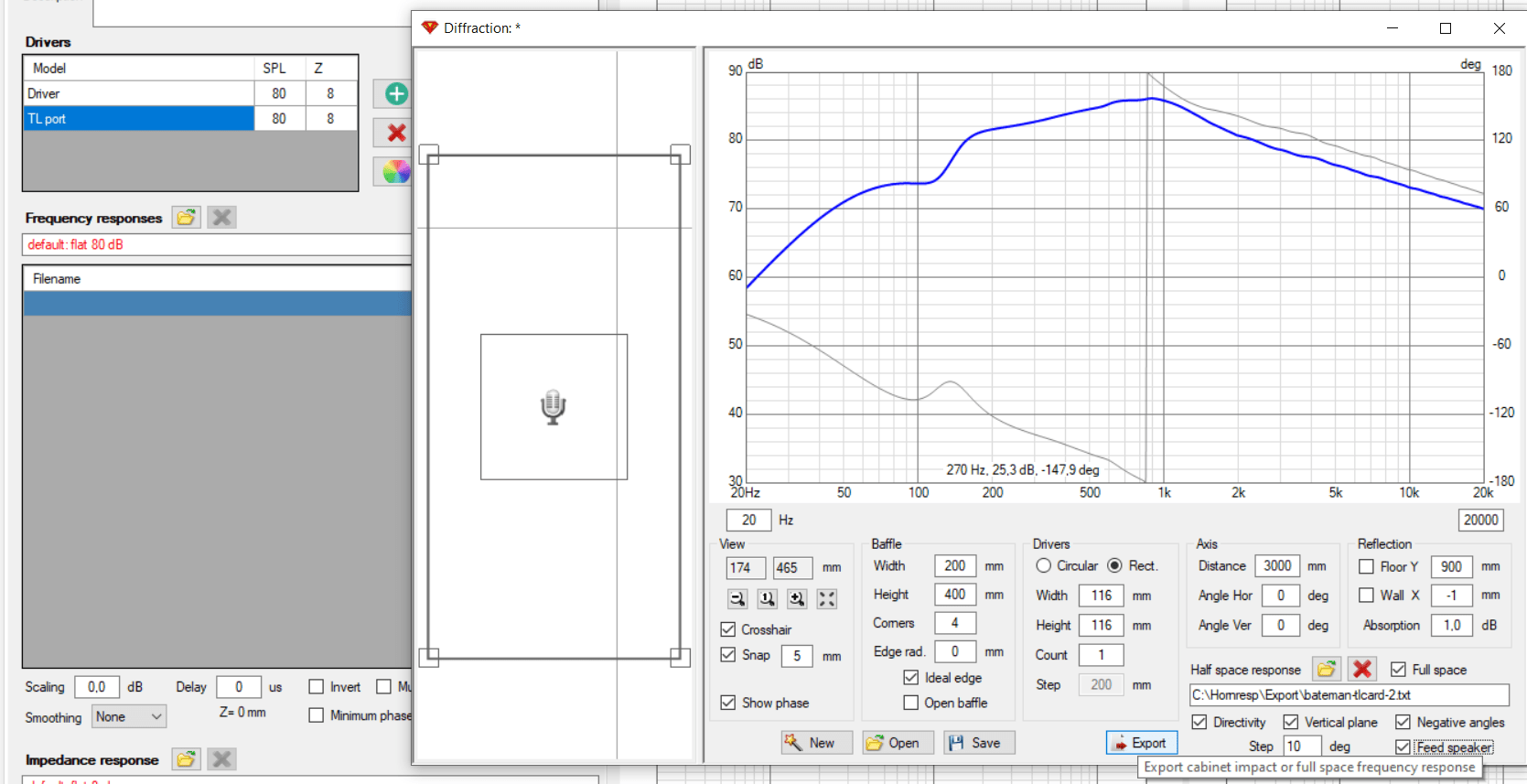

In order to do something approximating "a proper sim", we need to get the data into Vituixcad.
We do this by going into Hornresp, selecting the "Loudspeaker Wizard", selecting the "Memory and Width" option and then "Export Data"
SUPER IMPORTANT:
YOU WANT TO EXPORT THE FRONT AND THE BACK SEPERATELY.
So you're going to do TWO frequency response exports: one of "output 1" and one of "output 2"
Once we've EXPORTED the frequency response data from Hornresp, we can now IMPORT it into Vituixcad. In this situation, we're going to use it to make a baffle and optimize the location of the transmission line's vent. But you can do nearly anything you want with the data in VituixCad. Have you ever wondered how a line array and a Tapped Horn interact with each other? You can find out using Hornresp and VituixCad.
The process of getting polars out of VituixCad was daunting for me the first time I did it, Kimmo has instructions here:

Hi, cool experiments!
Not sure how you have VituixCAD setup, and no clue what hornresp measurements are but there should be some directivity action going on I guess.
I would put two drivers in VCAD main window, feed one with the driver (hornresp + diffraction tool) data set and the other with TL port response (hornresp + diffraction tool) dataset.
Then the second driver representing the port needs to be rotated and moved in VCAD coordinate system to reflect "the measurements", in other words a box you imagined and measured with hornresp and diffraction tool. If TL port was on the back of a box that was 40cm deep (with the TL folded somehow in) it would make R 180 and Z -400. But not sure how the hornresp responses are and what kind of a box youve imagined so not exact advice.
Beauty here is that you can play with the coordinates to find polar response you want. Then figure out how to actually build one
Here made quick test, whipped up the hornresp project, exported output 1 and 2. Generated responses for both in diffraction tool. Used the 136cm2 output of TL as rectangular radiator in diffraction tool, imagined it was there on back of a box "back baffle".
Now, not sure how the hornresp exports the data, is output 2 exported at "same mic and DUT location" as output 1? Or is it something else? Does VituixCAD load the included phase data properly? Depending on these unknowns we have to position "the measured" datasets with the coordinate system to reflect "reality"
Here I've assumed its always 1 meter power from source for both output 1 and 2, where ever that might be and phase would be in same direction as well so basically hornresp "mic" stays still and bot output 1 and output 2 are towards the mic and at exact same location 1m away. In this case, if our imagined box was 40cm deep then Z coordinate for output 2 would need to be 400mm and rotated 180. But this yields a mess. Not rotating, and flipping phase instead I get something cardioidish response. Not very reliable at this point before knowing exactly how the two hornresp exported outputs relate to each other.
The hornresp exported phase data seems to be included in VCAD, then we should not flip the phase. Not sure what was the "measurement direction" for the output 2 though. Well, I've included the VCAD project here if anyone wants to play withit, I hope this is ok?
Edit. Found Hornresp thread that Phase window will show each output polarity and in this case its negative already. Not sure still whats the assumed physical location / orientation of the TL port.

Yep, to get the cardioid response this way its due to destructive interference, and loss of bass. Basically the bass is sacrificed for the polar response, which is fine just add more cone area until enough bass in the application. Or make less of a pattern, less cancellation to have the bass with less cone area.
