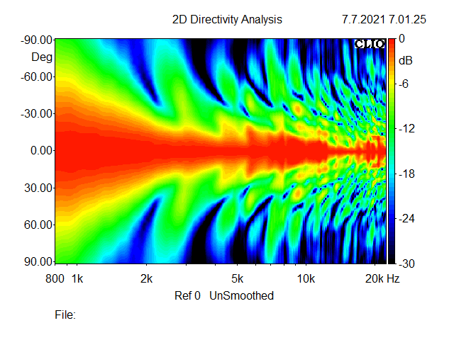

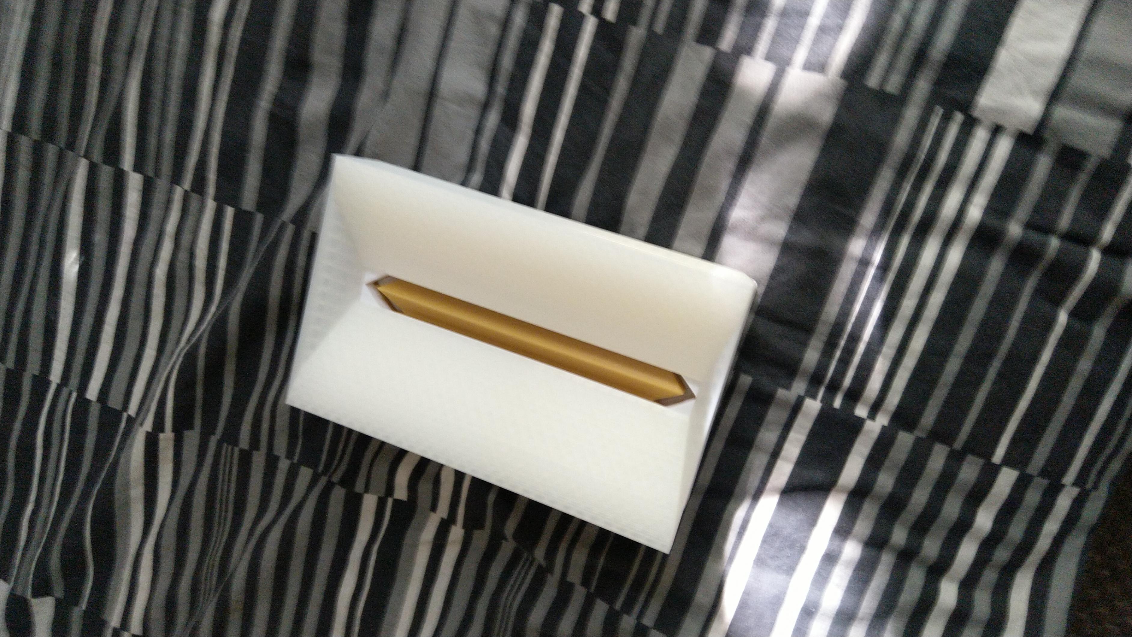

After years of iffing I finally built a "Paraline".
-The curve used is hyperbolic. Target angle 20 degrees vertical.
-Measurements at (too close) 1m.
-Measurement voltage 282.8mV (10mW @ 8ohms, -20dB re 1W).
-The "horn" is just straight side walls with circular rounding. 224x140mm (HxV). *If* I´ll continue with this, the profile must be refined.
Edit: Vertical polar map.
Edit two: H and V The other way....

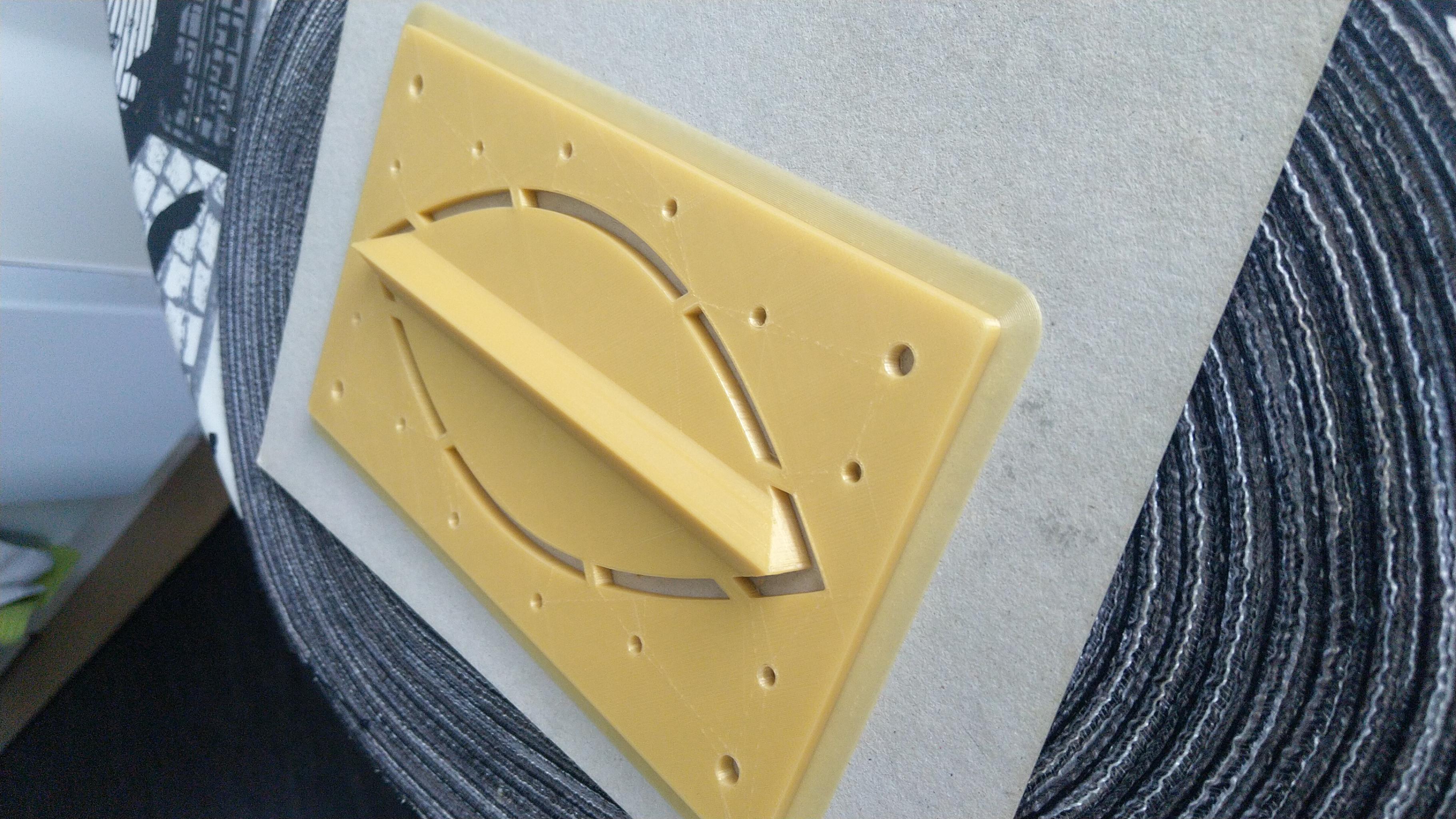

I've built a bunch of Paralines*, but I wasn't satisfied with the sound. A lot of dips in the response, and a character that was generally harsh.
I believe the problem is that the sound radiated from the diaphragm hits the bends in the Paraline and is reflected back to the throat. The reflected wave is a higher order mode. HOMs make a horn sound harsh.
So...
I wanted to use some of the same tricks that we use with waveguides to reduce higher order modes. I wanted to use gentle curves to reduce reflections back into the throat.
The first thing I do is draw that familiar 'eye' shape. The point of this shape is to take a spherical wavefront and flatten it into a ribbon shaped wavefront...

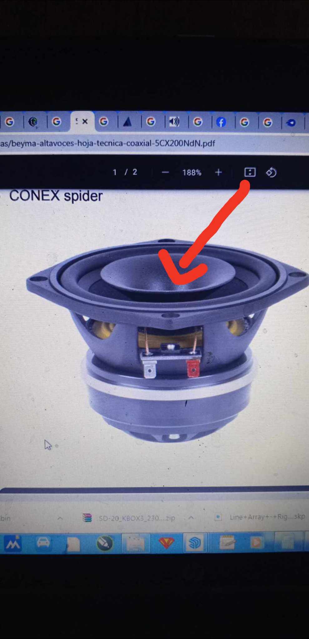

have you tried to use Coaxial driver a 5 inch Coaxial? to your paraline projects
