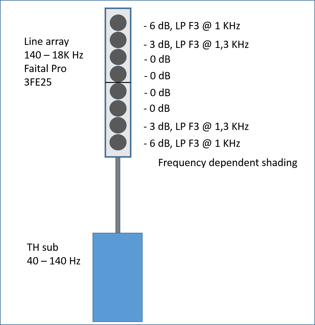

I´m planning my next project. A small music room/garage general purpose PA for jam sessions, occasional small gigs, parties and perhaps movie nights. Not really a HiFi application, but that´s no reason for accepting crappy sound.
My initial plan was a pair of TH subs with short line arrays on top, each with 9 Faital Pro 3FE25.
But after being sucked in to this thread, and reading the quoted papers, patents and other threads, i became curios about shading, especially the frequency dependent shading suggested by mr. Stiles. There are many (differing) opinions, principles and general guidelines, but no blueprint or formula. I have several questions. At what frequency should the shading begin? Should that frequency be the same in all shading groups? And what shading scheme is prefered.
I came up with a simple, preliminary design, as seen in the attached image.
The enclosure is appr. 800 mm (32.5 inch), divided in two, so that no serially connected drivers share compartment. Impedance for 3FE25 16 ohm is 13.5 ohm @1 KHz. The shading scheme is -6,-3,0,0,0,0,-3,-6 (frequency dependent, F3@ 1 & 1.3 KHz).
I would appreciate comments, and suggestions for improvement. Or should i take the easy way out and just stick with a non-shaded array?

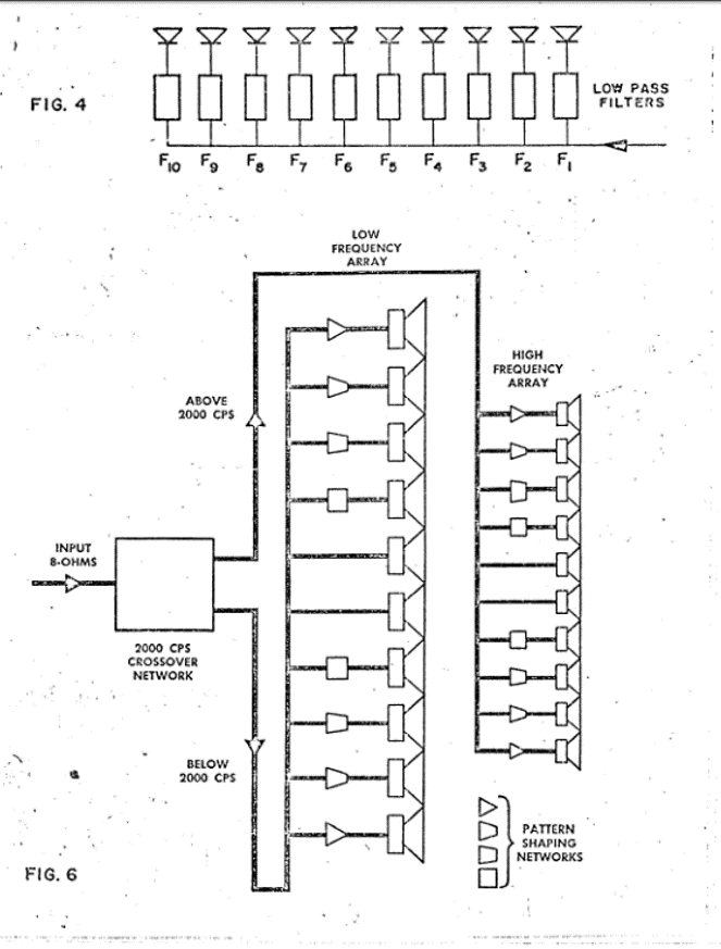

I found a paper by James Novak from 1962, where he apply these principles in the CALSTAR design. See attached wiring scheme. It is a complex design with 16 LP filters with increasing cutoff frequencies.
http://www.ee.ic.ac.uk/naylor/LineSourceLoudspeakers/novak62.pdf
I found that JBL refered to Novaks design in their CBT tech note.
http://www.jblpro.com/ProductAttachments/CBT_Tech_Note_Vol1No35_091007.pdf
But JBL use a very high crossover point (se image). The reason is explained by Patrick Bateman (http://www.diyaudio.com/forums/multi-way/280664-passive-loudspeaker-delay-2.html#post4474438). The JBL network is not a frequency dependent power shading. It is a passive delay.
Any suggestions besides Novaks 55 year old CALSTAR design?

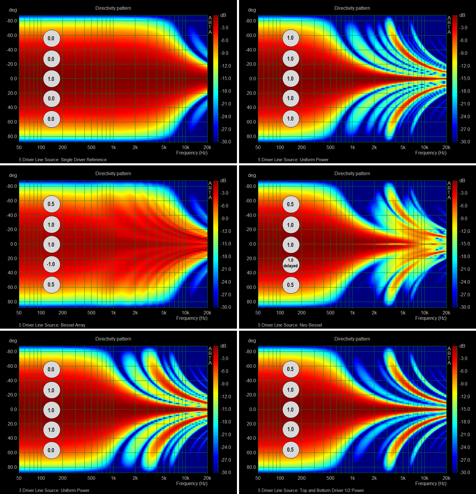

…I would prefer to see some sims of the far field.
Using 2” diameter flat pistons and 2.25” spacing, here are polar maps at 10m with 2 degree resolution.
1) Single Driver
2) 5 drivers uniformly driven
3) 5 driver Bessel array
3) 5 driver NEO Bessel array (delay = 1/2 wavelength at 8kHz)
4) 3 drivers uniformly driven
5) 5 drivers with top and bottom driver @ 1/2 output
1) Single Driver
Sims or measurements?
ARTA doesn't simulate from what I remember.
