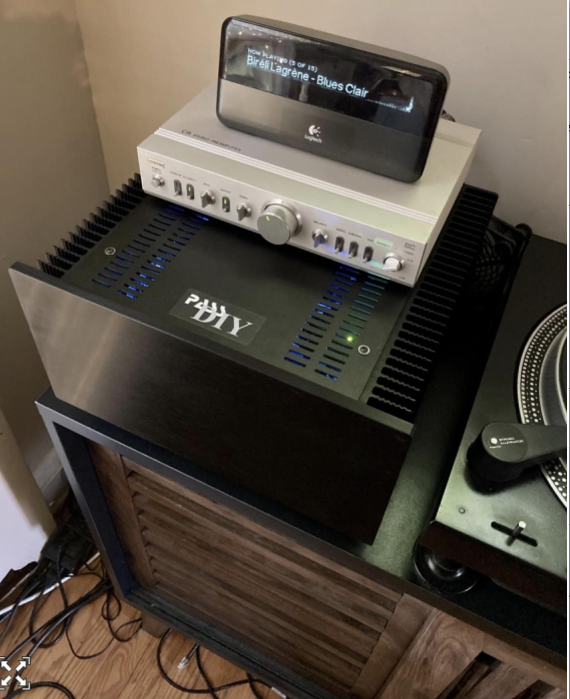

Because I had a work-related, frustrating mishap this morning, I decided to switch up the Chi in my home office (which is really my living room with my main listening gear, plus my work stuff).
I swapped out my VFET SE with my F5 and was really struck with how great the F5 is. I think it matches my Manzanita-ish speakers better. I heard some new things in familiar songs that I haven’t before.

The F5 is a fantastic amplifier. Happy listening, everyone. 😀
