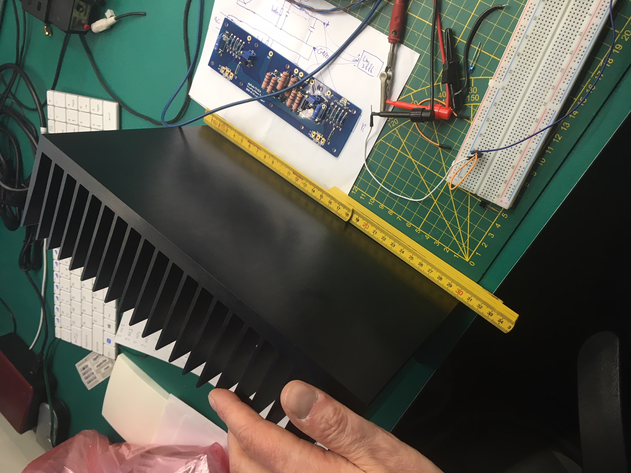

Another question, I have a big heatsink laying around that is 11,8 x 7,8 x 3,1 inch and 0,07 deg C/W. Should this be big enough to cool both channels?
if you have enough JFets , double them , using 2+2 per channel
you can even use slightly mismatched ones , as long sum of Idss of two up is close to sum of two down
that heatsink is certainly good for one channel ........... for 2 channels most probably nice lazy vent is only way

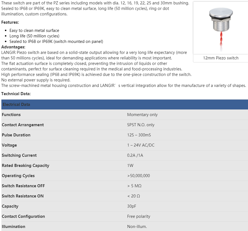

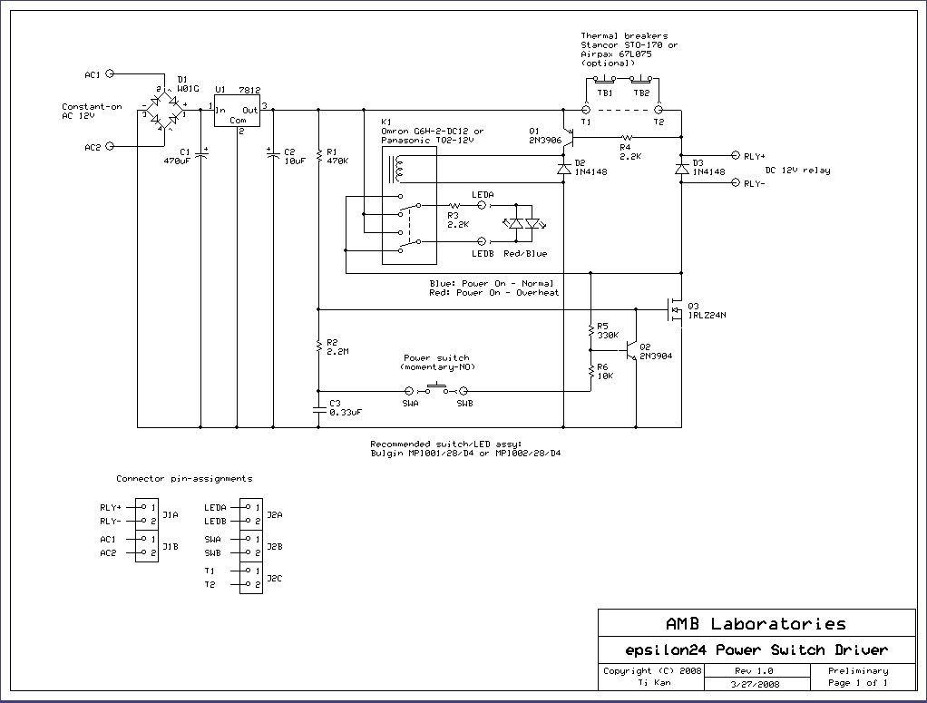

ok wasn't really sure where to ask this question but figured that someone here would be able to help me out. I am building the F-5 and liked the look of the Langir 12mm piezo switch to use as an on/off switch. Its a NO momentary contact type (specs attached). I also have the softstart board and I figured I would use a relay controlled by the Langir piezo switch to allow mains power to flow to the softstart board. For the relay circuit, I built out the AMB epsilon 24 power switch circuit (attached) which seems to work great until you put a piezo switch in the mix. Turns out AMB does not recommend piezos or capacitance type switches with the epsilon 24. I did purchase a different relay board on ebay and the piezo worked fine with that - i suspect because there was more voltage at the switch. But I really wanted to get the epsilon 24 to work with a piezo switch - so I thought - putting a capacitor in series with the piezo might allow the capacitor to build enough charge to overcome the resistance in the piezo switch itself and turn the board on. I used what I had laying around - a 22 micro farad electrolytic. And it worked but not reliably - so I figured add another capacitor in parallel - I got maybe a little improvement - but not so I could use it. On a whim I put that second capacitor in series with the first capacitor and got noticeable improvement. Then I added a third capacitor and the switch controls the circuit pretty much the way it should. see for yourself YouTube
My problem is that I do not know why this worked and I was hoping someone here with a lot more knowledge than me could help me understand what is going on. Also if you have any thoughts about how I could change out a component(s) on the board (maybe R2) to increase voltage at the switch - maybe I could get rid of the capacitors altogether? I know this is a big ask but I really am trying to learn as I go along.
