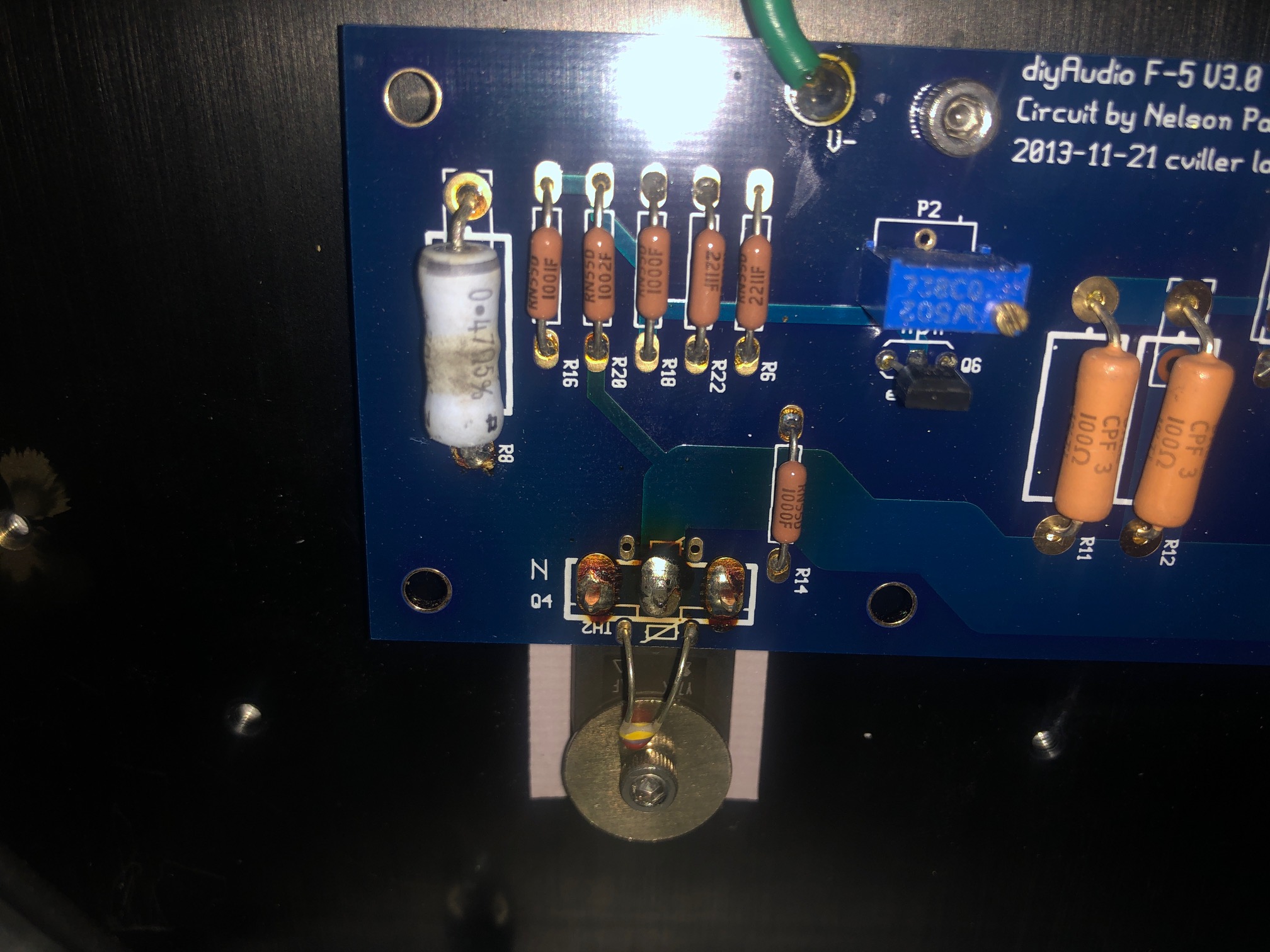

I successfully fried one channel of my amp !
Series of events:
1. Amplifier had been left on for a few days.
2. Turns on preamp
3. Heard a quite pop in speakers and no noise from source when turned it on.
4. Pull out amp, checked the fuse, fuse was blown.
5. Replaced fuse, turned amp back on and it went BZZZZZZZZZ, sparked a bit inside at the terminal strip, at the live in and CL-60, then blew the fuse.
6. Said Oh Sh@@@@
7. Plugged in bulb limiter, replaced fuse and the bulb lit up like it was gonna explode
8. Unplugged left and right channel from PSU, tested PSU - good
9. Tested right channel fine, no short and audio worked.
10. Tested left channel - build lights up hot so there is something wrong
11. Look at left channel and it's FRIED.
Here is a picture.
Not sure what happened but the good news is that DIY store has all the parts I need.
I have some Toshiba FETS and my one working channel are from LS so it's probably best to redo both channels so they are all matched?

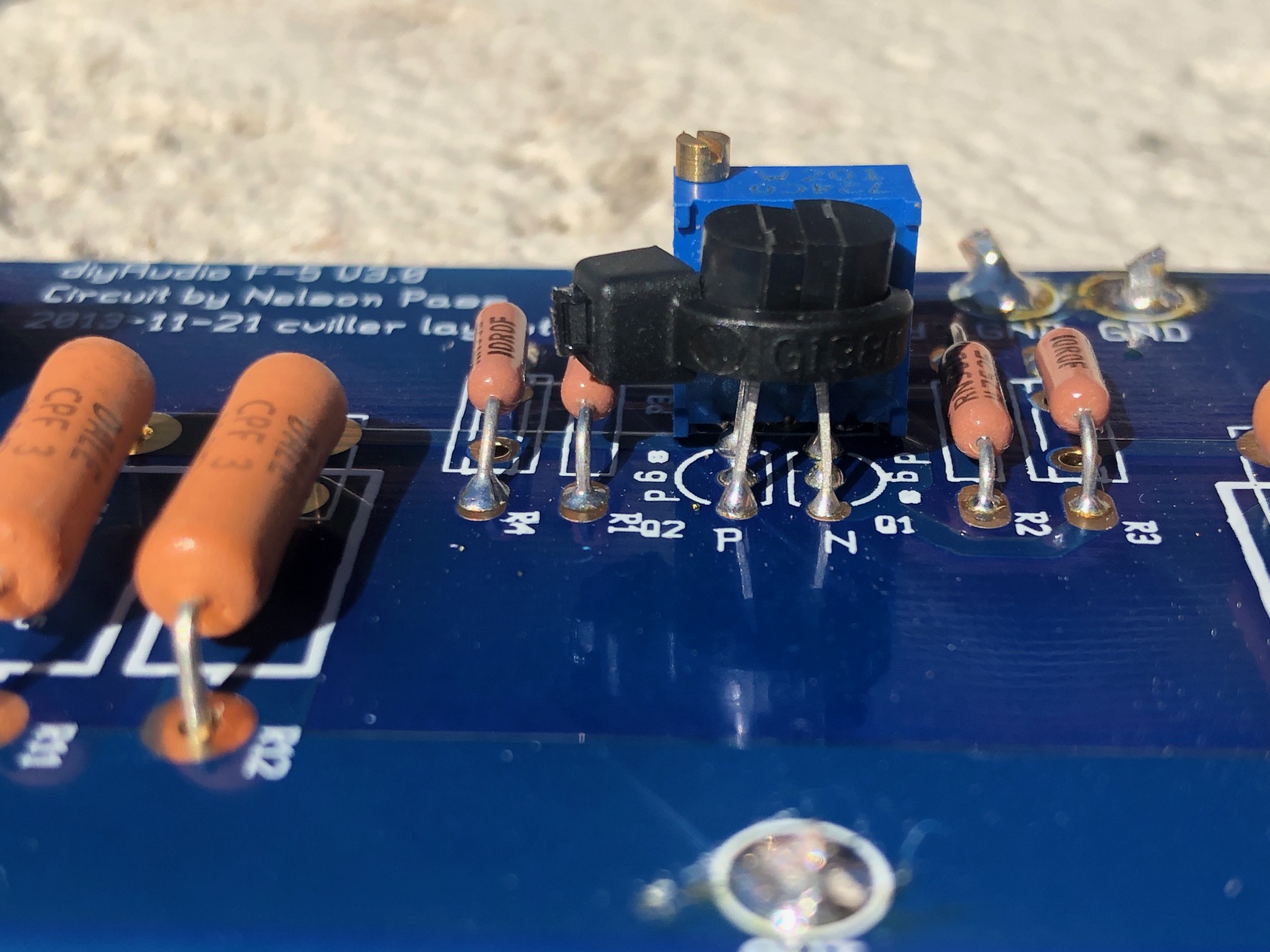

I'm finally getting around to fixing my F5. It's one of those things where I wasn't too mad something went wrong because now I get to build a new one :)
One board is just fine so the JFETs I know are ok. Should I assume the JFETs on the fried board are no good?
Visually they look good while other components are clearly fried. I already acquired replacement JFETs but it would be nice to save these if they are still good.

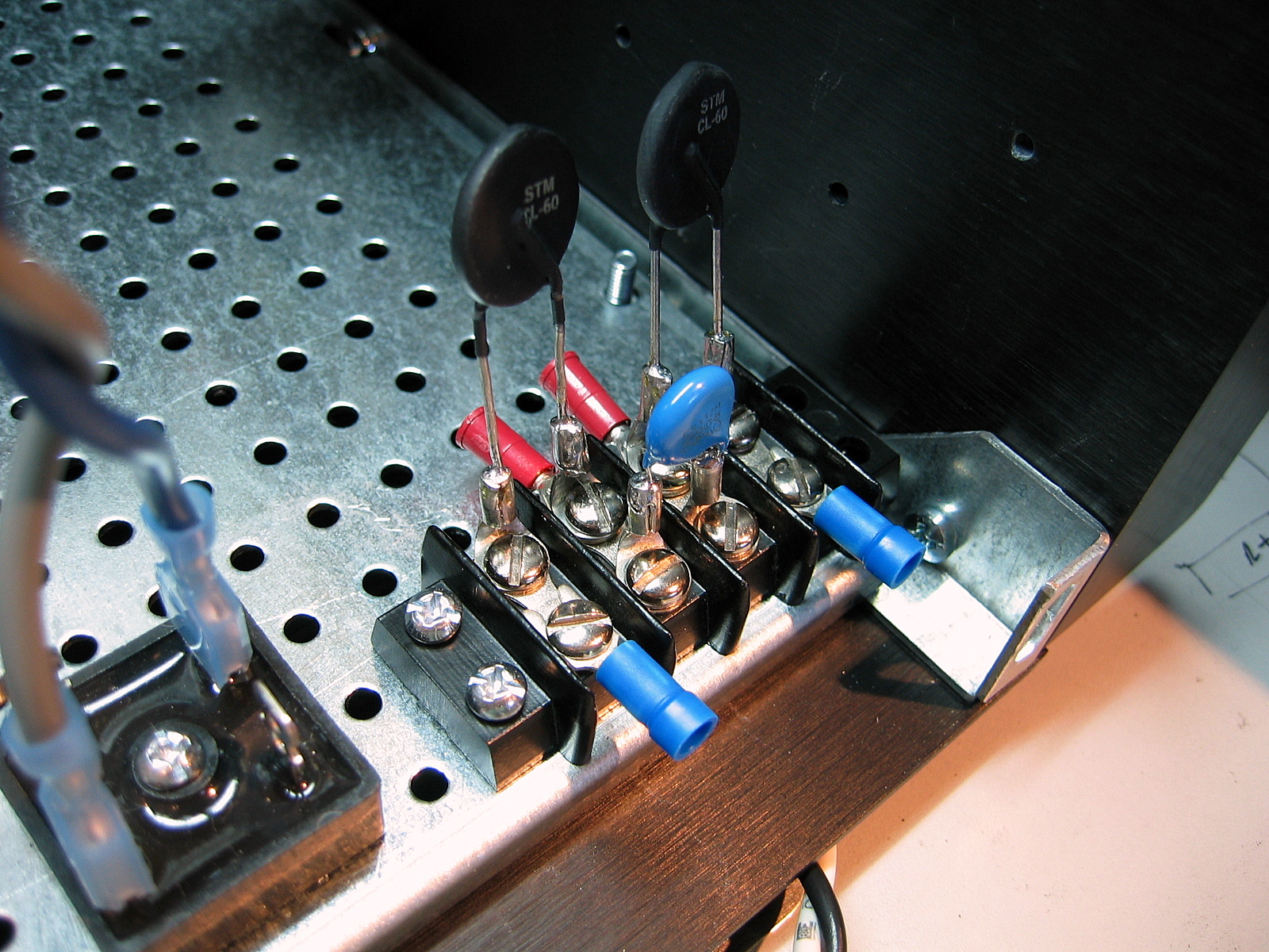

You should never solder a wire then put it under a screw.The solder relaxes after a period of time and you get a loose joint.
Here is a mockup of a barrier strip I used for one of my amps. I couldn't get a trustworthy airtight crimp on the thin leads, so I soldered the connection after crimping. In subsequent amps I used a different type of connector and also insulating "marking strips" under the barrier strip. I suppose some flame-resistant material on the exposed CL60 leads is also good practice. These critical PS connections need to be high-reliability, which is not something always achieved by screw-down on stranded wire.
BK
BK
You also need a quality crimping tool, I got intermittent connections using a cheap consumer one. I changed over to soldering wherever possible.
Joined 2003
Those are what I used on my CL-60's with a barrier strip,worked excellent.
Do you guys just crush these things on? I cant get comfy with that. I grab the ring with an old pair of large needle nose pliers, stick the plastic end in flame until it begins to catch fire and scrap the plastic off. crush it to wire and solder. Then cover with heat shrink.
