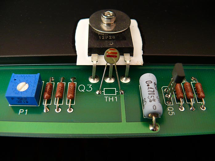

I have already the Bourns 3286 staggered version with 1 turn (=3/4 turn?) fitted to the pcb. Not soldered yet.
Is there something wrong with using a single turn trimpot instead of a multiturn trimpot, as long as the pins fit the pcb?

Yes, you have tried to fit the wrong type of trim pot !
I can fit the Bourns 3286 staggered version, but they will be reversed with pin 1 where pin 3 should be. My question was if this was fine as long as I turned them in the other direction.
The attached picture shows a factory F5 using something similar, but I can only make out XX86 in the number. Hopefully it is the Bourns 3286 that I have.
Why are single turn trimpots wrong, but multiturn trimpots right? I have checked how a usual trimpot works and it looks like it could work to reverse pin 1 and 3. Unless multiturn trimpots are much different.
they aren't wrong
whatever you use - single turn or multiturn - you need to take one with proper pinout - single in line or "triangled"
they aren't wrong
Hypothetically, if I used a 3296 single in line, multi-turn (just to be safe) - would I be able to change it to counterclockwise if I felt like it, by fitting pin 1 where pin 3 should go and pin 3 in where pin 1 should go?
Would that be "improper"?
If not, and single-turn is fine, then I am good with my Bourns 3286 single turn, triangle pattern pinout.

no prob
I wouldn't use a single turn trimpot because it won't give you a fine enough adjustment when you bias.
Those trimpots will vary with heat and a single turn trimpot will vary way too much with even an degree or so of twist. You will be in danger of blowing up your amp with just a flick of your finger.
it depends ......... of ratio of one's mileage/hysteria
FW amps are equipped with single turn trimpots .......
Exactly why I got them, ZM. But good point, Dazed2, I will not dial the trimpot while sneezing.
