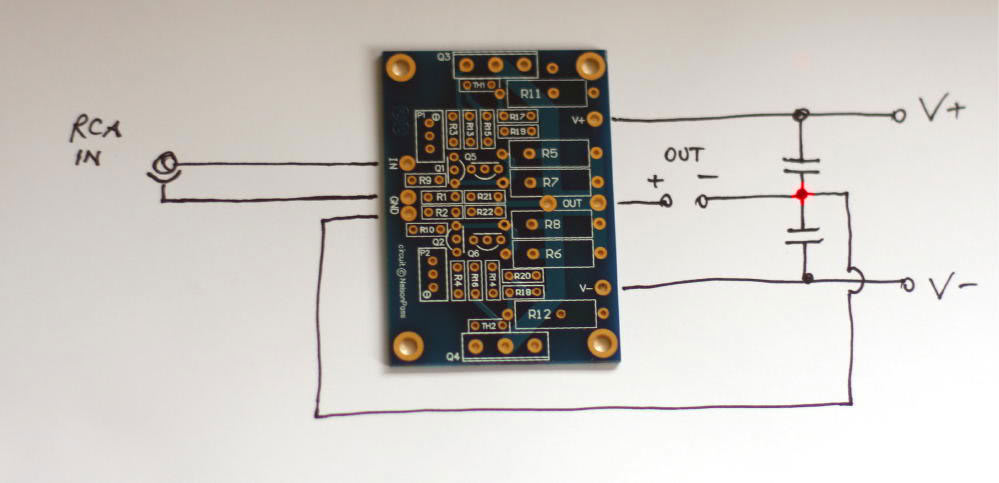

I don't know if there is anyone around. Have yet to fire up Peter Daniels F5 boards. Boards stuffed long ago. I'm trying to set trimmer pots to min. Turning them has no effect that i can see. Tried measuring across R5 and R6. No change. Having 4 trimmers behaving identically (2 per board, two boards) leads me to measurement error. If the boards were built following instructions, i.e. pots installed predictably, is counter-clockwise minimum? Thoughts?
Pots installed according to silk screen on board. How much change should I expect to see across R5 and R6 when turning the adj. screw? Attachment placed only because it has picture of unstuffed board showing silk screen. Thanks for the help!!
