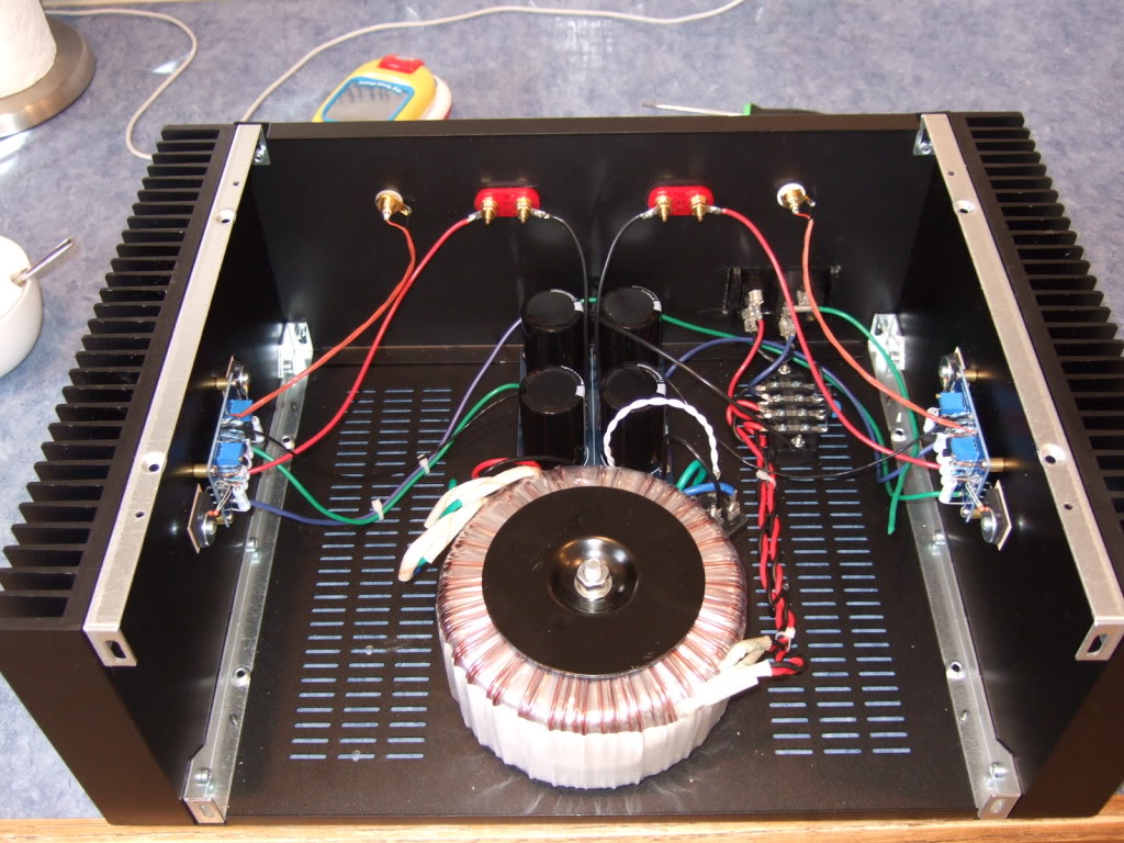

6L6,
Thanks for posting so many detailed pictures.
I'm not sure where the location for the audio star ground should be.
Looking at the photos of the F5, it seems the location for the star ground is on the electrolytic cap board.
This makes sense, because it allows a short ground wire from the electrolytic caps to the binding post.
But it would also mean a low current audio ground wire would need to go to the amp.
However, I've read its an audio star ground - so the star ground location should be on the amplifier board.
However, that would mean dragging a large gauge ground wire from the electrolytic caps to the amplifier board first
and then it would go off to the binding post.
The theory of the star ground location being on the amplifier board makes sense - in theory.
However, practically - a short wire from the electrolytic caps to the binding post seems better.
Please advise.

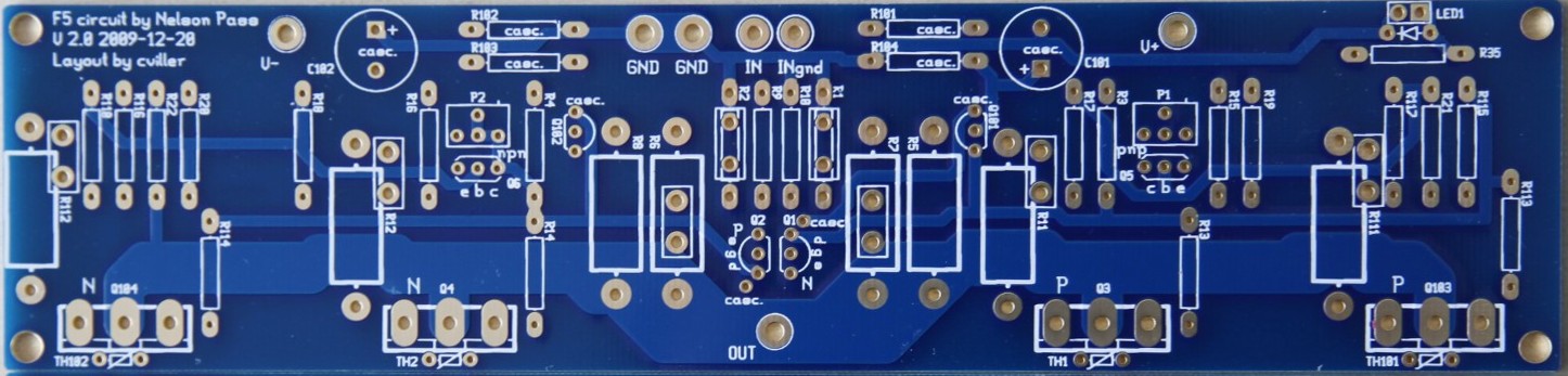

Do you mean as on cvillers pcb's Andrew where all grounds are connected with a single ground wire going to the p/s centre.
http://www.diyaudio.com/forums/blog...390-gb-f5-guide-pcb-version-2-f5_v2_front.jpg

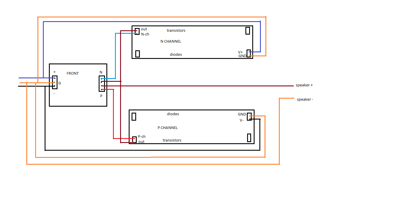

hi,🙂

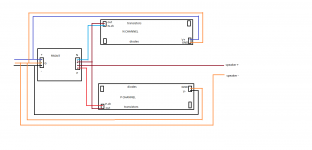

Would this diagram help you out? I know it different but it does show where all wires do connect,

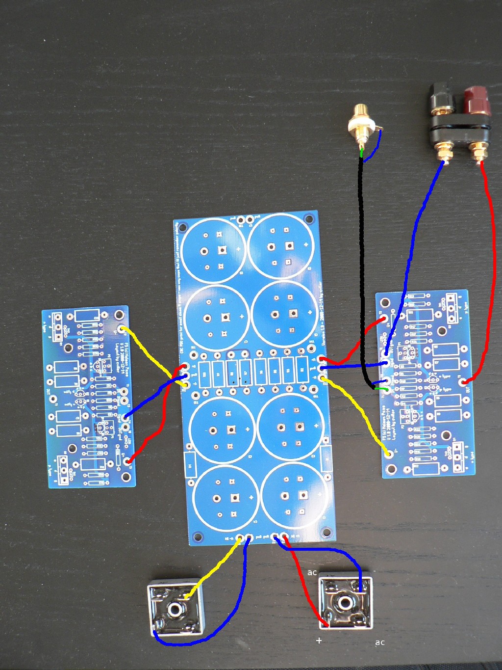

How about a picture using peter Daniel's boards and power supply board from Brian Bell (chip amp). I want to make sure I am wired right, of course my wife does not think I am.
the first one is for UKToecutter's turbo boards,external output boards.. but there is a typo there.
6L6 and NoSmoking
thanks for posting your photos - they are very helpful.
NoSmoking - On your amp, +Ve/Gnd/-Ve go to the amplifier board first
The Audio star ground node seems to be where the 3 blue wires meet (RCA shield - power supply Gnd in - speaker Gnd out)
Then from the amp board, the speaker Gnd goes off to the binding post.
So the star Gnd is on the amp board.
6L6 - on your F5, the speaker Gnd wire goes straight from the power supply board to the speaker binding post.
I think this puts the star Gnd node on the Power supply Cap board.

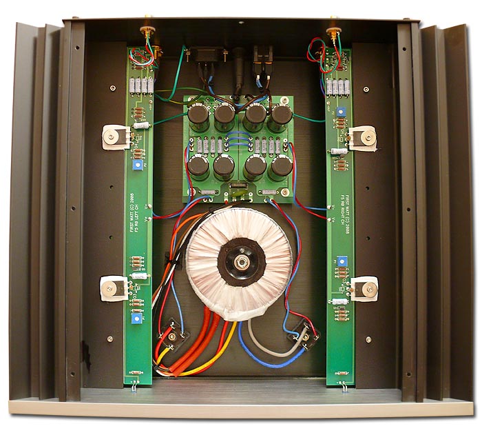

Here is a photo of Mr. Pass's F5.
Tricky to tell - but it looks like the audio star ground node is near the RCA jacks.
Also, to point out - After looking at photos of 6 different power amps - the +Ve/Gnd/-Ve DC supply lines,
going from the power supply caps to the amp, are heavily twisted.
and kept well away from any AC or rectifier ines.

Hmmm...
Is this 'wrong' ??
I dont think so, that's Peter Daniels illustration from his thread isnt it? I wired mine like this and it is dead silent.

Hmmm...
Is this 'wrong' ??
I don't know - I was hoping you guys could tell me.
It seems that the high current loops are short - which is good.
But maybe the length of speaker cable needs to be taken into consideration.
In RF circuits, as the star ground potential moves up and down
all the stages connected to that node move up and down together.
However, in audio circuits it seems that star grounding is performed to stop
the creation of current loops which could create 60Hz hum.
It seems that when a L and R channel are placed in the same case,
a loop can be formed by the L and R interconnects, the amp and CD player.
So maybe both the L and R channel need to be taken into consideration when thinking about star grounding.
It seems most amps I've looked at, are wired like NoSmoking has shown.
