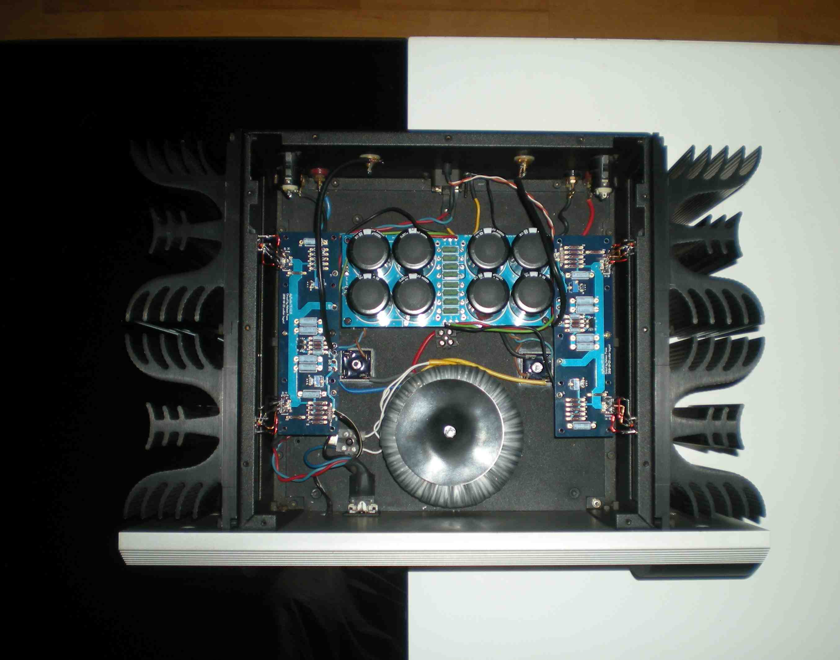

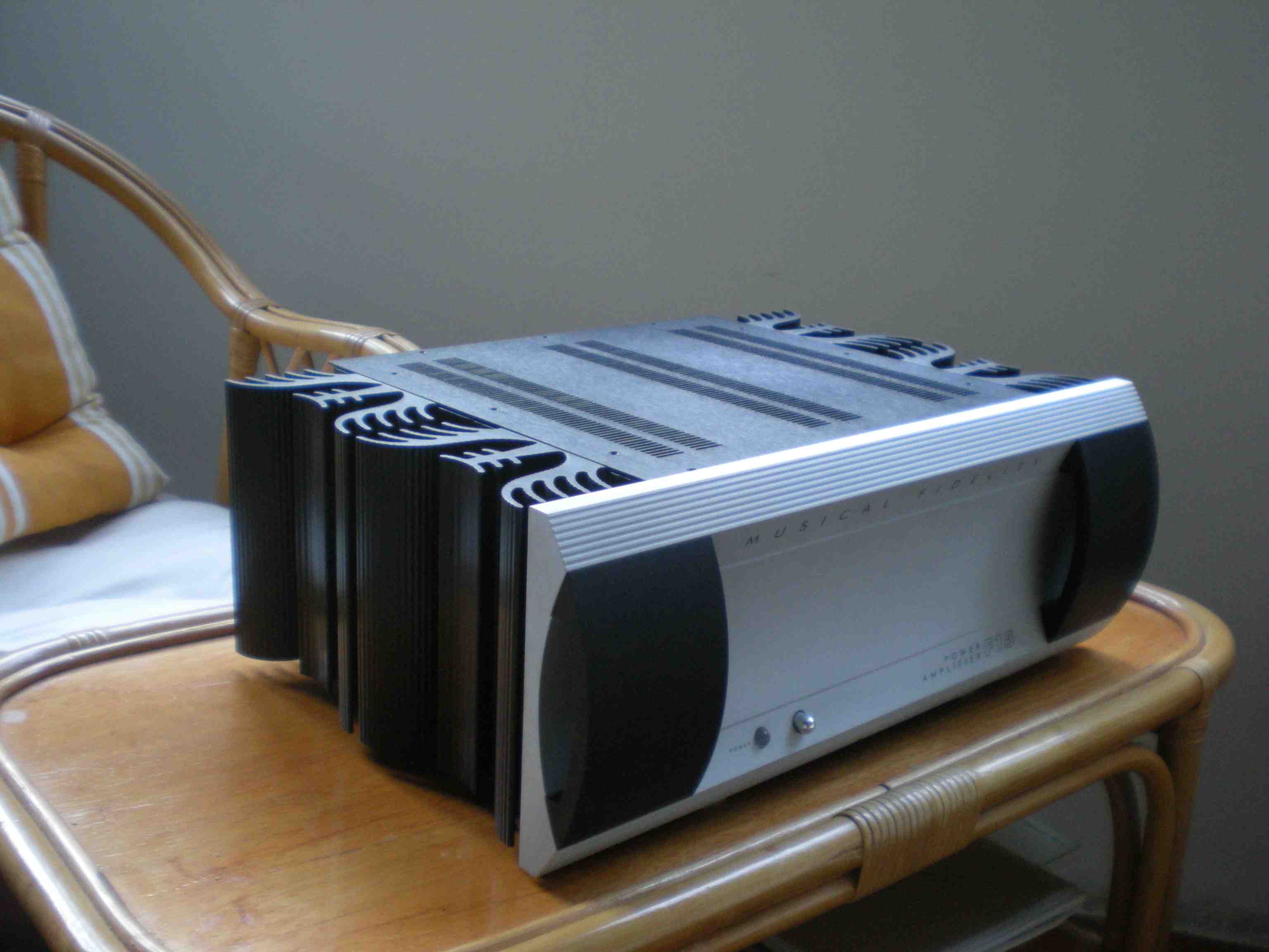

Another F5 built. Isn't it getting boring?
First of all, a little prayer for F15 who lost its life given birth to her first child - named F5 in her honor. Amen.
Biasing the mosfets was easy although those trimpots have too many turns for my liking. So far no DC on speaker's terminals. Heatsinks are doing a great job - no excessive heat. Hmmmm...what else.....oh, it sounds great ( almost forgot 😀).
Thanks to Nelson and to all those who helped me.
* The story about the bleeders was a little boring... anyway with no bleeders resistors installed the leakage paths suck the juice out of the caps in ~ 30 seconds. Big deal.
The pics. The plastic connector will be removed later on.

Cassiel..... nice looking amp--but aren't the heatsinks, front panel, enclosure (and it's design) all from the Musical Fidelity amp, that came out in the mid-1990's? In any case, nice job in "repackaging".
Did the F15 Class A die on you? If I recall, they used to retail for about $2,700 (US)....

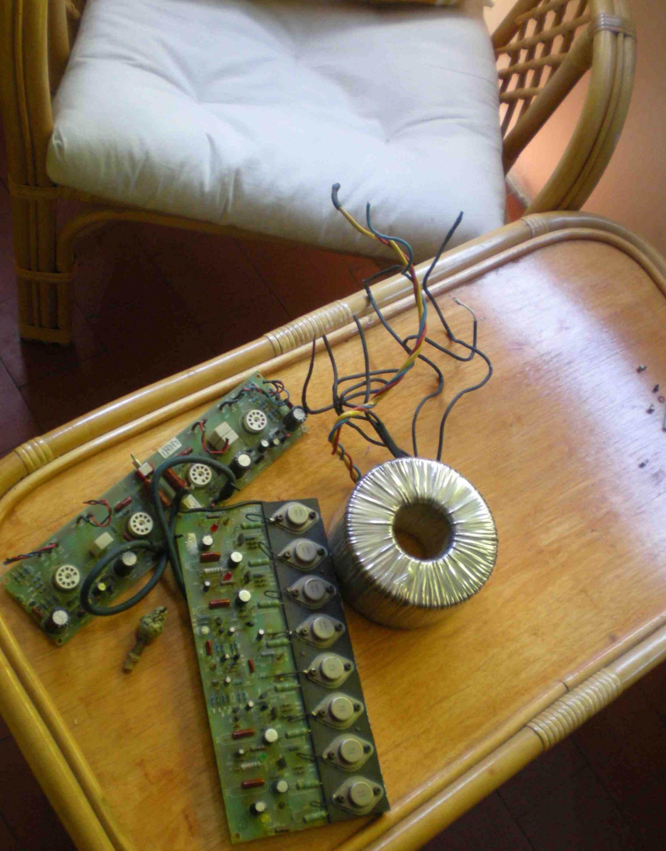

No, it was in good working conditions. It's a funny story... initially I was going to do a recapping job that turn out to be too complicated. I had to remove almost everything to access the bloody caps so I thought, hey why not build a new one? 😀
OK, the chassis is a bit expensive 🙂D) but the DIY F5 is cheap sooo... and the F15 was getting too old. I'm happy, a new amp and much better sounding. Hehe. Best of both worlds. A great looking chassis with a great circuit inside.
