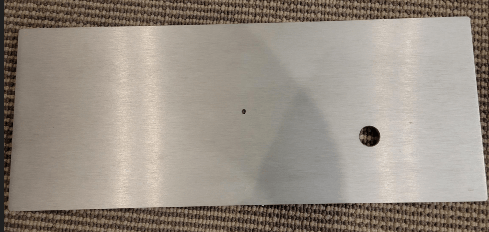

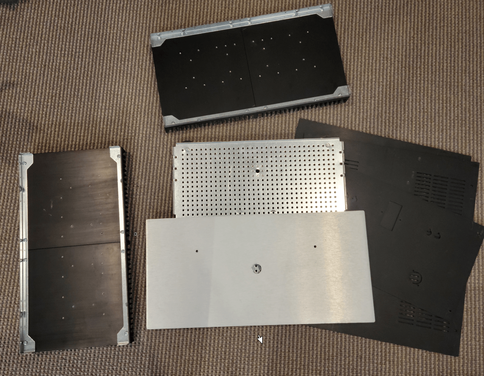

Within what time frame would the recipient have to complete a project before he surrenders the chassis?Make sure whoever get the chassis actually builds something in it….
I mean for some of us that's measured in months, if not years.
Give me 100 bucks of tickets and that's a sealed deal. If I win I will auction/raffle again. For charity of course and there's many that can use it. (I can't have the chassis as much as I would love to, I'm too far away), But now I have started its only a small repayment for many years of enjoyment from this site. Many Thanks. Of course, should there be such a tombola.
Aha! This is wonderful!Taking a stab at a dual mono M2x with the chasis! I just had a baby and was halfway through the project and trying to diy my own chassis.
This will be a HUGE help! In me getting it done quicker.
You’ll LOVE M2!
