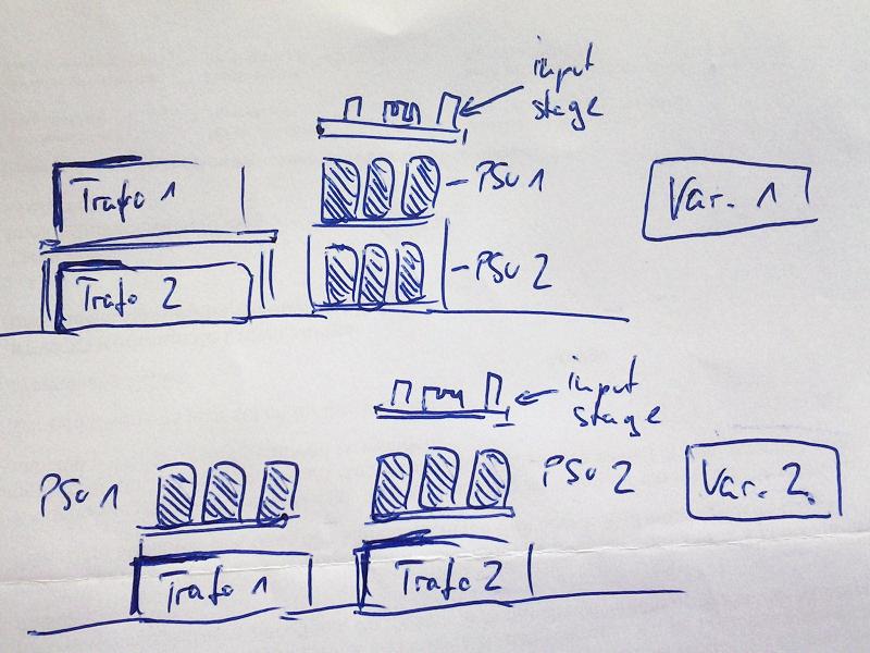

Hello
After solving hum problem at my aleph J i going to plan my next project
a Aleph 60.
Because of limited space in the chassis i dont get the trafos in the front of the chassis side by side
Now i have 2 options:
1. to staple the trafos in the front of the amp
with stapled psu in the rear part
2. trafos side by side from front to rear with psu on top
-in both cases the input is on top in the rear part of the amp
-the picture should be a view from the side
I dont want pick up hum from the trafos in the input stage,
which one would be the better solution?
thanks for suggestion

I would pick option 1 with two trafos stack on a top. However, I've seen many people do PSU right above the transformer.
Thanks, i also think first variant will be the preverred.
I`ve seen var. 2 at a f5 turbo somewhere, it seems working also.
But i really dont trust that the trannys will not stray into input stage.
I`ve heard that in the middleaxis of a tranny the magnetic field will be strongest.
And this will be in var.2 with the PSU between direct under the input stage.
